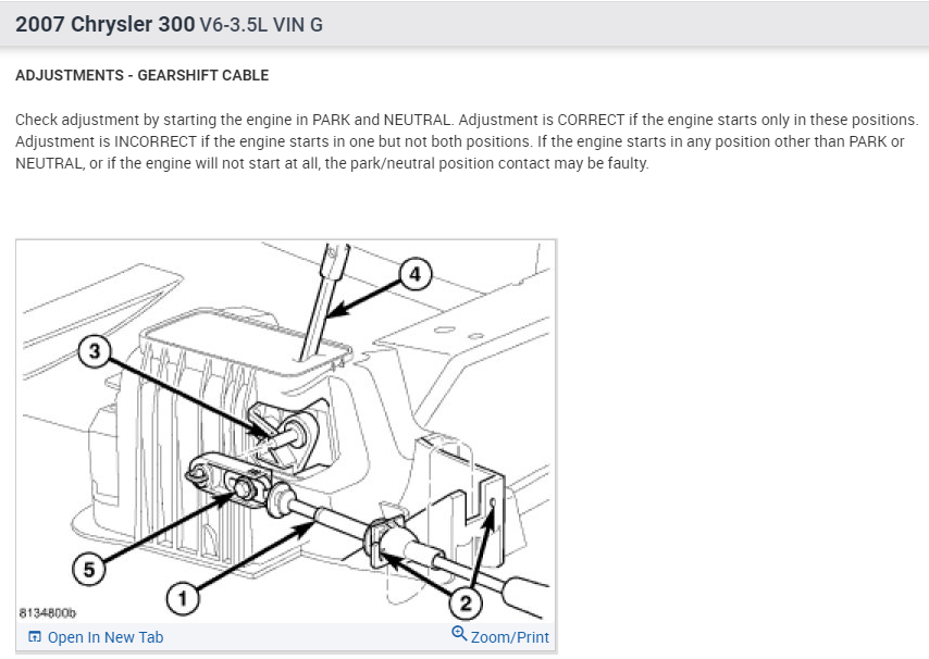

The transmission won't cause this. Funny question. Does the gear indicator function correctly when in the selected gear? For example, if you place the transmission in neutral, does it show neutral?

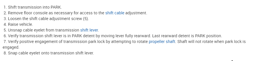

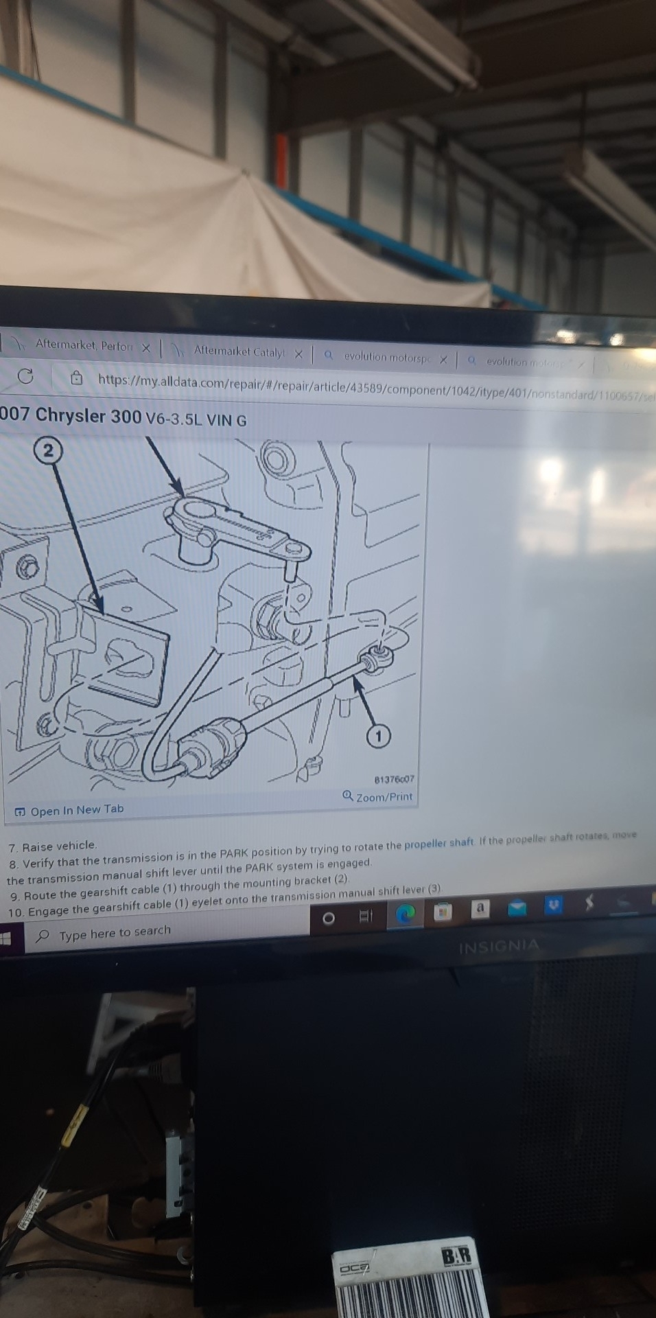

If not, let's try adjusting the cable. Take a look through the directions below and let me know if you are comfortable performing them.
See pics below.

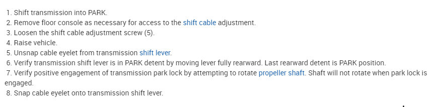

As for these diagrams, I think the difficulty I'm having is with a lot of the vocabulary. I'm assuming by the context of the instructions that the gear eyelet on the "transmission shift lever" is referring to the connection between the cable and the shifter. But I am not sure what the propeller shaft is, or why I would have to raise the vehicle to get to that part, so I'm also assuming it's under the car.

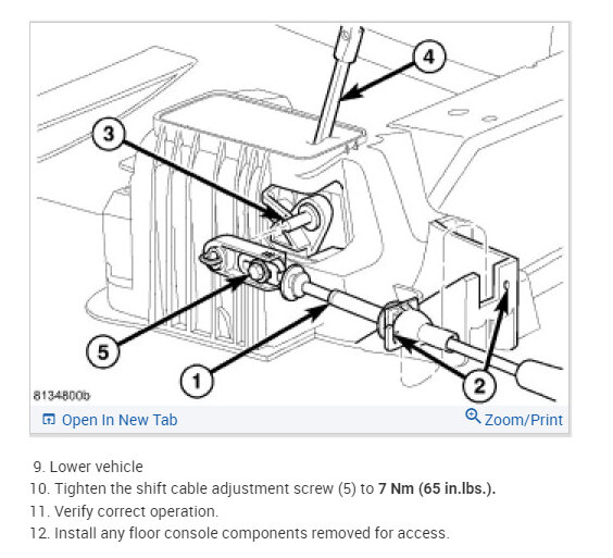

Finally, when it comes to tightening the adjustment screw on the shift cable to 7Nm, I'm not sure how to do that accurately, but I'll do some research.

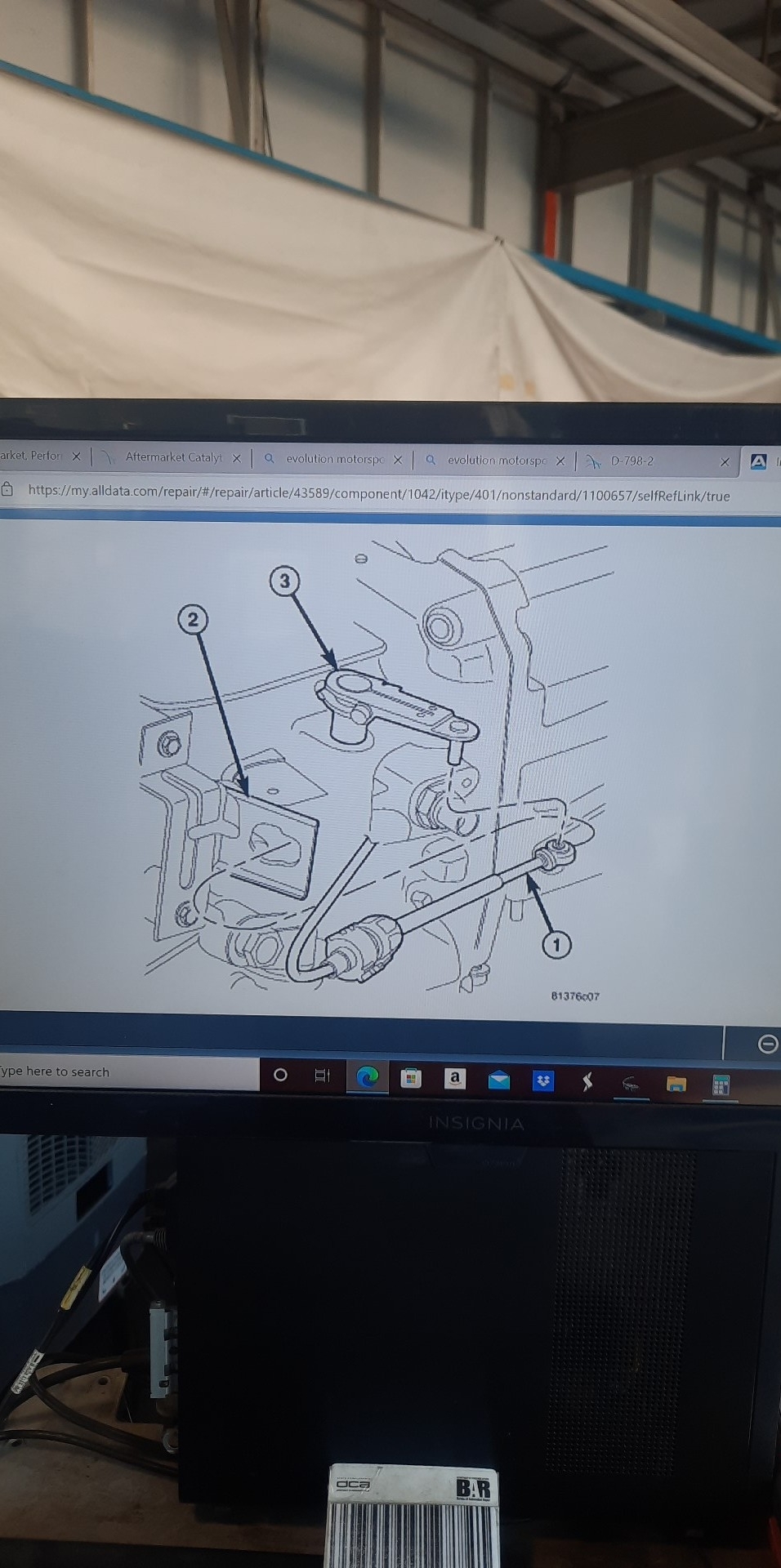

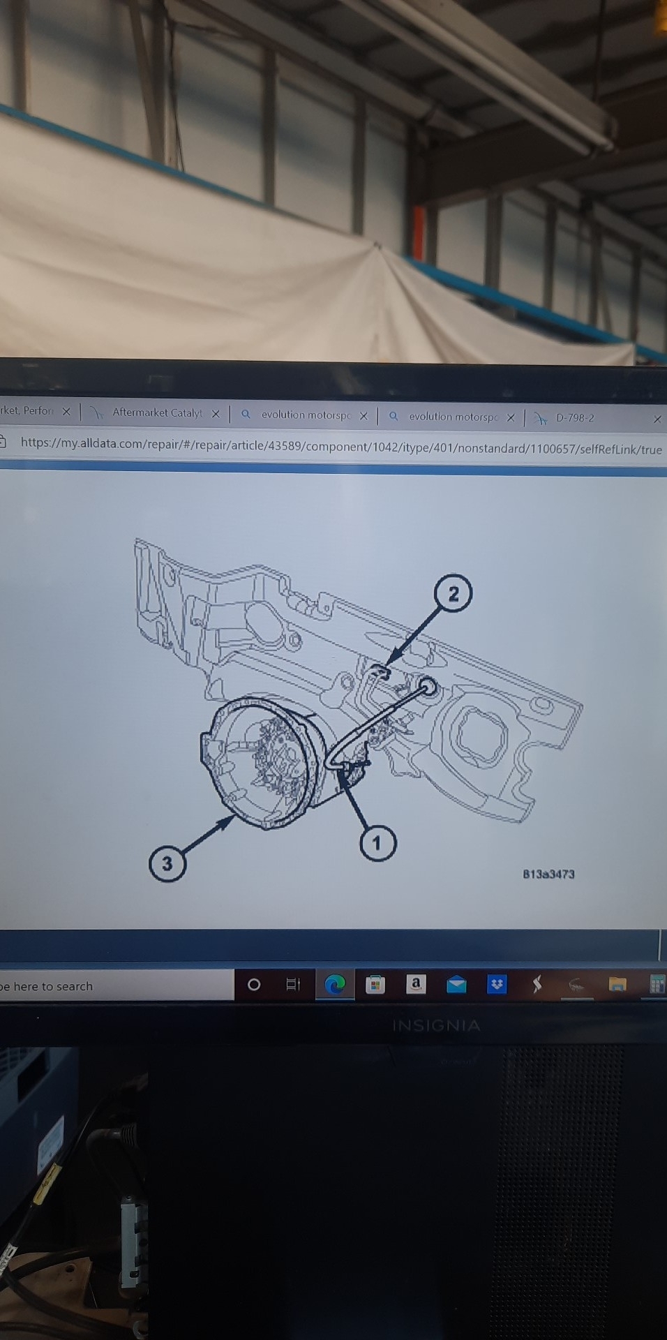

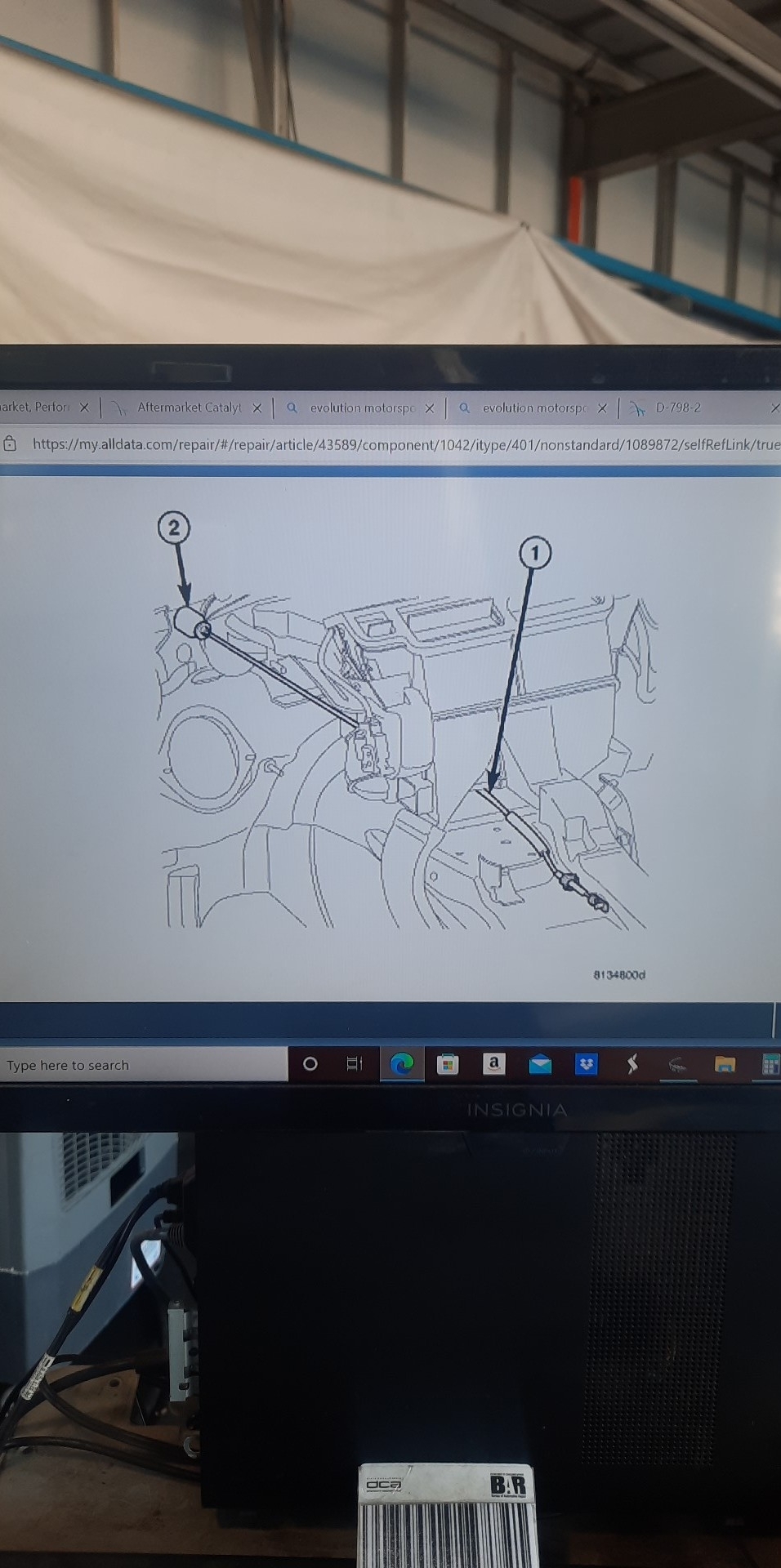

Below are some diagrams and instructions that my mom sent me from her shop computer that I was also confused with. These might be more so for replacing the cable rather than adjusting it.

The eyelet you mentioned is where the linkage attaches. As far as 7 Nm, that is how tight to make the bolt. 7 Nm is equal to 61-inch pounds. You will use a torque wrench to perform this.
Does that help?
