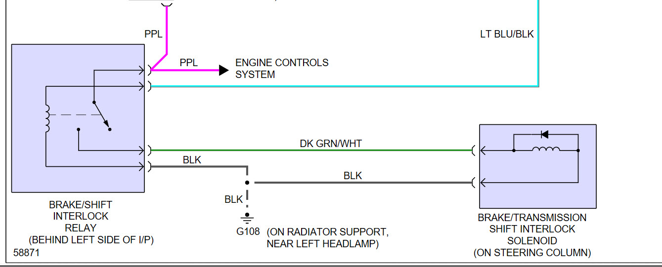

the shift interlock solenoid is below steering column mounting bracket so wheel does not need to be removed. there is also a relay that may not be working see picture.

Located and tested solenoid, tested good. Cannot located relay, schematic says Left side of I/P, what does I/P seand for. Still can not turn key, only run and start position. Kept fooling with shift lever, now in "Park" position and stays there, cannot move it to anyother position. Great information so far.Thanks
