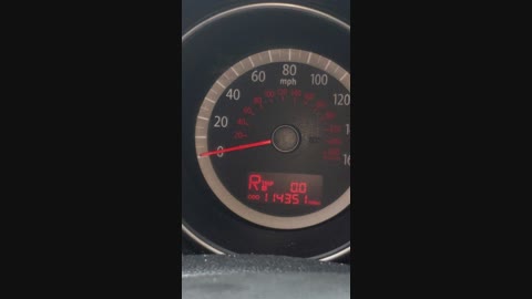

I forgot, I have a quick video of the shifter and gear indicator on the dash, to illustrate my point more clearly.

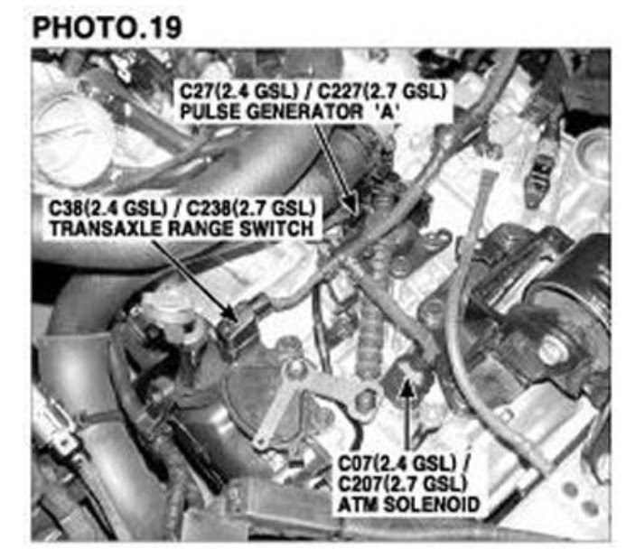

Hi Keith how fun an easy one (I hope). This usually happens when the transmission range sensor goes out and need to be replaced. Below are diagrams below so you can see what you are in for when changing the part out. Thanks for the video BTW makes my job so much easier.

Thanks Ken. It was actually rusted frozen. A little bit of WD40 and elbow grease worked to get out going. My mechanic told me to add more WD40 to it with every oil change, to keep it going.
