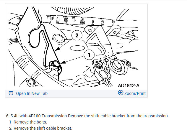

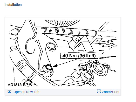

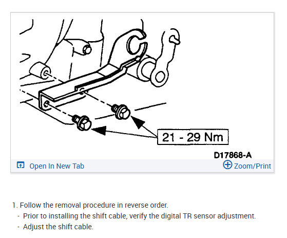

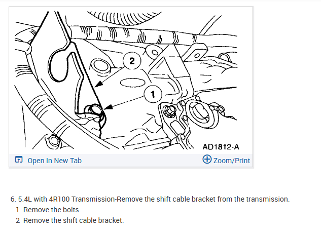

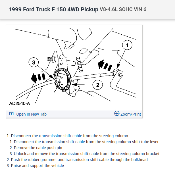

Hello guys, needing step by step instructions for removing and replacing shifter cable. Could you please also include illustrations. Your help would be greatly appreciated. Please and thank you.
May 27, 2025 at 7:54 PM

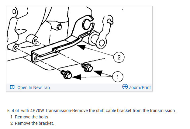

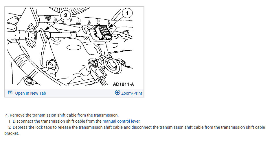

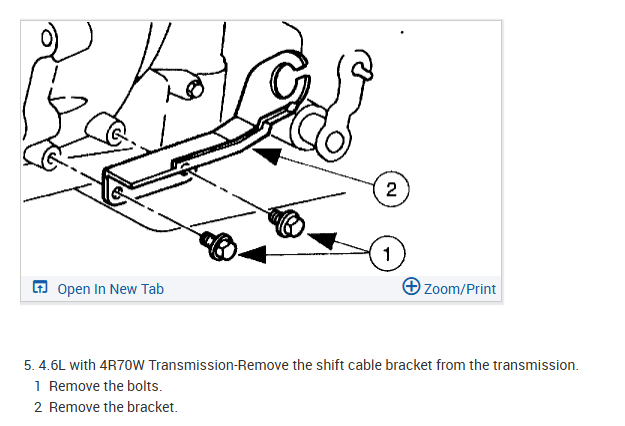

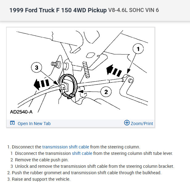

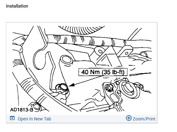

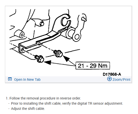

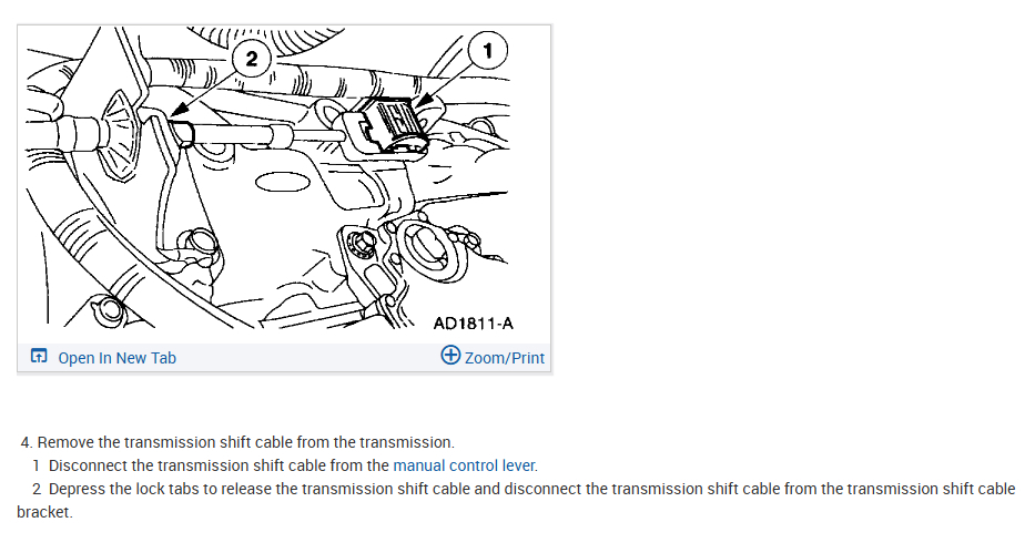

If you look below, I attached the directions and pics relevant to replacing the cable. When you do this, you may have to fight rust or corrosion, so hang in there.
Take a look through the directions and let us know if they help or if you have additional questions.
See pics below.
