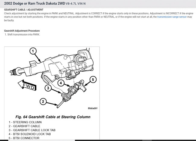

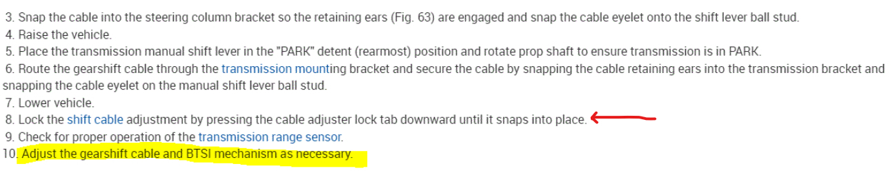

We just replaced our shifter cable with a cable we got at a “pick and pull” it is shifting gears now when it wouldn’t before, however it is only shifting some of the time, every once in a while, it will stick and we have to wiggle it around for a while before it will get unstuck. We aren’t sure if this means we got another bad cable or if we did something wrong when we reinstalled it. Can you help?
Jan 6, 2022 at 6:09 PM

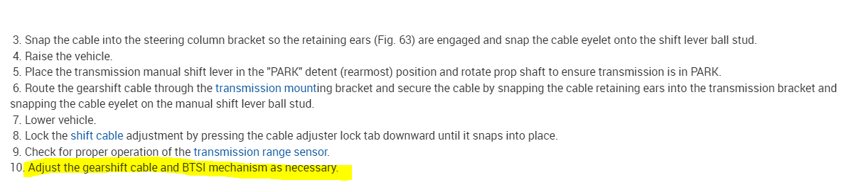

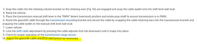

If the cable was bad, I feel you would have noticed it. It could be in need of adjustment, or something was left loose.

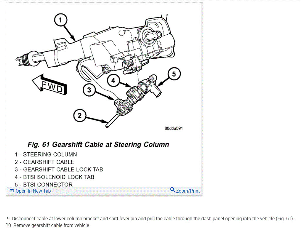

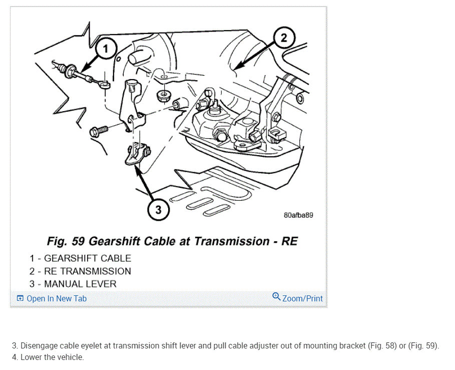

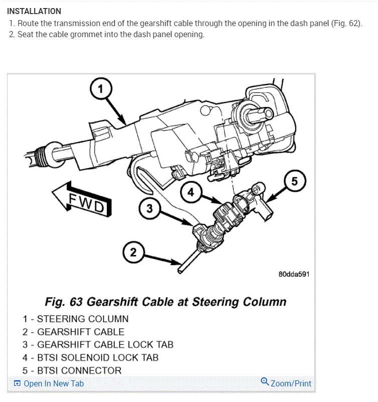

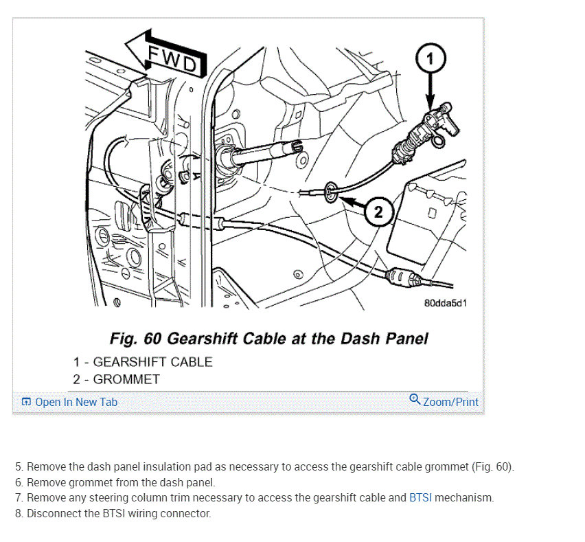

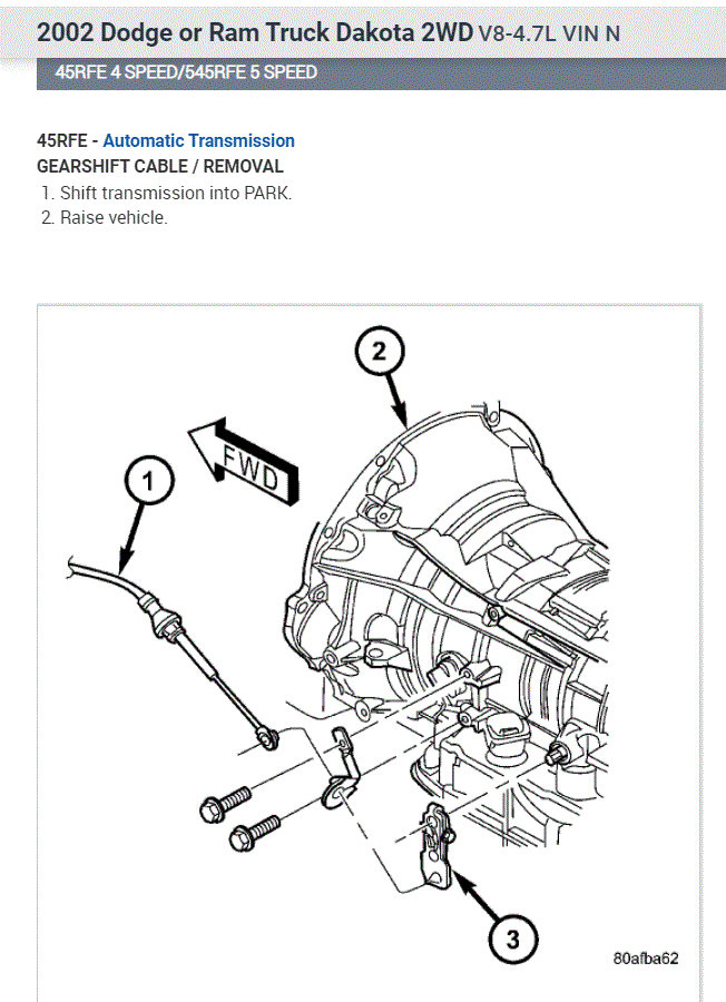

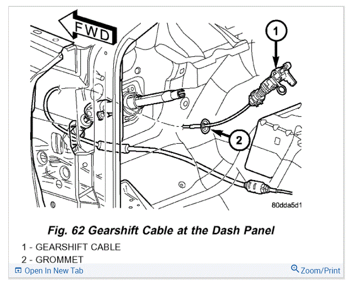

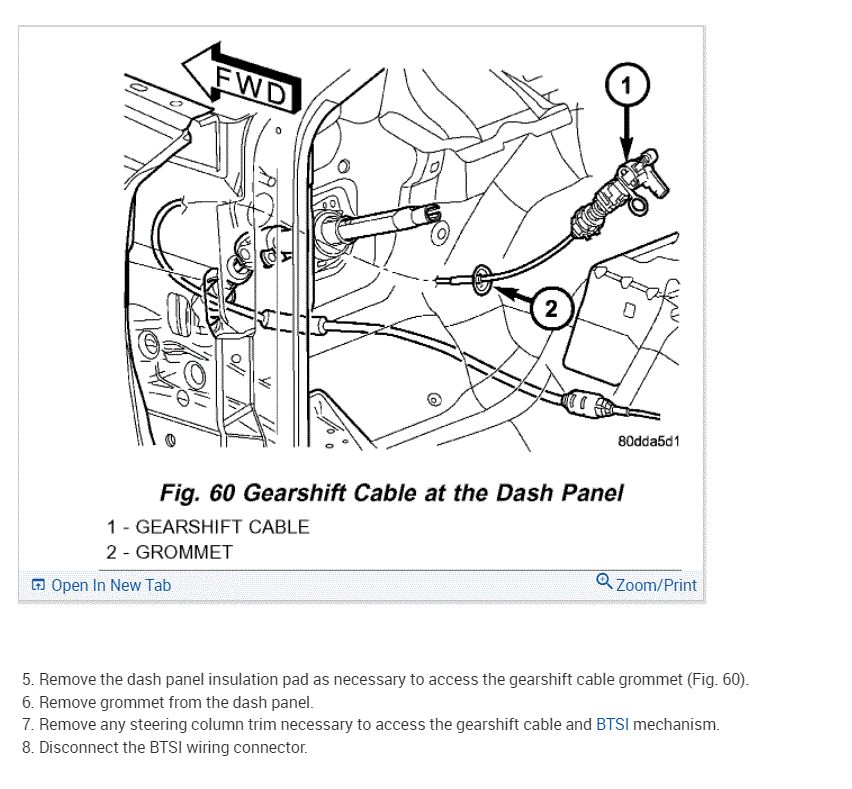

If you look at the pics below, they provide directions for removal and replacement. Take a look through them and see if there is anything you missed.

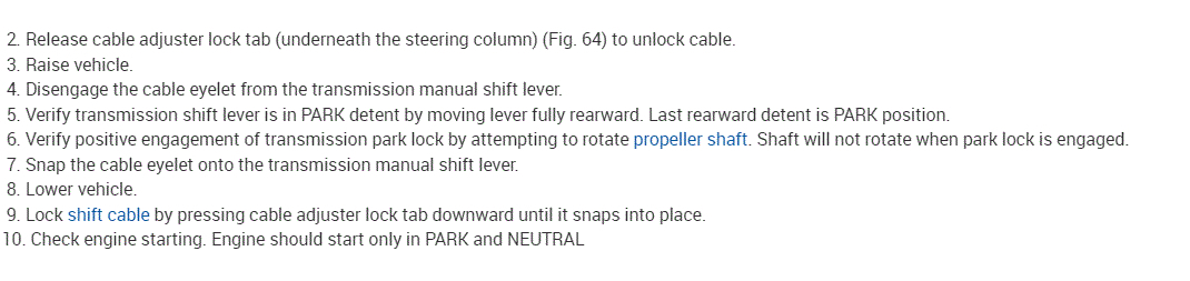

The last pic explains how to adjust it. When checking adjustment, make sure everything is tight and properly connected.
See pics below.
Jan 6, 2022 at 9:40 PM
RCROCHET
there is no adjustment caption says look at pics to see adjustment shows where to install but not how to adjust because you cant.
Jan 8, 2026 at 9:47 AM

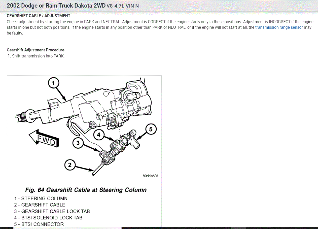

Yes, there is an adjustment tab at the top of the cable. It must be released and then snapped into place once the adjustment has been made. Check out the images (below). Let us know if you need anything else.
