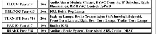

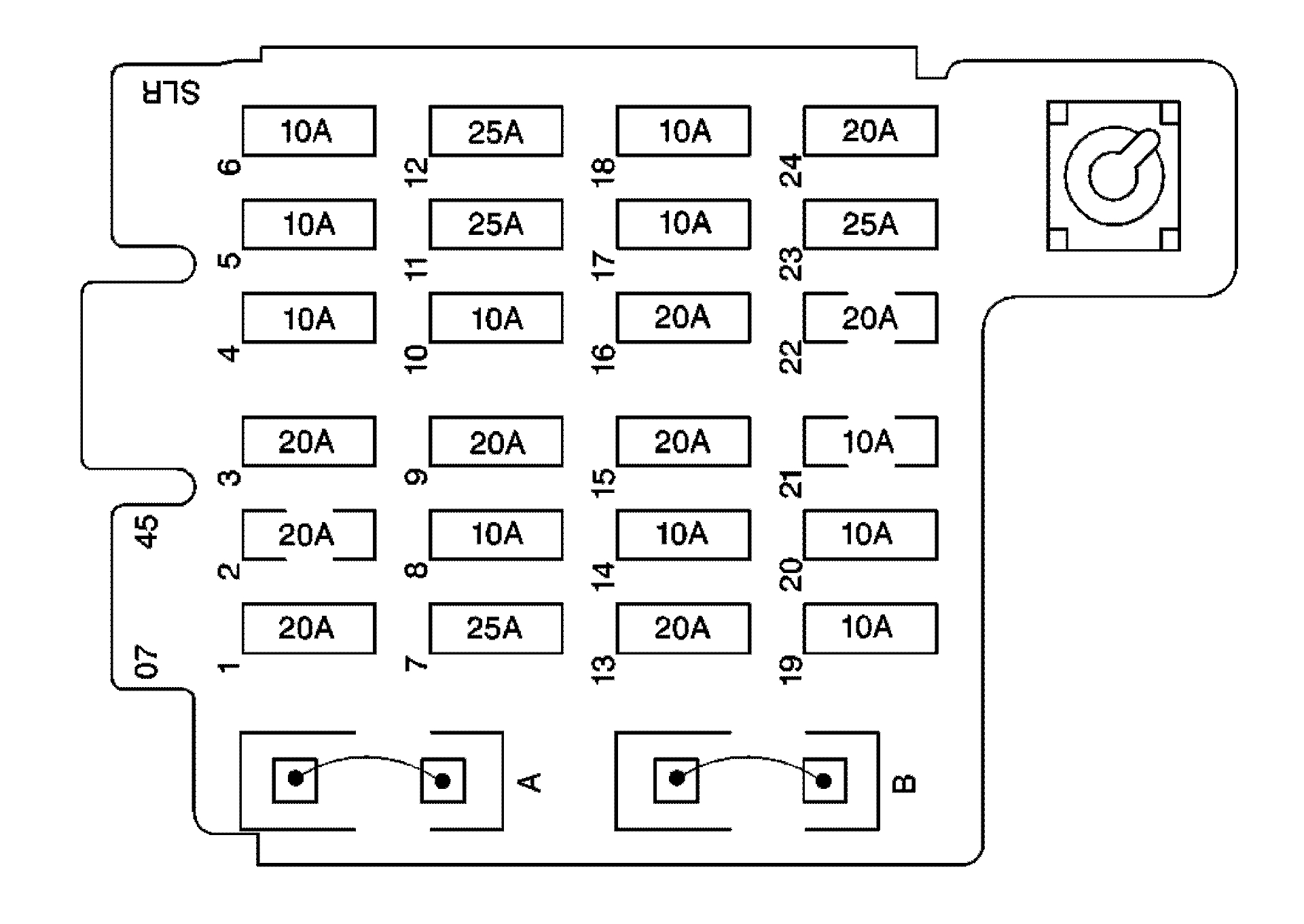

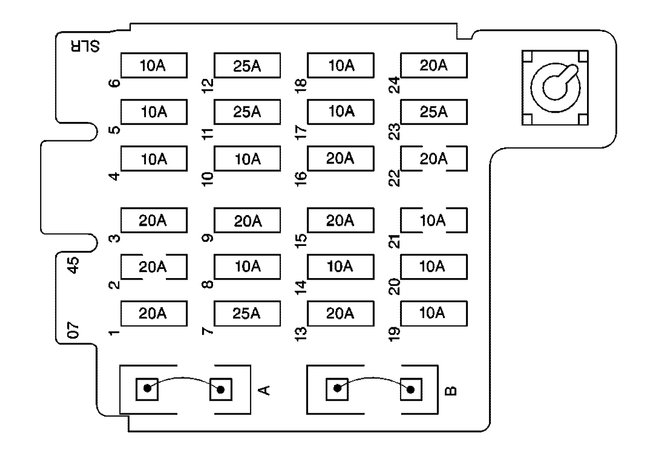

In order to override the system, turn the ignition switch to "off" (not lock), and remove the TURN-B/U fuse (# 16) to remove the battery voltage to the interlock solenoid. The fuse box is at the end of the dash on the side. See pics. You will have to replace the fuse after you shift from park so the turn signals work.
