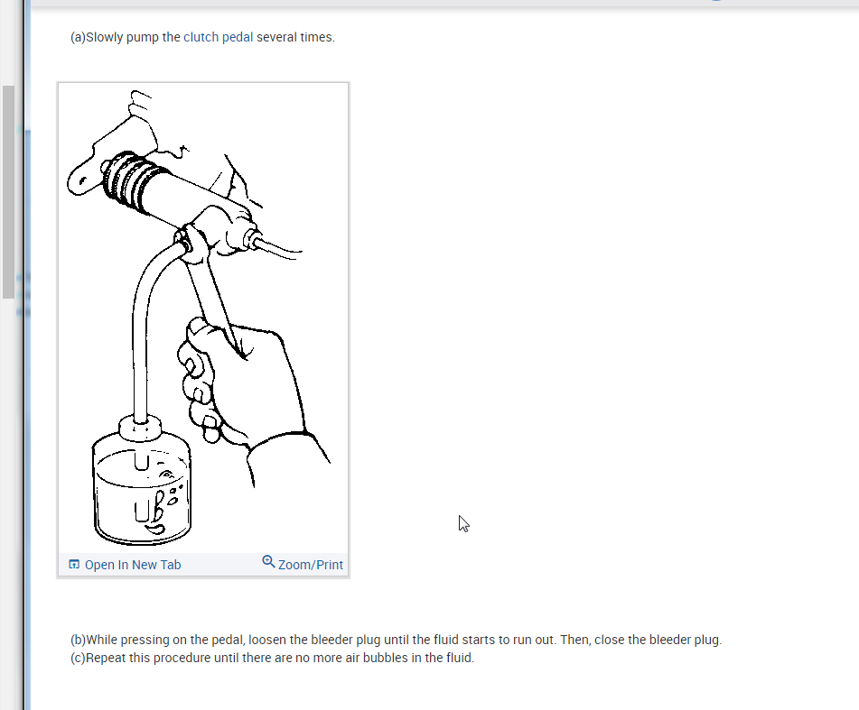

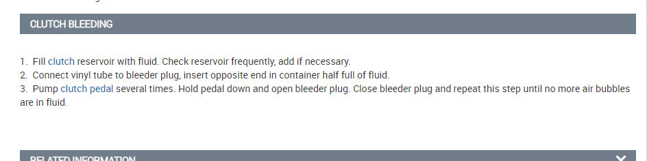

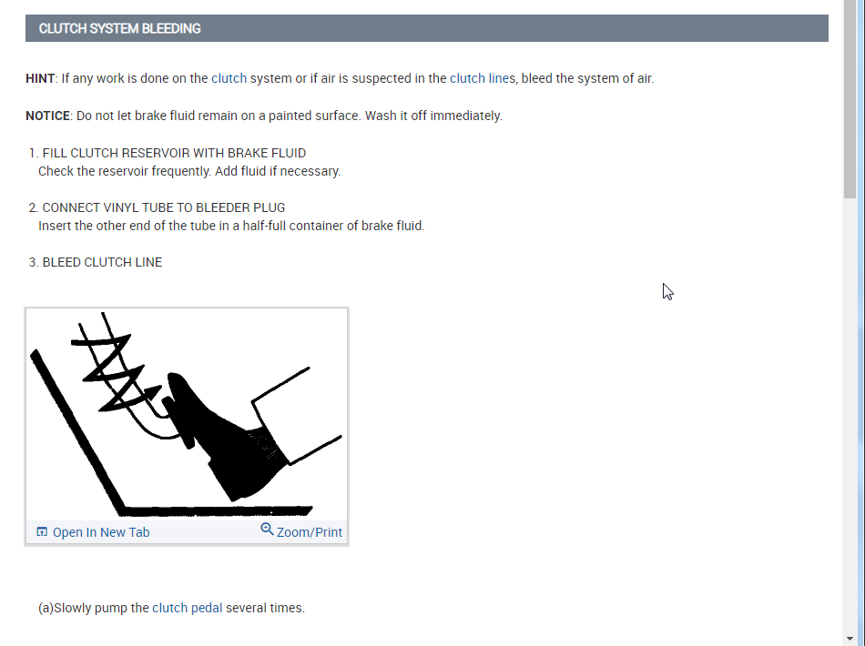

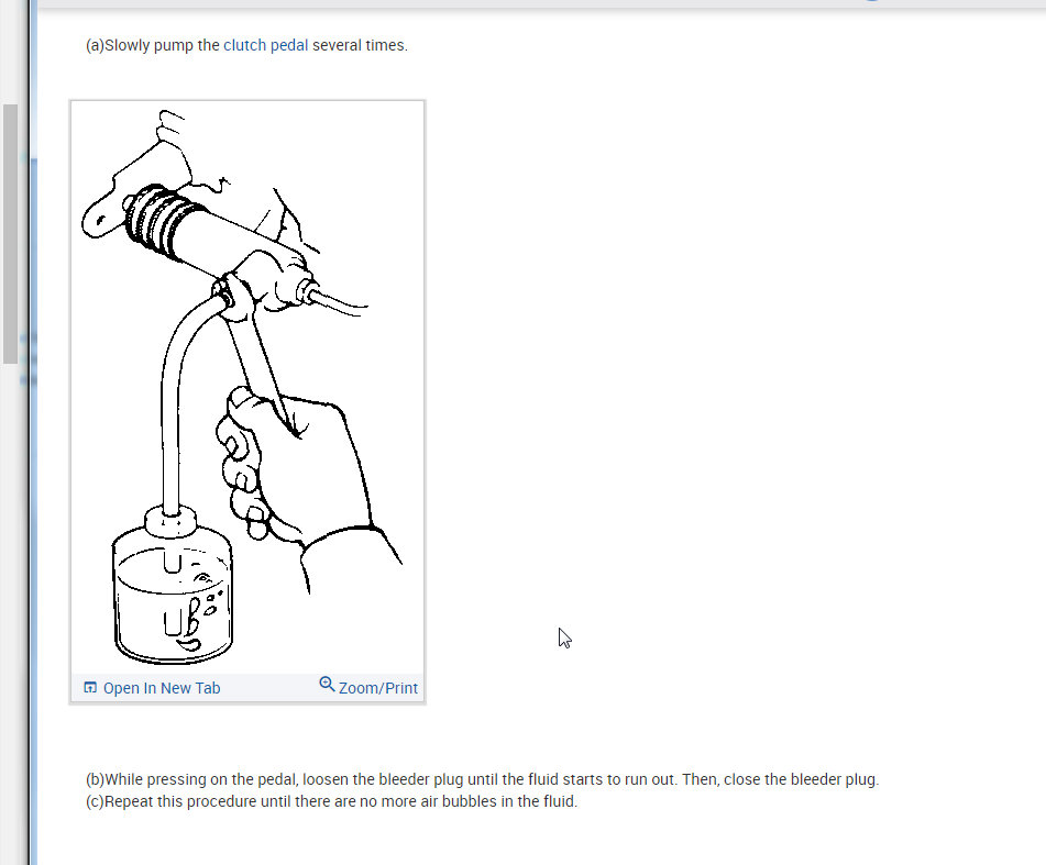

Lastly when you replaced the master did you bench bled it? If not, I suspect you are just pushing and pulling air.
Let's start with this and go from there. I attached the process on how to bleed the clutch in case you need it. Please see below.
