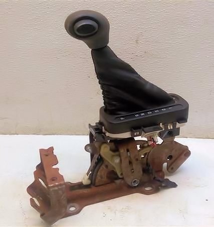

Once the cover is off you will be able to see the shift lever and it's hardware. Look for something jammed or broken in the frame that holds the lever. You may be fortunate and see that a coin or comb or similar has falling in there and is preventing it from moving.
If instead you find something broken or damaged you will probably need to replace the lever. The attached image is what the part looks like.
