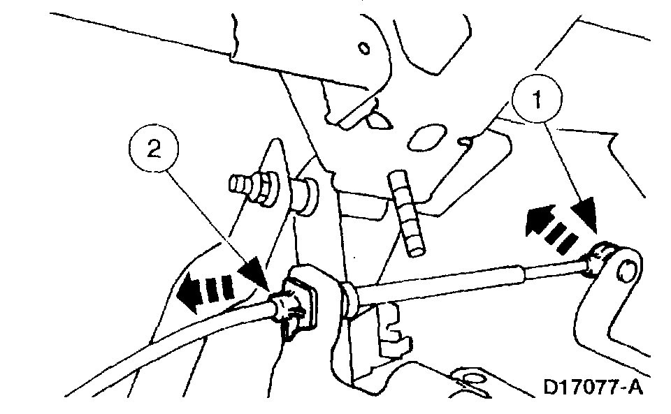

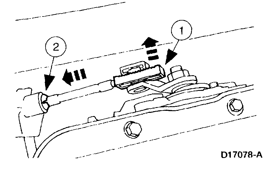

The shift linkage may be out of adjustment or the cable itself may be binding. Here are the directions for removing and replacing. What I suggest is to secure the vehicle with the parking brake and disconnect the cable at the transmission. Once it is disconnected, try shifting (even though it is disconnected). If the cable is still stiff, replace the cable or try to lubricate the cable to loosen it.
Here are the directions for removal and replacement:
PROCEDURES
Removal
1. Disconnect the transmission shift cable from the steering column.
1 Disconnect the transmission shift cable from the transmission selector lever arm and support.
2 Disconnect the transmission shift cable from the steering column instrument panel bracket.

5. Remove the transmission shift cable from the automatic transmission.
1 Disconnect the transmission shift cable from the manual control lever.
2 Depress the lock tabs to release the transmission shift cable and disconnect the transmission shift cable from the transmission shift cable bracket.

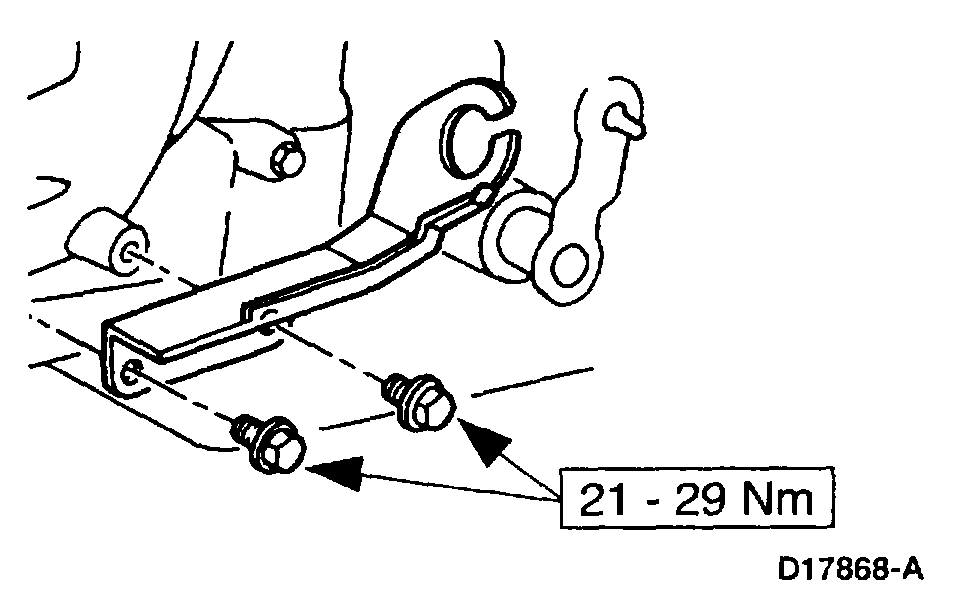

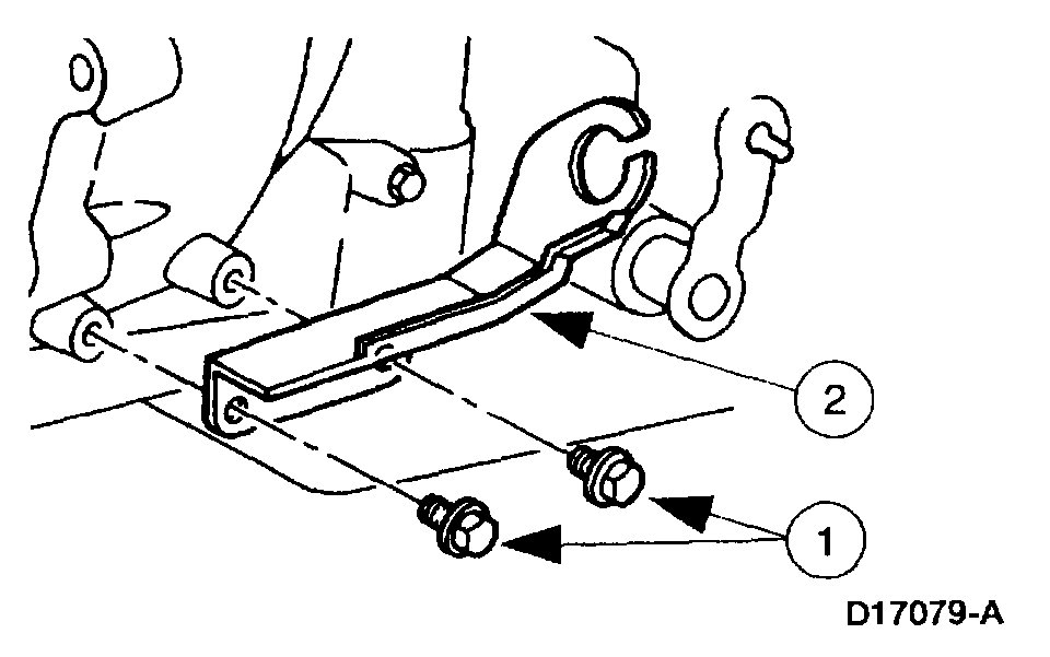

6. Remove the shift cable bracket from the transmission (4.6L).
1 Remove the bolts.
2 Remove the bracket.

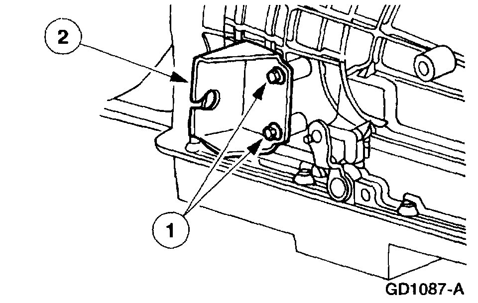

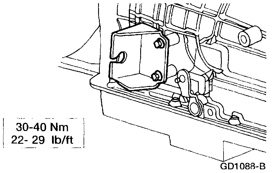

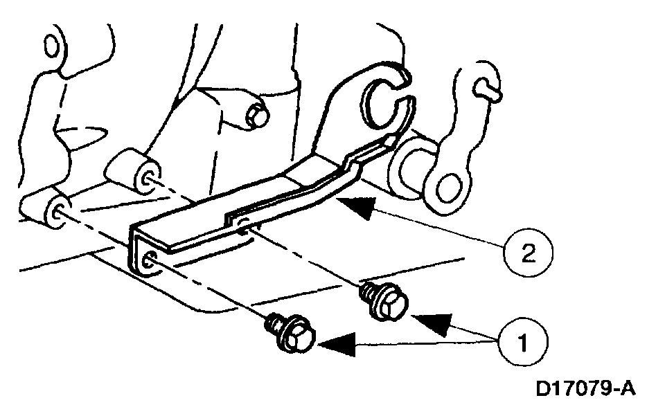

7. Remove the shift cable bracket from the transmission (5.4L).
1 Remove the bolts.
2 Remove the shift cable bracket.
