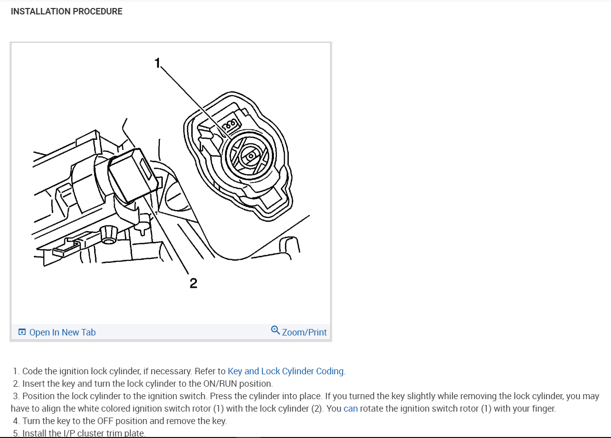

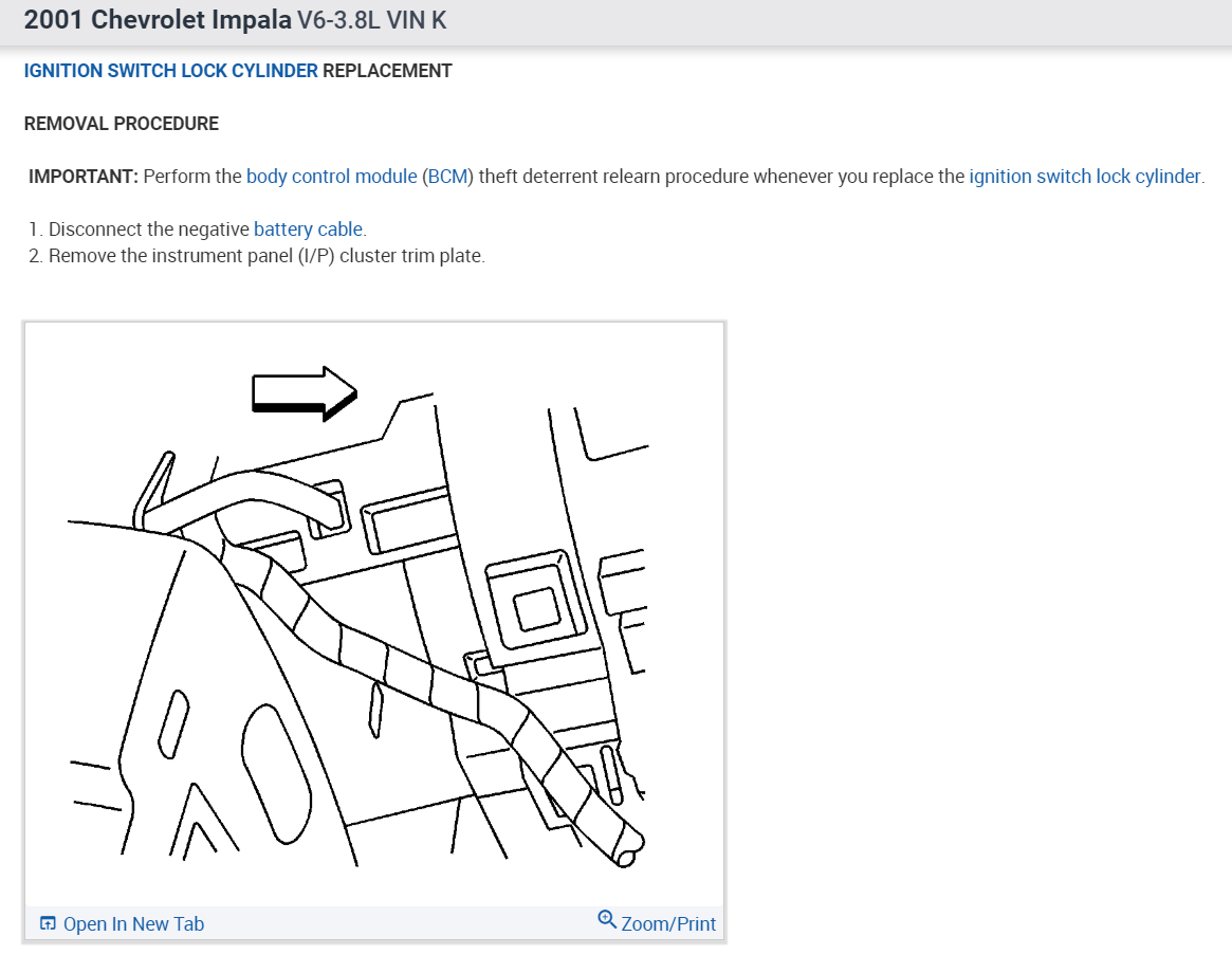

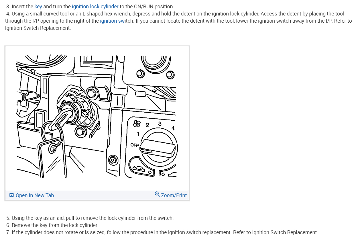

Here is how the tumbler is changed out. Check out the images (below). Let us know how it goes.
