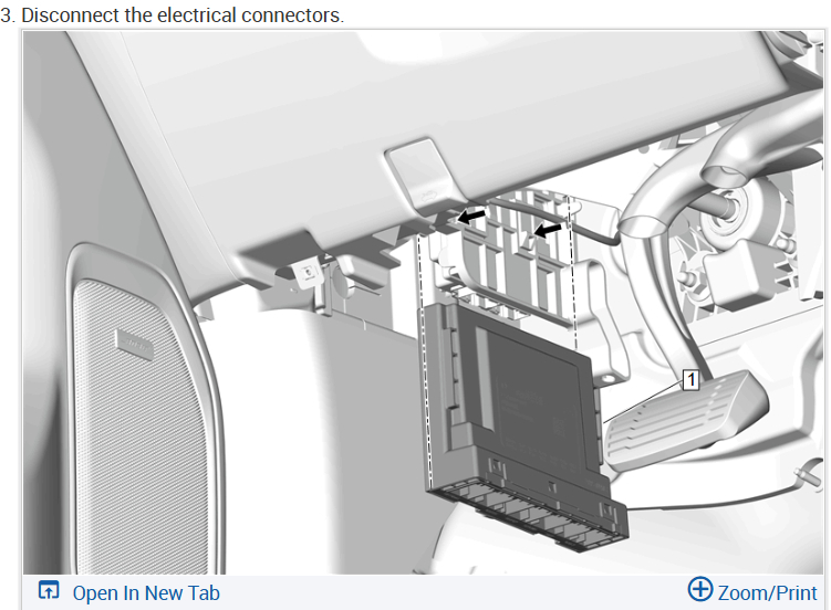

This sounds like the BCM is going bad, but lets disconnect the battery and remove the electrical connectors to check for water damaged/corrosion. Here is the location of the CM so you can check it out, if the connectors look okay, I would get a preprogrammed unit from eBay and install it, here is the location of the BCM so you can check it out. Because of its location water can get to it sometimes and cause damage. Check out the images (below). Please upload an image or short videos in your response.
