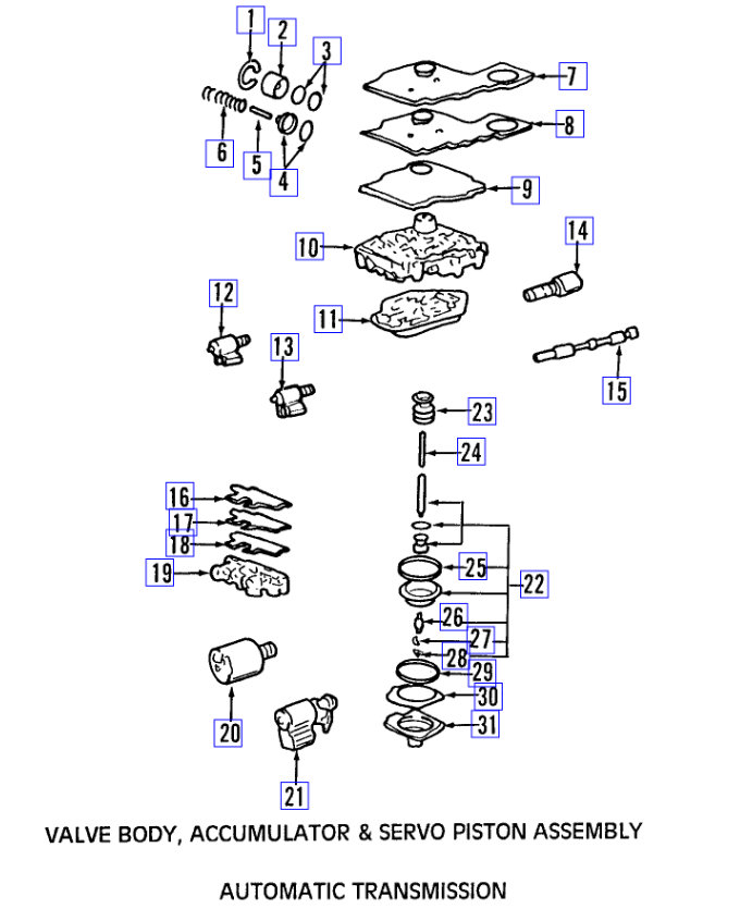

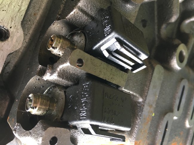

You will need to remove the transmission pan and the shift solenoids will be in the valve body. Here is a generic guide on how to remove the pan and I have left a couple of diagrams of the shift solenoids in the diagrams below.

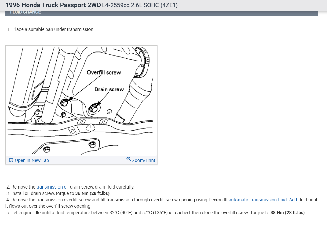

TYPE .................... (DEXRON-IIE (R) Automatic Transmission Fluid)
Capacities
Automatic Transmission, Quarts should be about 4 or 5
