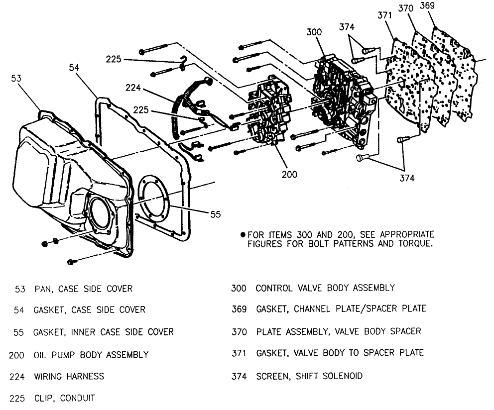

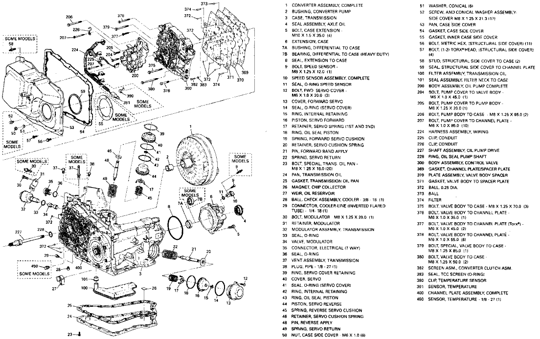

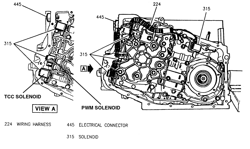

What is the actual problem you are having and which solenoid are you trying to replace as there are three different ones plus the torque converter clutch solenoid and shift interlock solenoid?
All but the interlock solenoid are inside the case cover on the side of the transmission.
To remove that case cover requires removing the left front tire, tie rod end, sway bar link, ball joint then the left drive axle. Disconnect the intermediate steering shaft to avoid damage to the steering gear. Then unbolt the sub-frame and remove the cooler lines and drop the transmission down enough to get the cover off.
Now you have access to the solenoids and the wiring harness. They are easy to remove but may not be the problem.
