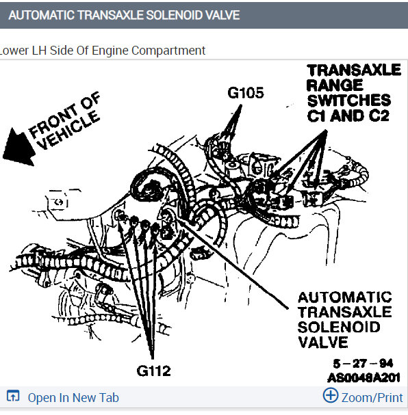

Where are the shift solenoids a and b and how do I get to them?, threw a code for bad shift solenoid.
Sep 21, 2024 at 12:03 PM
BENNY1990
MEMBER
3 POSTS
3.1 v6, code p0758.
Sep 21, 2024 at 12:17 PM
CERTIFIED EXPERT
53,854 POSTS

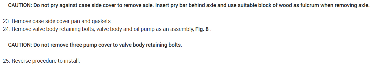

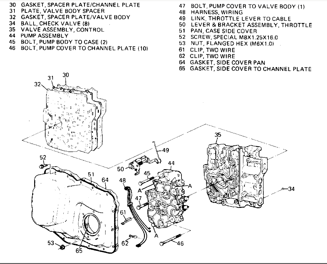

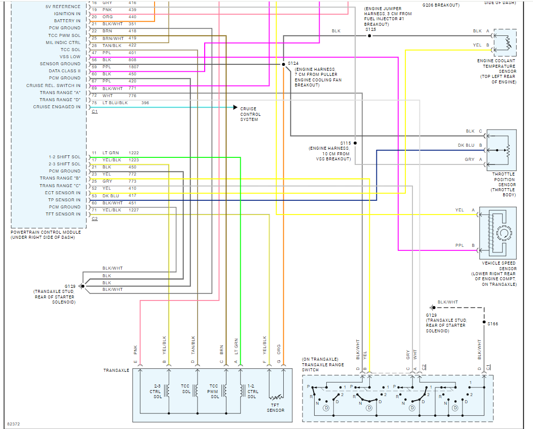

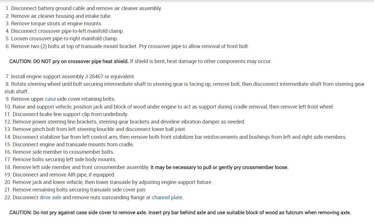

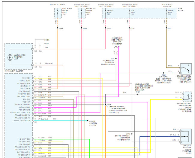

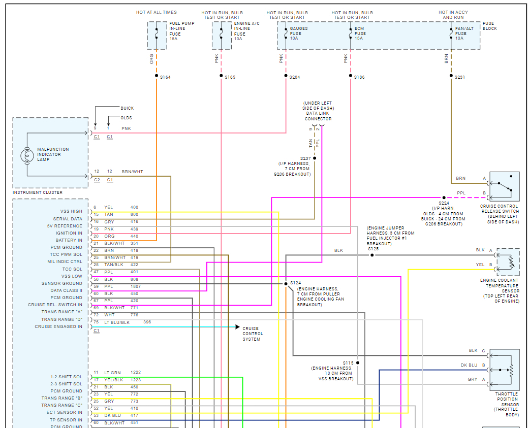

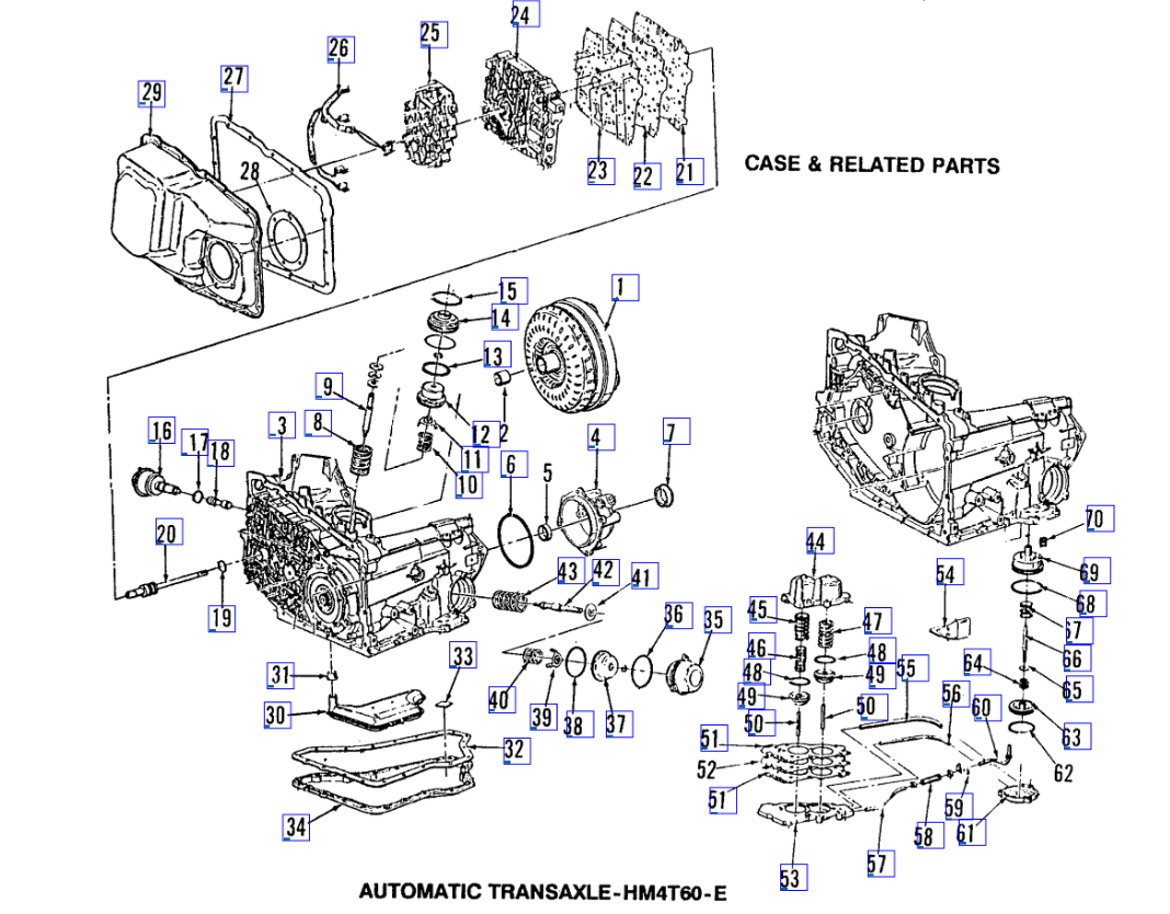

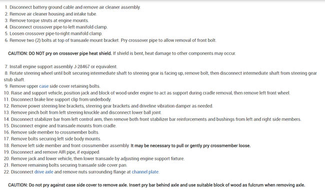

Yep, this is common, here is the location of the shift solenoids and how to change them out in the images below. Here is the location of the solenoids and I have included the transmission wiring diagrams so you can see which ones to replace. Check out the images (below). Please let us know what happens.
