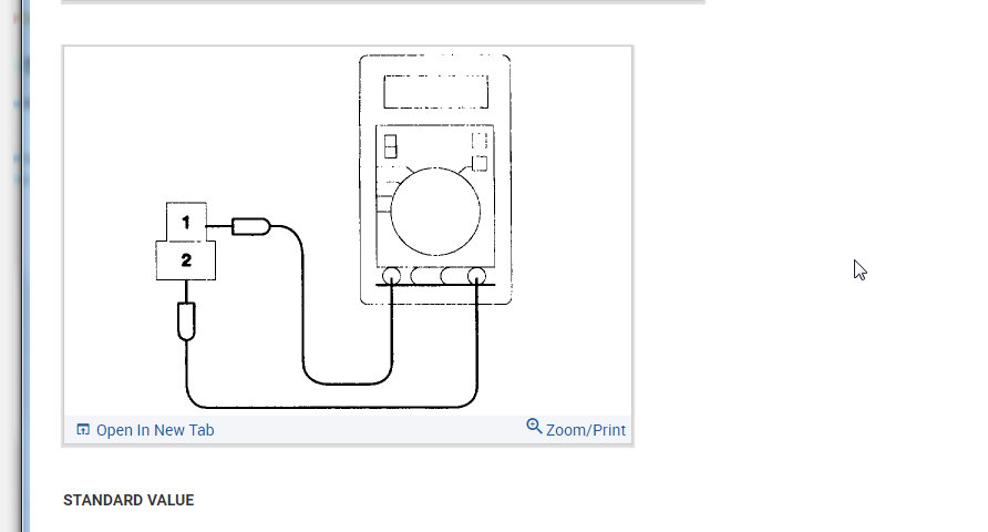

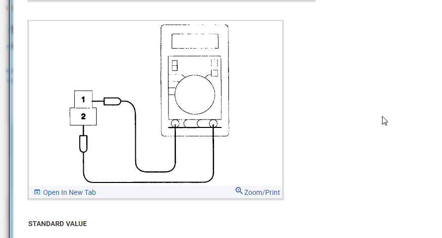

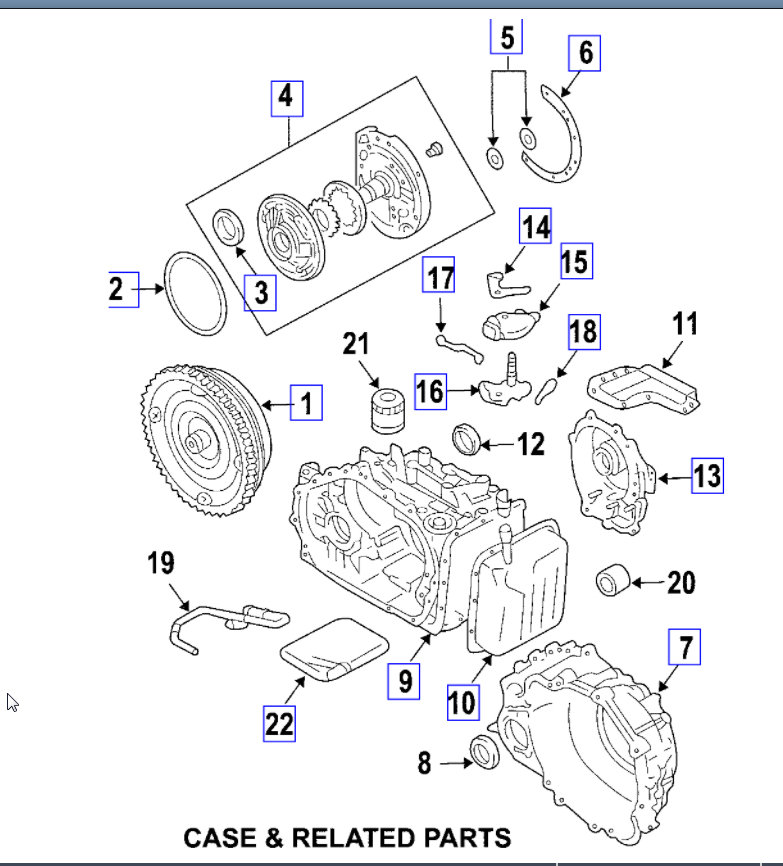

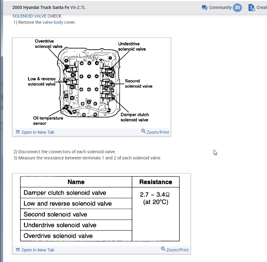

I attached the info on where they are located and how to test them just to be sure they are failed. Let us know if you have questions. FYI - The valve body cover is number 10 in the first attachment.
