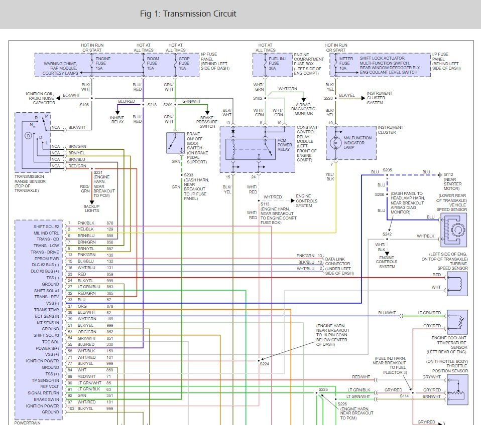

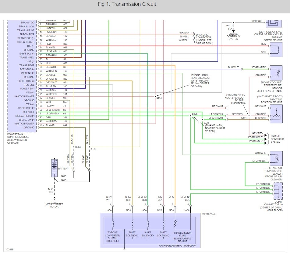

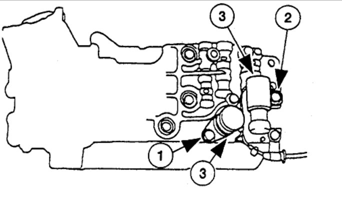

How do you change it? where is it located? what bolts do you take off?
Jun 10, 2017 at 7:34 PM
The shift solenoids are located in the transmission pan. If you don't have a pan then the transmission needs to come out and the side cover must be removed.
Here is a wiring diagram and a guide to show you where it is.
