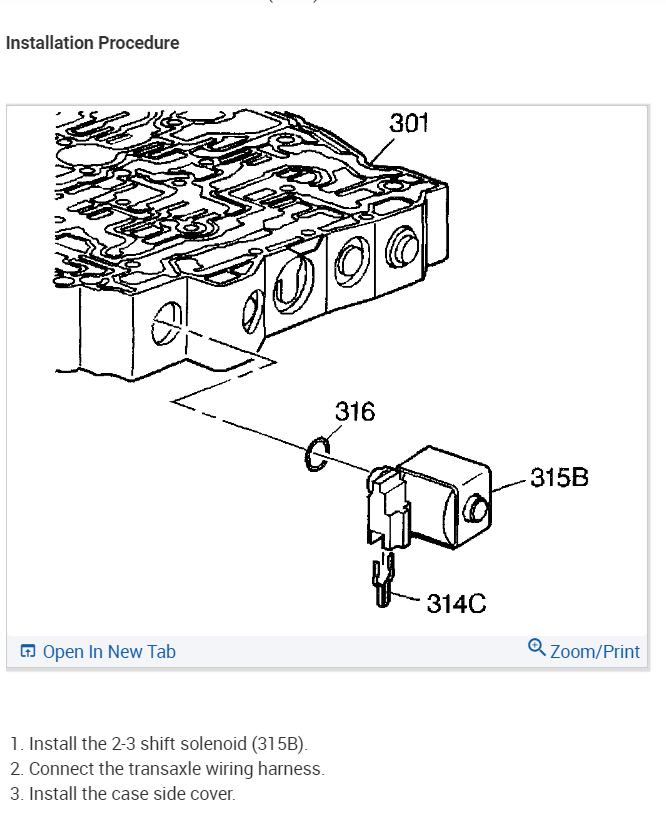

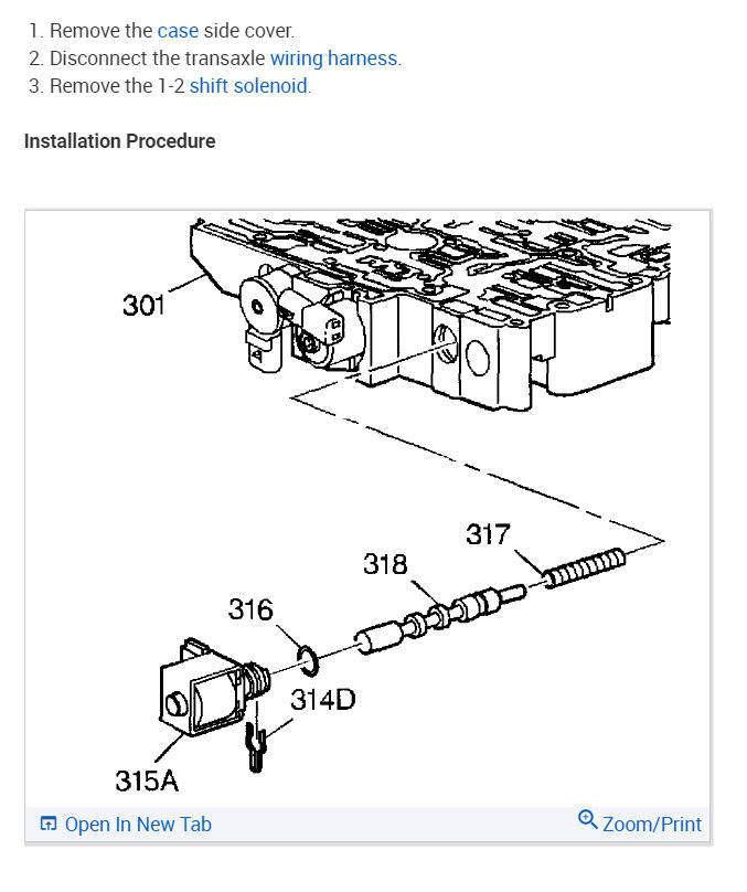

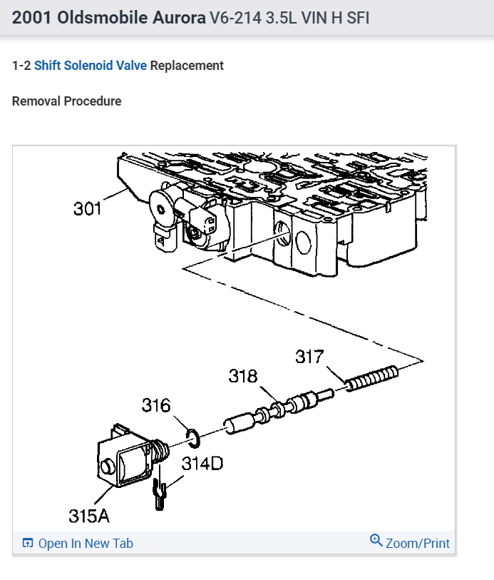

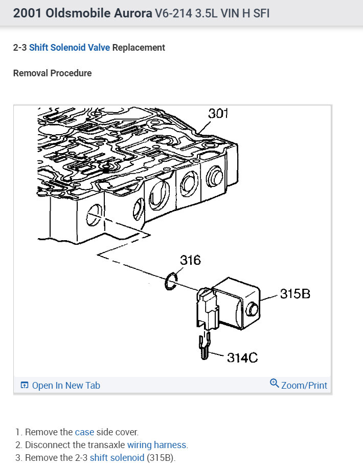

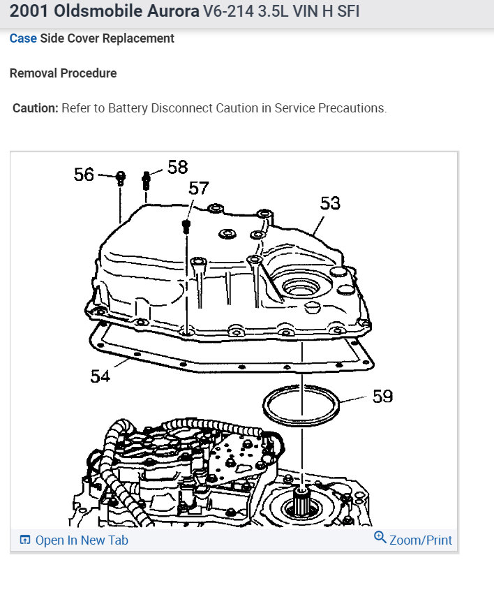

I cannot find where the shift solenoid is located on my car.
Sep 10, 2023 at 8:57 AM

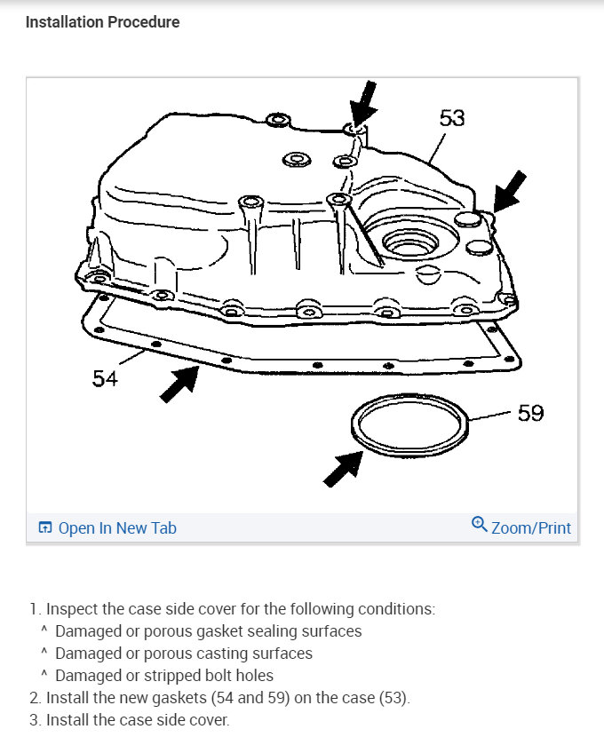

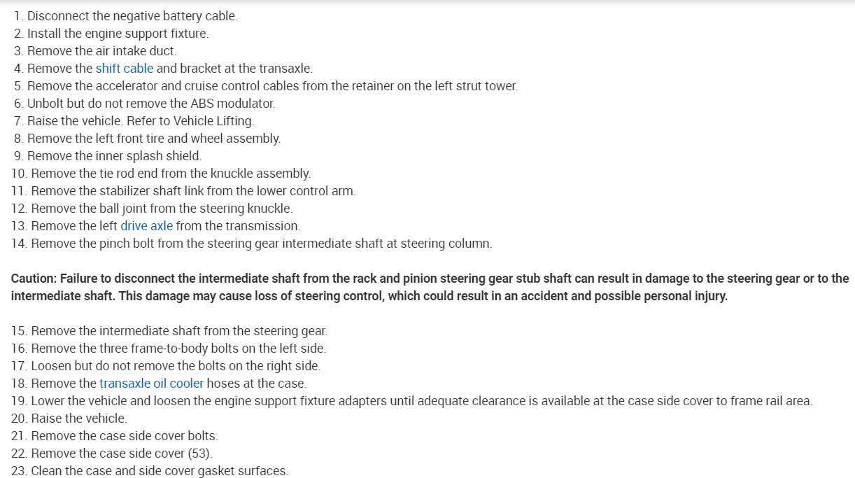

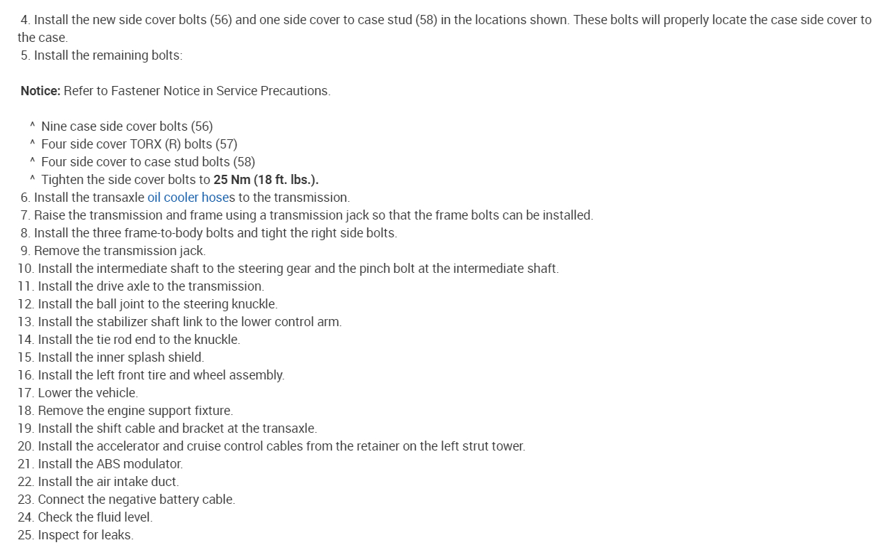

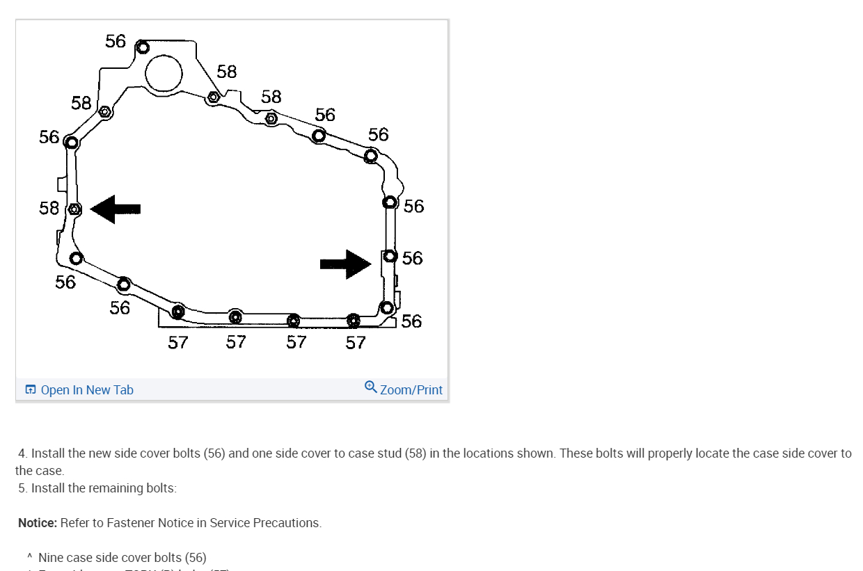

Sure, the shift control solenoids are under the transmission side cover mounted to the valve body, here are the instructions and locations for the shift solenoids as requested. Check out the images (below). Please let us know if you need anything else to get the problem fixed.
