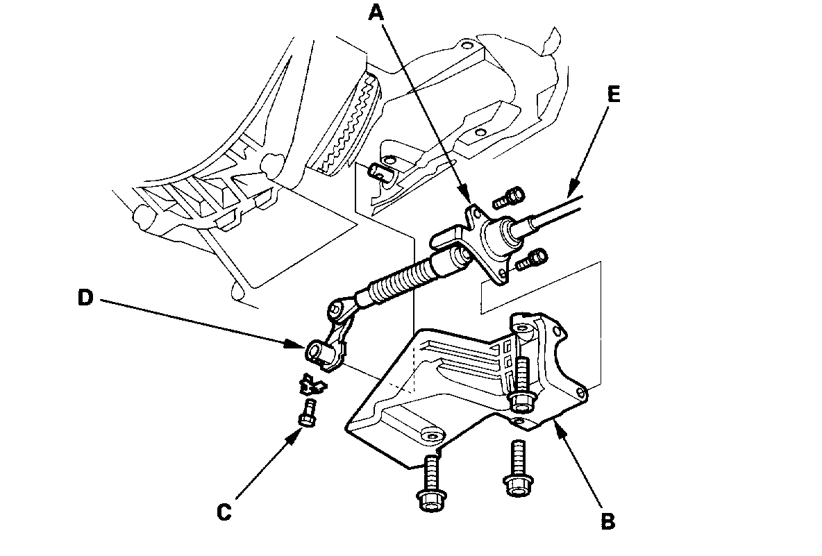

Here are the directions for removal and replacement of the shift cable. I'm adding everything so you can see where it attaches on both ends as well as how it is routed. The attached pictures correlate with the directions.
_____________________
1998 Honda Accord DX Sedan L4-2254cc 2.3L SOHC MFI
Procedures
Vehicle Transmission and Drivetrain Automatic Transmission/Transaxle Shift Linkage Shift Cable Service and Repair Procedures
PROCEDURES
Replacement
1. Raise the front of the vehicle, and make sure it is securely supported.
2. Set the parking brake, and block the rear wheels securely.
3. Shift the transmission into R position.
4. Remove the console panel.
pic 1

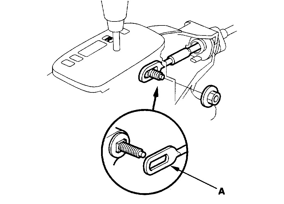

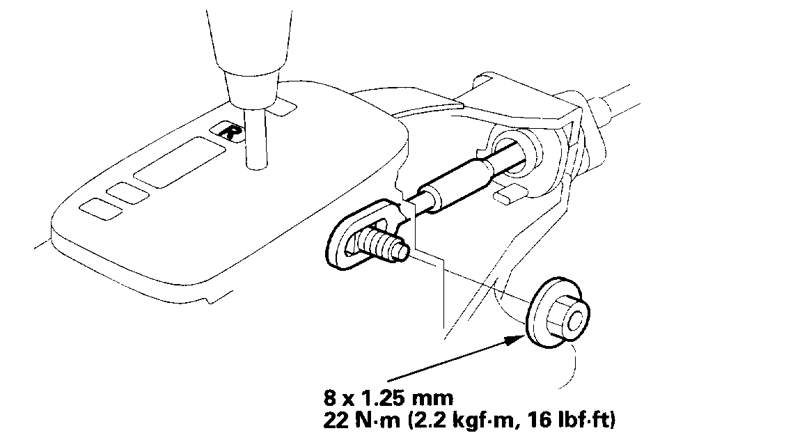

5. Remove the nut securing the shift cable end (A), then separate the shift cable end from the shift lever assembly.
pic 2

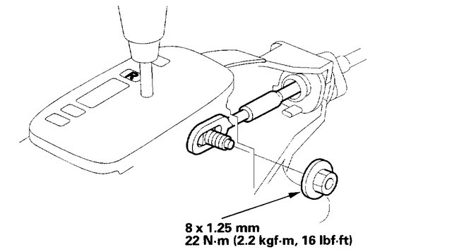

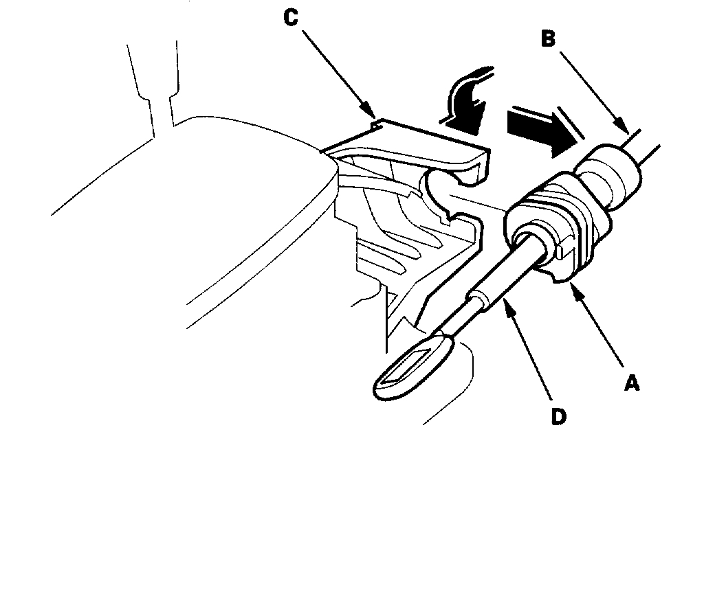

6. Rotate the socket holder (A) on the shift cable (B) counterclockwise a quarter turn, then slide the holder to remove the shift cable from the shift lever bracket base (C).
NOTE: Do not remove the shift cable by twisting the shift cable guide pipe (D).

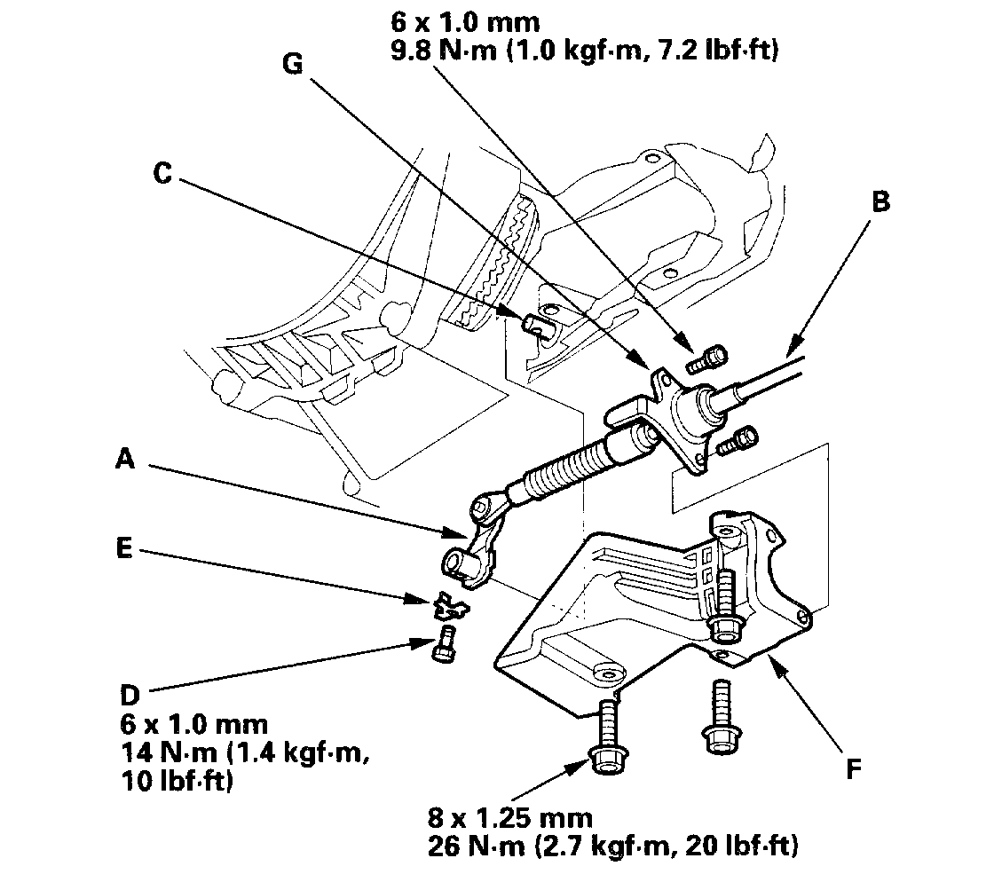

7. Remove the floor heat shield.
pic 3
8. Remove the shift cable guide bracket (A) and grommet (B).
pic 4

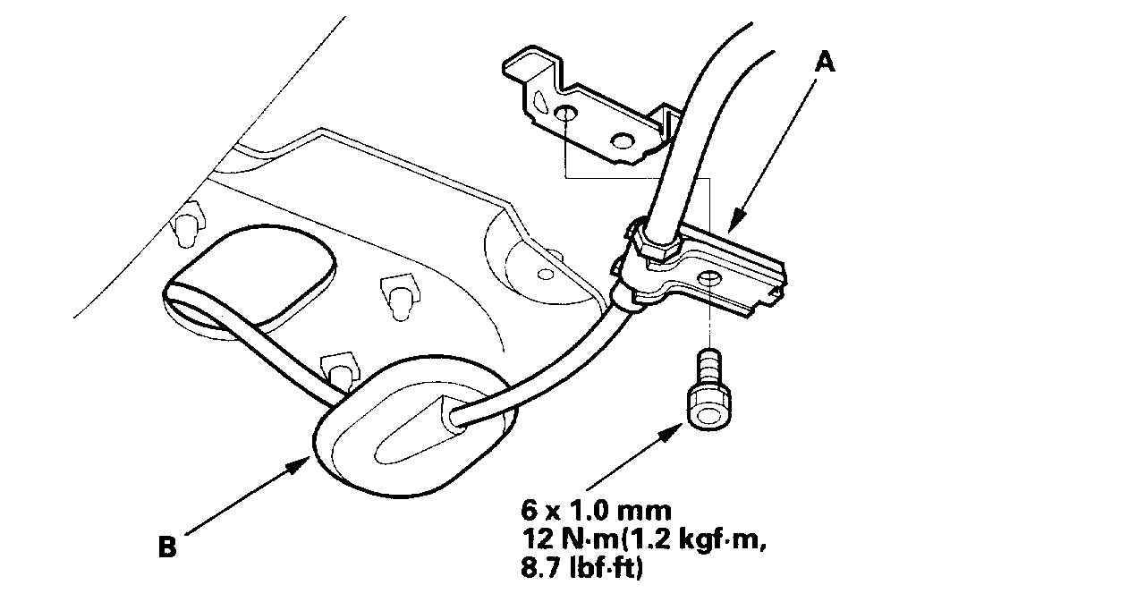

9. Remove the bolts securing the shift cable holder (A), then remove the shift cable cover (B).
NOTE: To prevent damage to the control lever joint, remove the bolts securing the shift cable holder before removing the bolts securing the shift cable cover
10. Remove the lock bolt (C) securing the control lever (D), then remove the shift cable (E) with the control lever.

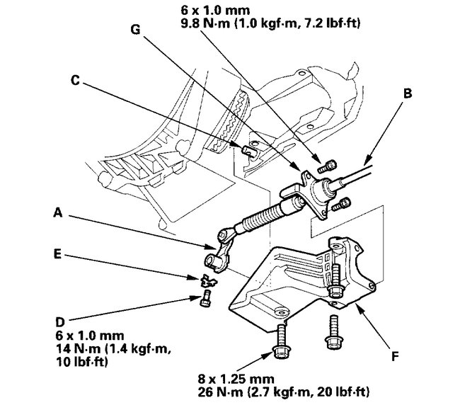

11. Insert the new shift cable through the grommet hole, then install the shift cable guide bracket.
12. Verify that the transmission is in R position on the control shaft.
pic 5
13. Install the control lever (A) with the shift cable (B) on the control shaft (C). Do not bend the shift cable excessively.
14. Install the lock bolt (D) with a new lock washer (E), then bend the lock washer tab against the bolt.
15. Install the shift cable cover (F), then install the shift cable holder (G) on the cover.
NOTE: To prevent damage to the control lever joint, be sure to install the shift cable holder after installing the shift cable cover to the torque converter housing.
16. Install the floor heat shield.

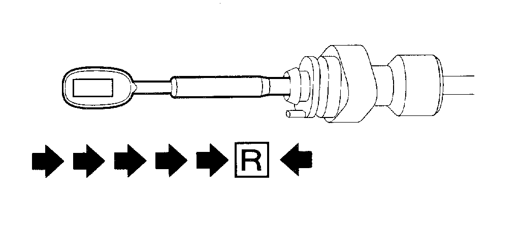

18. If necessary, push the shift cable until it stops, then release your hand. Pull the shift cable back one step so that the shift position is in R.
19. Turn the ignition switch OFF.

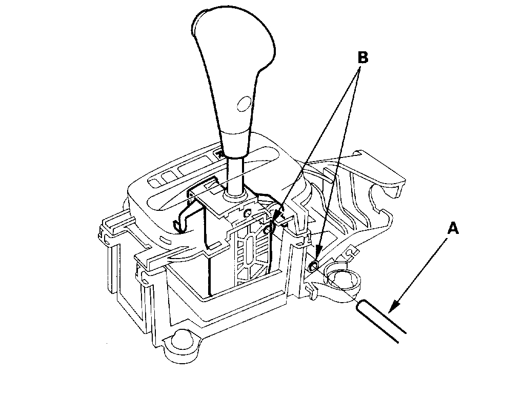

20. Insert a 6.0 mm (0.24 inch) pin (A) into the positioning hole (B) on the shift lever bracket base through the positioning hole on the shift lever assembly.
pic 8

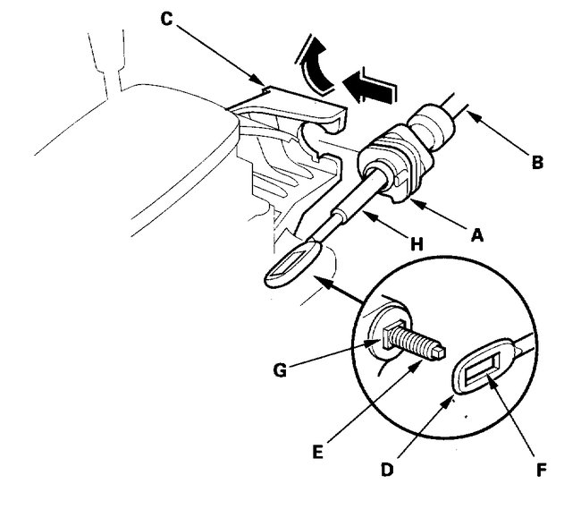

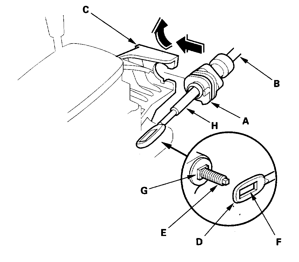

21. Rotate the socket holder (A) on the shift cable (B) counterclockwise a quarter turn, then slide the holder onto the shift lever bracket base (C). Install the shift cable end (D) over the mounting stud (E) by aligning its square hole (F) with the square shape (G) at the bottom of the stud. Rotate the holder clockwise a quarter turn to secure the shift cable.
NOTE: Do not install the shift cable by twisting the shift cable guide (H).
pic 9

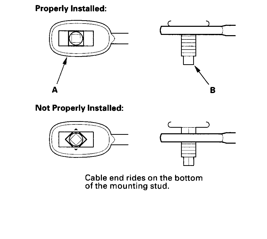

22. Verify that the shift cable end (A) is properly installed on the mounting stud (B).
23. If not properly installed, remove the shift cable from the shift lever bracket base, and reinstall the shift cable. Do not install the shift cable end on the mounting stud while the shift cable is on the shift cable bracket base.

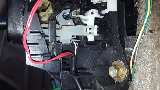

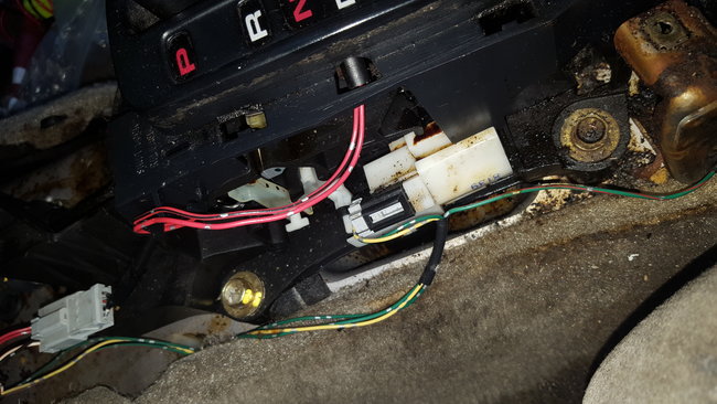

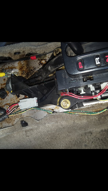

PS.my gear shift can move to every gear and back into gear without having my foot on the brake and without having the key in the ignition I've inspected the cable inside the car that is attached to the gear shift and the cable under the car and they are working fine I can start my car in park and neutral but not in Reverse or drive so I'm finding it hard to understand how the car could be tripping the code for the neutral switch if I've already tested it with a meter and it said it's fine and it's not allowing me to start the car and drive so it seems to be working.
Sep 23, 2019 at 8:17 AM
Welcome back:

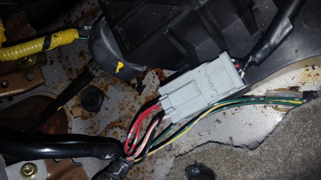

The wiring harness in the pic above appears to be for the park interlock system. With the engine off and your foot off the brake, can you shift from park? I have a feeling that part is the problem.
Sep 23, 2019 at 8:13 PM
MUSICGENIUS83
  • 29 POSTS
Yes I can, no key, no foot on brake , still can shift to all heard, and disconnecting that is the only way I can get key out, and when I disconnect out harness the tightness of moving it into Park and it popping out of park into neutral doesn't happen when that's not connected there's resistance almost like there's something in the way or there's a spring holding it from going into park smoothly if it's not unplugged.
Sep 23, 2019 at 8:51 PM
MUSICGENIUS83
  • 29 POSTS
I will attach a couple more pictures from a different viewpoint because I can shift without my foot being on the break or the key in the ignition I have no doubt that the shift interlock solenoid is probably bad but the clip that I'm referring to is going directly into the shift assembly itself it's a four wire clip and two of the wires are red and they lead to the light bulb that illuminates the gears and the other two are black and white and they go directly into the mechanism I guess you would call it the shift assembly you can see black electrical tape around the wires that are leading to the four at the clip.
Sep 23, 2019 at 9:17 PM
Welcome back:

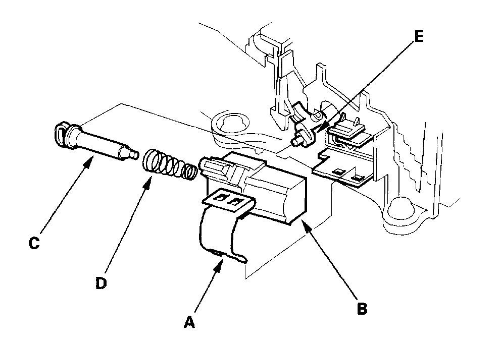

The second pic is a good one of the shift interlock solenoid. I attached a pic below of it as well. Now, I have a feeling that something may have come disconnected with the solenoid, so I want you to remove it and inspect to see if all is properly attached and nothing is broken. Here are the directions for removal and replacement. That solenoid could be causing the increased pressure requirements. The second pic correlates with the directions.
Procedures
Vehicle Powertrain Management Transmission Control Systems Actuators and Solenoids - Transmission and Drivetrain Actuators and Solenoids - A/T Shift Interlock Solenoid Service and Repair Procedures
PROCEDURES
Replacement
1. Remove the center console.
2. Disconnect the shift lock solenoid 2P connector.
pic 2
3. Pry the shift lock solenoid clamp (A) with a screwdriver, then remove the shift lock solenoid (B).
4. Install the shift lock solenoid plunger (C) and plunger spring (D) in the new shift lock solenoid.
5. Install the shift lock solenoid by aligning the joint of the shift lock solenoid with the tip of the shift lock stop (E).
6. Secure the shift lock solenoid with the clamp, then connect the shift lock solenoid connector.
____________________________
Let me know if that helps and what you find.

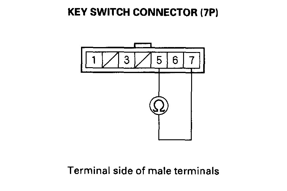

1. Remove the driver's dashboard lower cover.
2. Disconnect the key switch 7P connector from the steering lock assembly.
pic 1
3. Check for continuity between the No. 5 and No. 7 terminals when the key is pushed, and check for no continuity when the key is released.
4. Check that the key cannot be removed with power connected to the No. 7 terminal and ground connected to the No. 3 terminals.
If the key cannot be removed, the key interlock solenoid is OK. If the key can be removed, replace the steering lock assembly (the key interlock solenoid is not available separately).

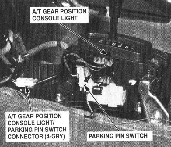

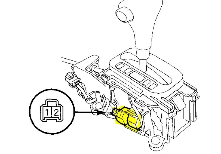

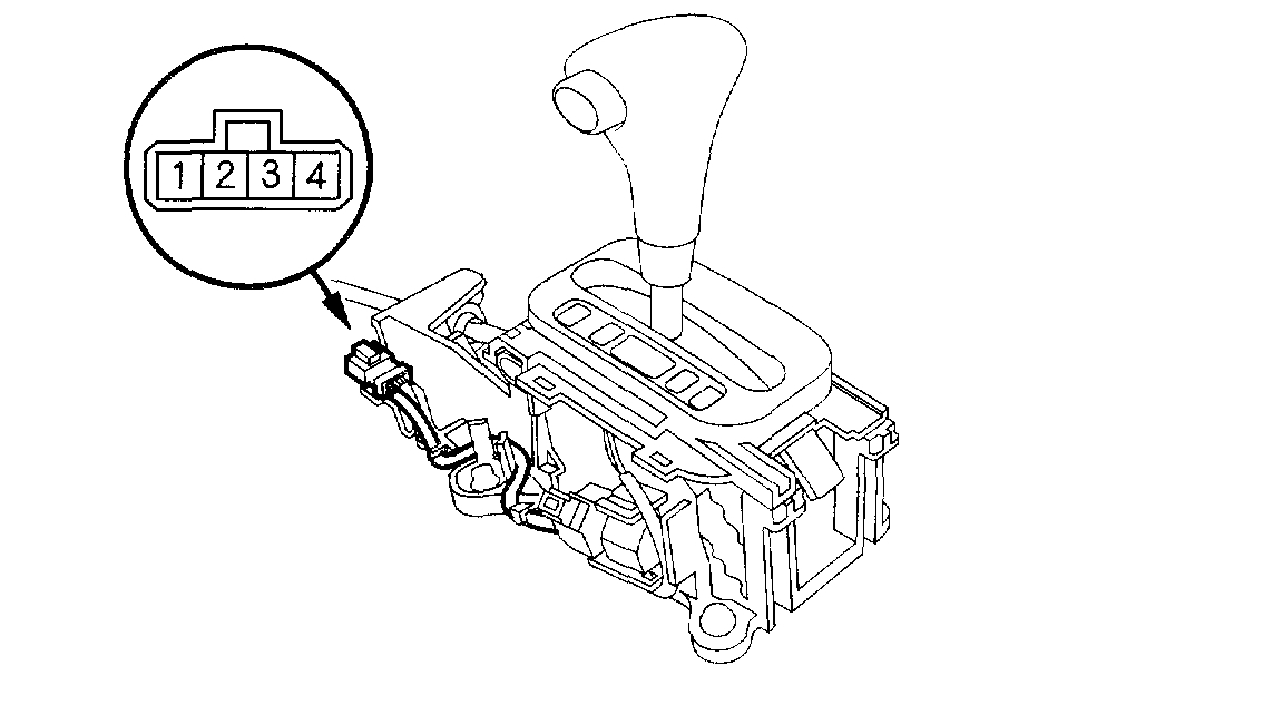

Park Pin Switch Test
Vehicle Transmission and Drivetrain Automatic Transmission/Transaxle Shift Interlock Testing and Inspection Component Tests and General Diagnostics Park Pin Switch Test
PARK PIN SWITCH TEST
Test
pic 2 and pic 3
2. Disconnect the park pin 4P connector.
3. Shift the shift lever into the P position, then check for continuity between the No. 3 and No. 4 terminals. There should be no continuity.
4. Shift the shift lever out of the P position, and check for continuity between the terminals in step 3. There should be continuity.
5. If the park pin switch is faulty, replace the shift lever bracket base.
NOTE: The park pin switch is not available separately from the shift lever bracket base.

Okay I checked continuity on the Park Pin switch it had continuity on the terminals 3 and 4 when I had it in reverse and when I put it into park it has zero continuity just like your direction said. I'm confused about the ignition lock switch. I have a Haynes book for my 1998 Accord and the Google search images. the ones in my book don't show a 7 pin connector it shows a 5-pin or even a 4. I'll send a picture of it. I know it's the ignition switch because it goes right to the ignition. when I Google ignition lock switch it shows me a picture of this red clip that comes out of the back of the fuse box under the steering wheel. I'm not sure if it's a different one or not and yes I agree that it's surprising and kind of weird that I can get my key in and out just fine when the pin switch isn't connected, but when it is it won't let me kind of a reversal.
Oct 1, 2019 at 2:05 PM

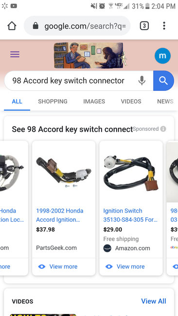

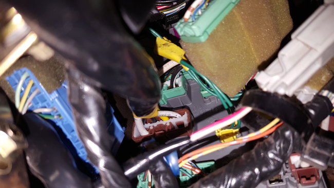

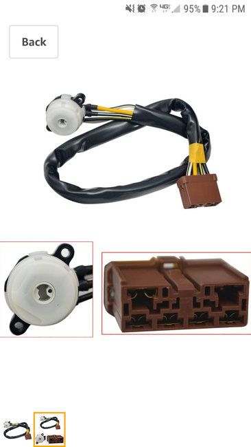

The only thing Alldata shows is the 7 pin. I double checked. Maybe it has something to do with the production date, but again nothing is indicated. I even went back a year, and 1987 shows an 8 pin connector and 1999 shows a 7 pin connector. The only other thing I can think of is the fact that although the connector is a 7 pin, there are only 5 pins in it. Does that make sense? Looking at you 2nd pic, that is what it appears you have.
Is the one on your vehicle 5 pin?
Oct 1, 2019 at 5:56 PM
MUSICGENIUS83
  • 29 POSTS
Yes, I pulled it out and it's definitely the ignition switch clip I'm just not sure where to put the test leads to check it. this is a close picture what it is:
Oct 1, 2019 at 9:29 PM
Welcome back:
I'm not sure what to say on that set up. I have nothing on it. However, if everything else checks good, the switch must be the issue.
