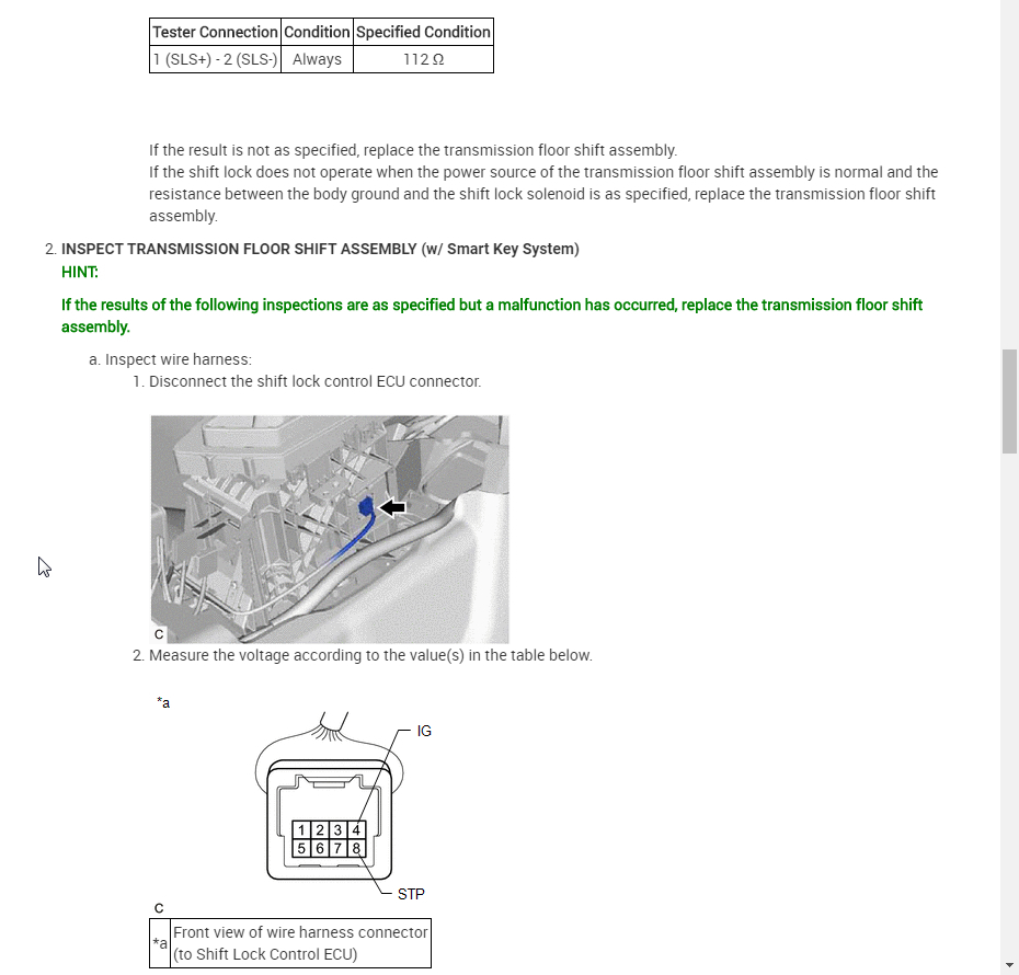

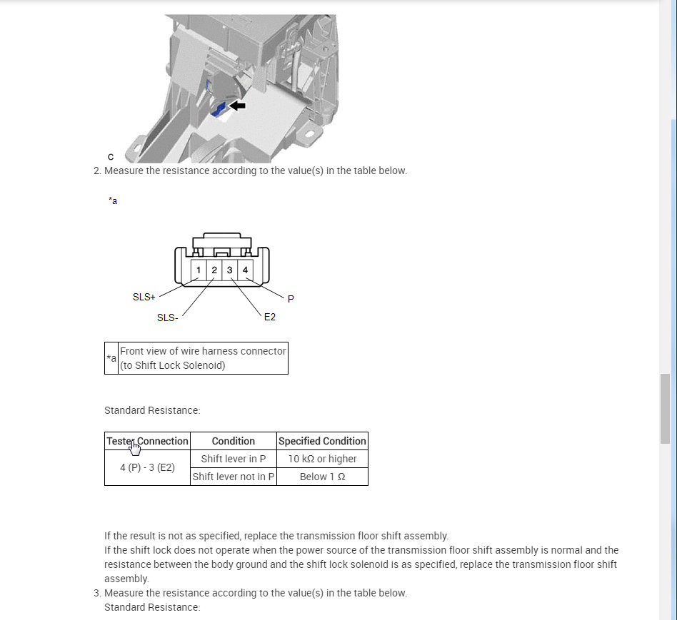

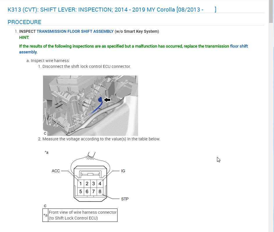

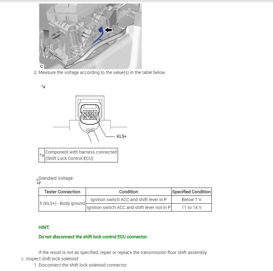

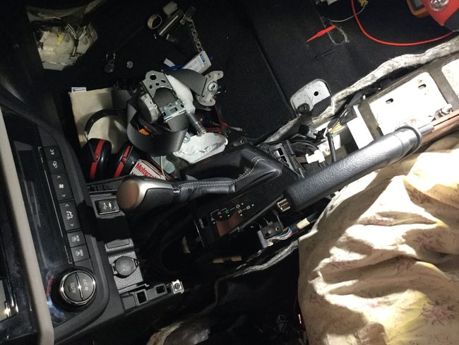

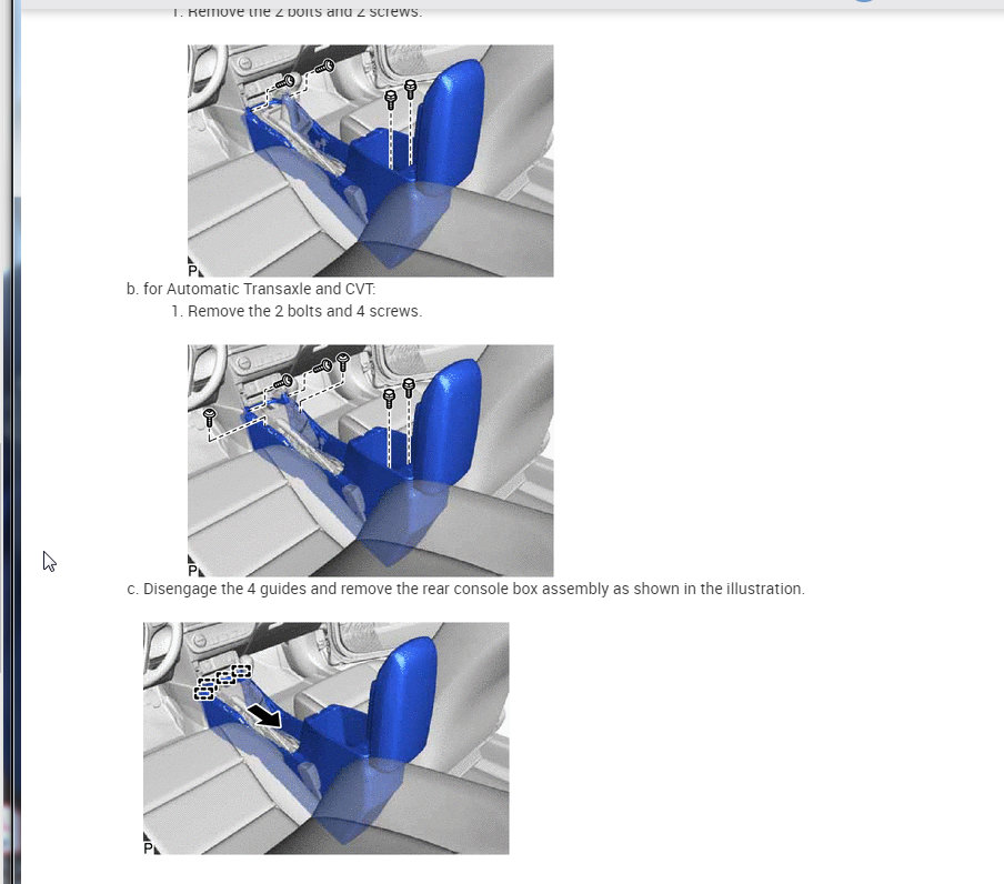

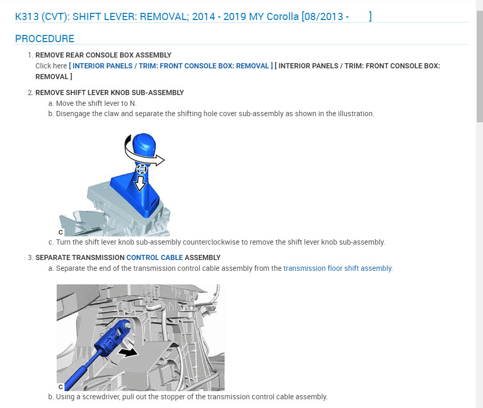

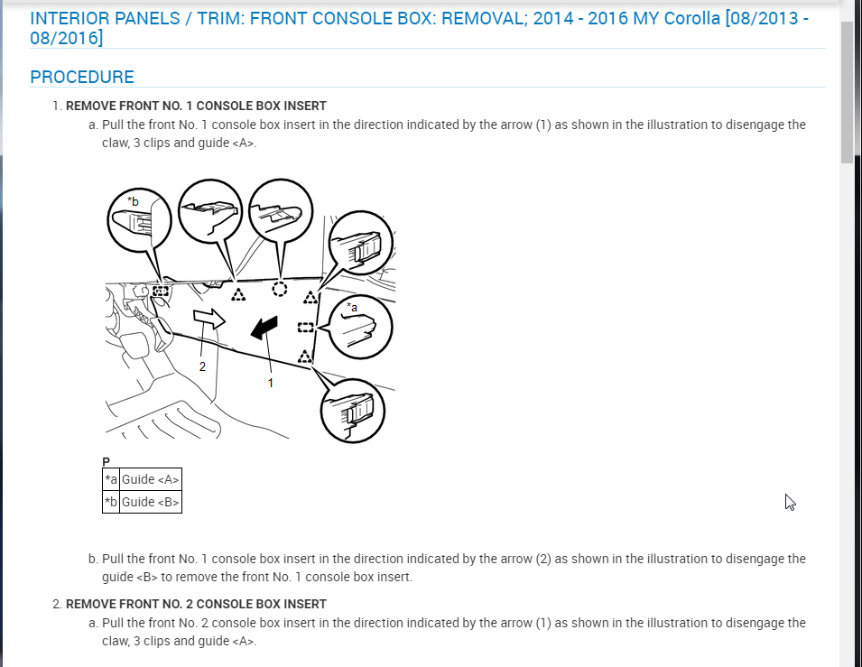

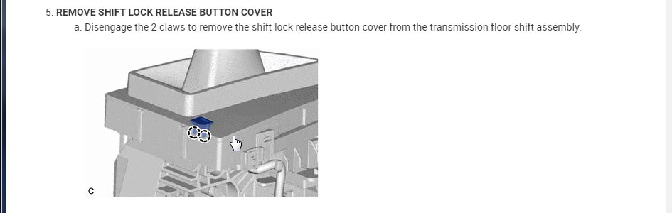

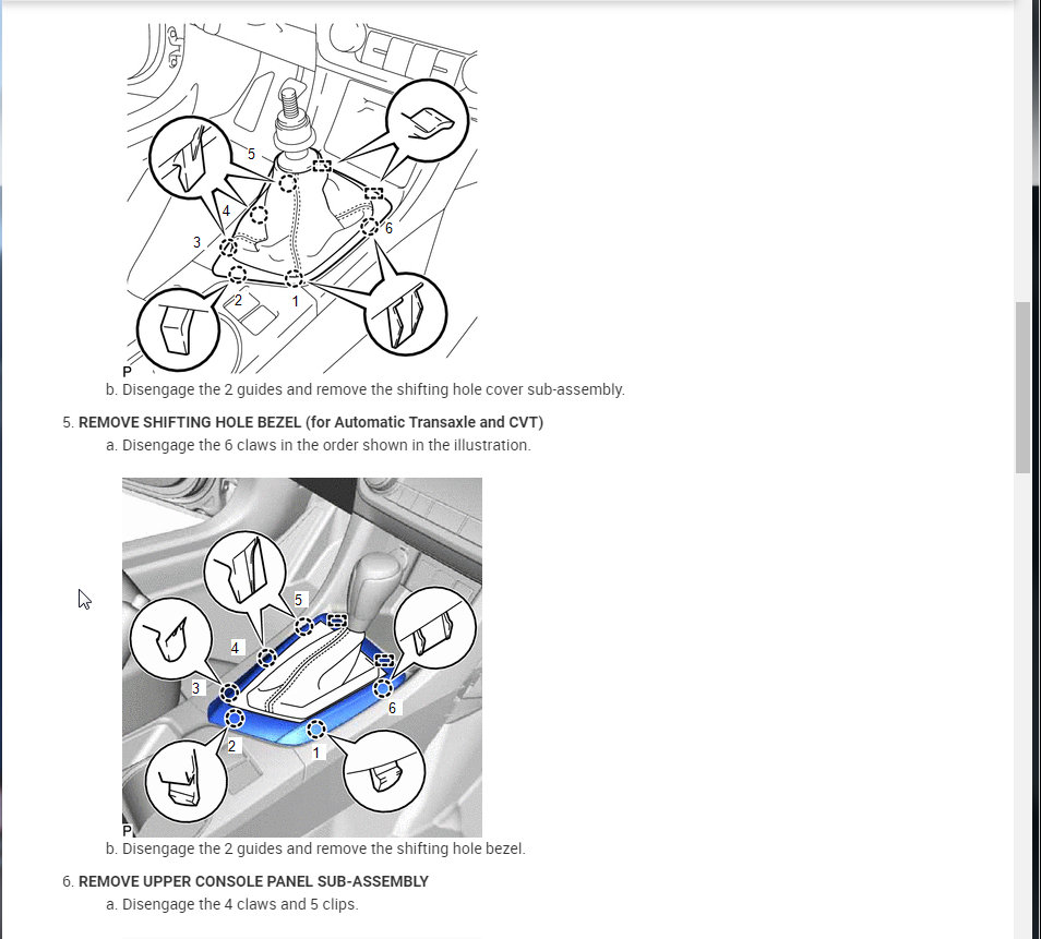

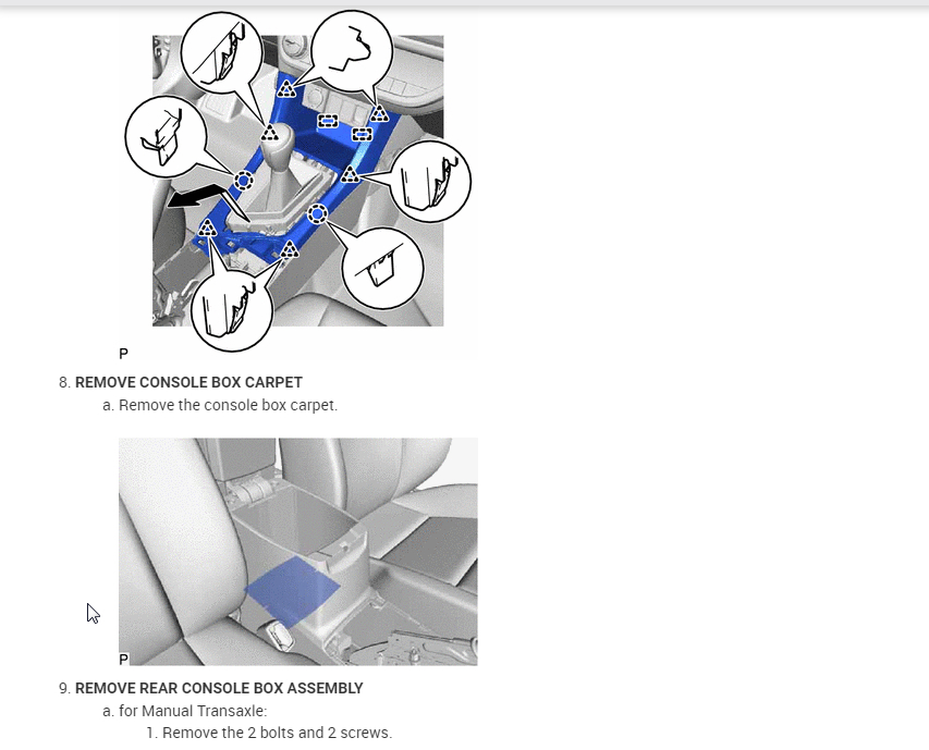

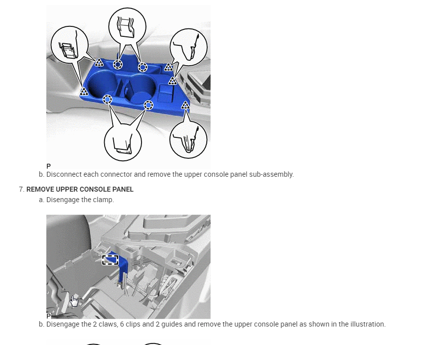

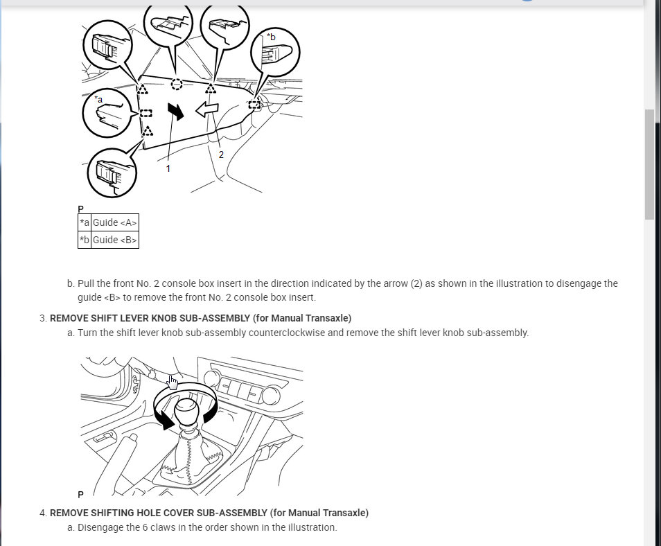

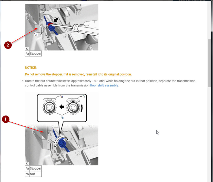

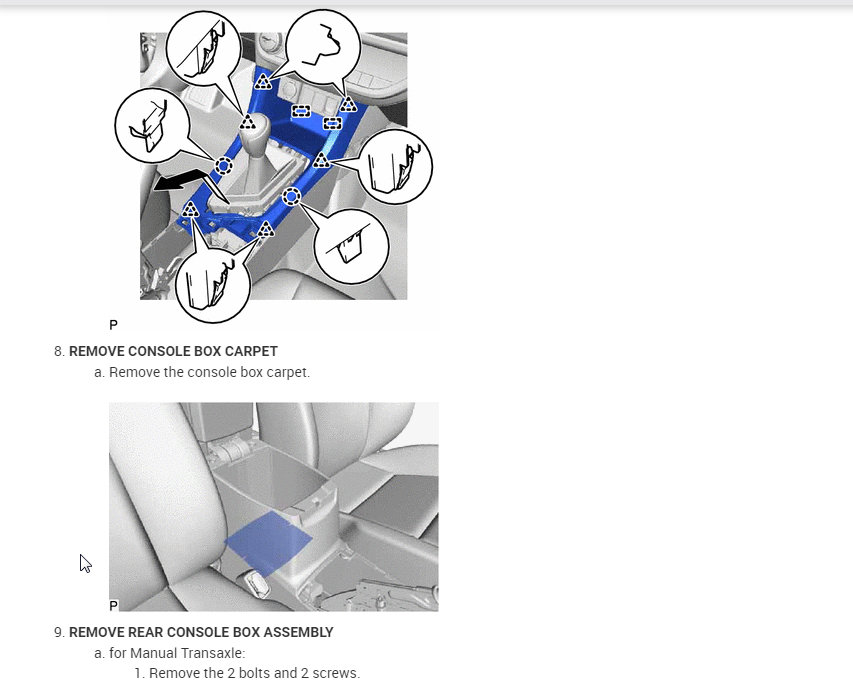

Unfortunately, there is no easy way to bypass this other then removing the center console and expose the solenoid then hope that moving it manually will release the lock.

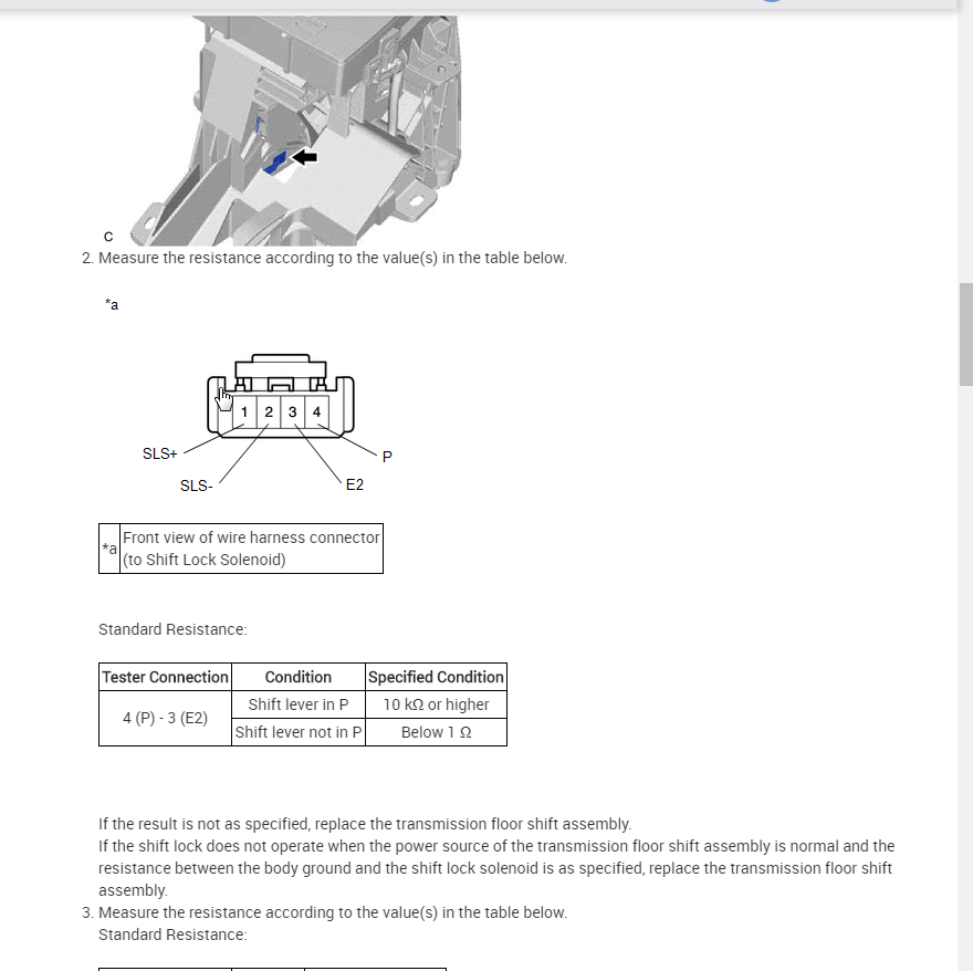

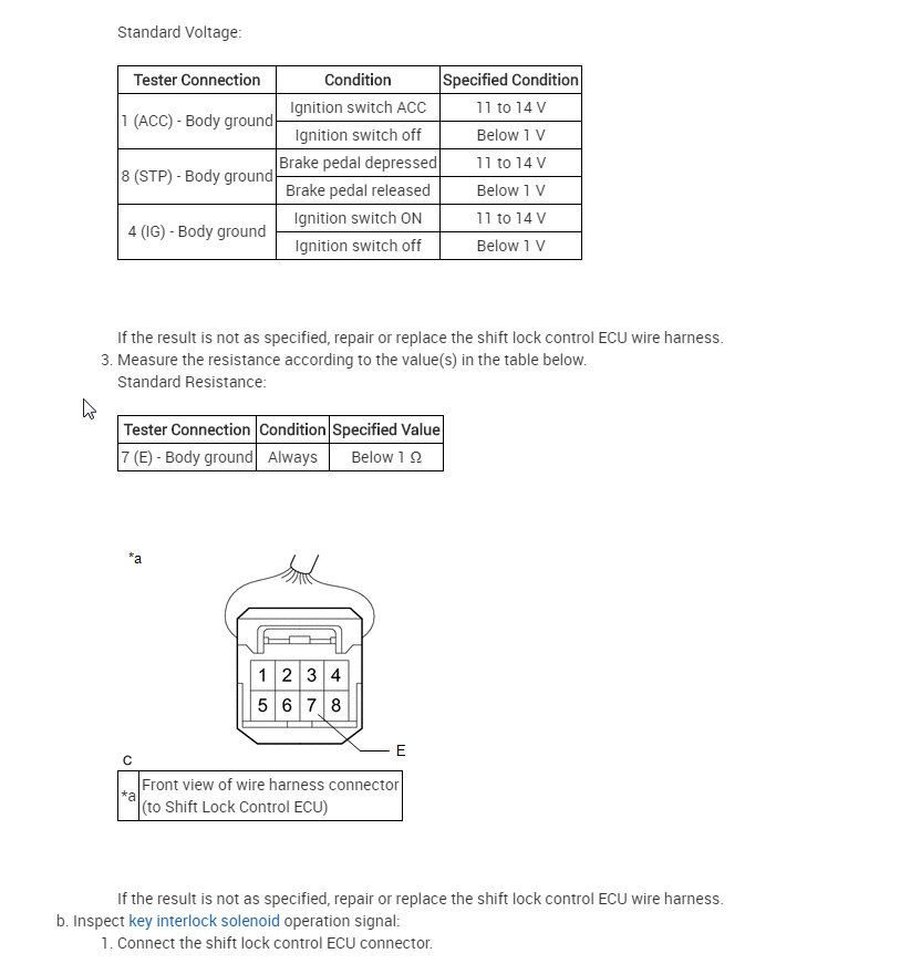

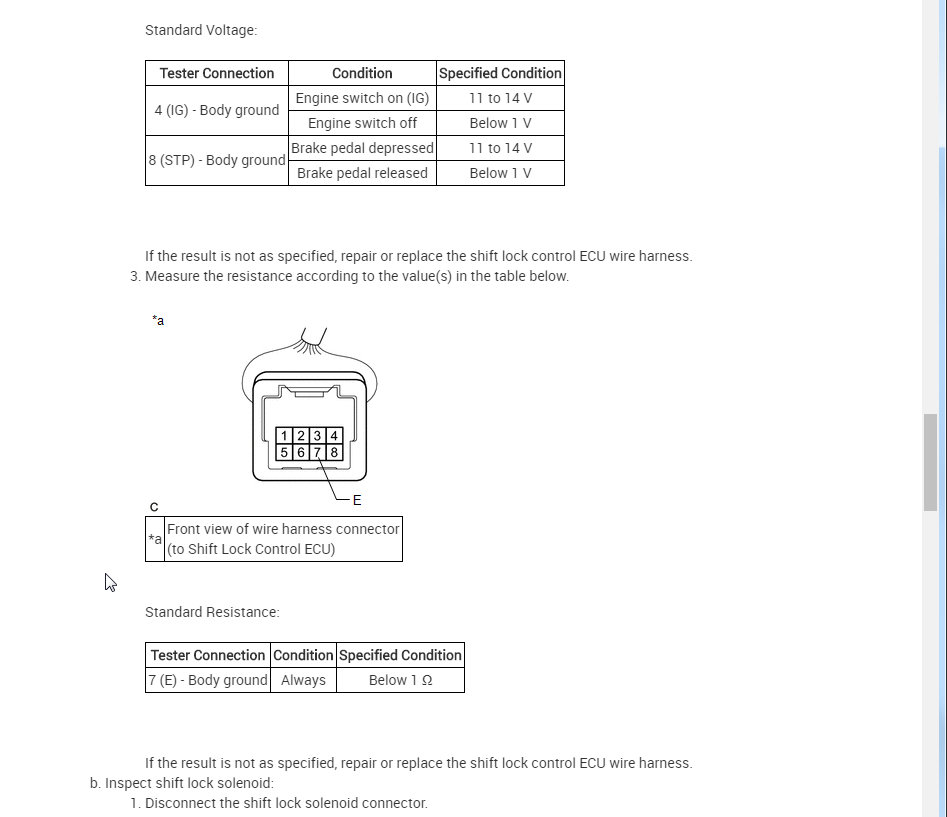

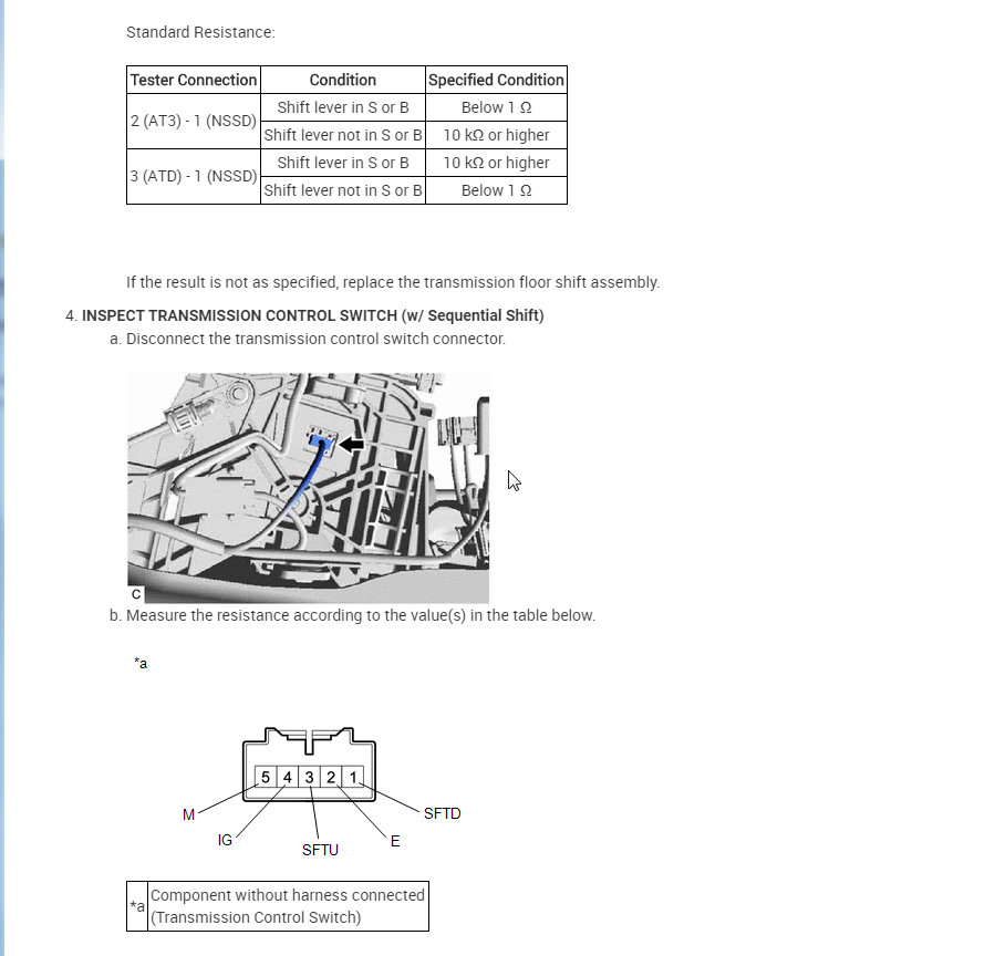

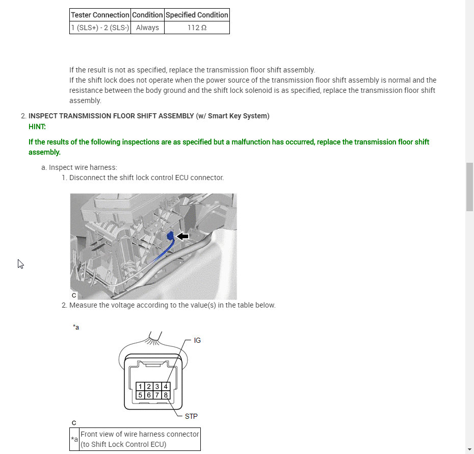

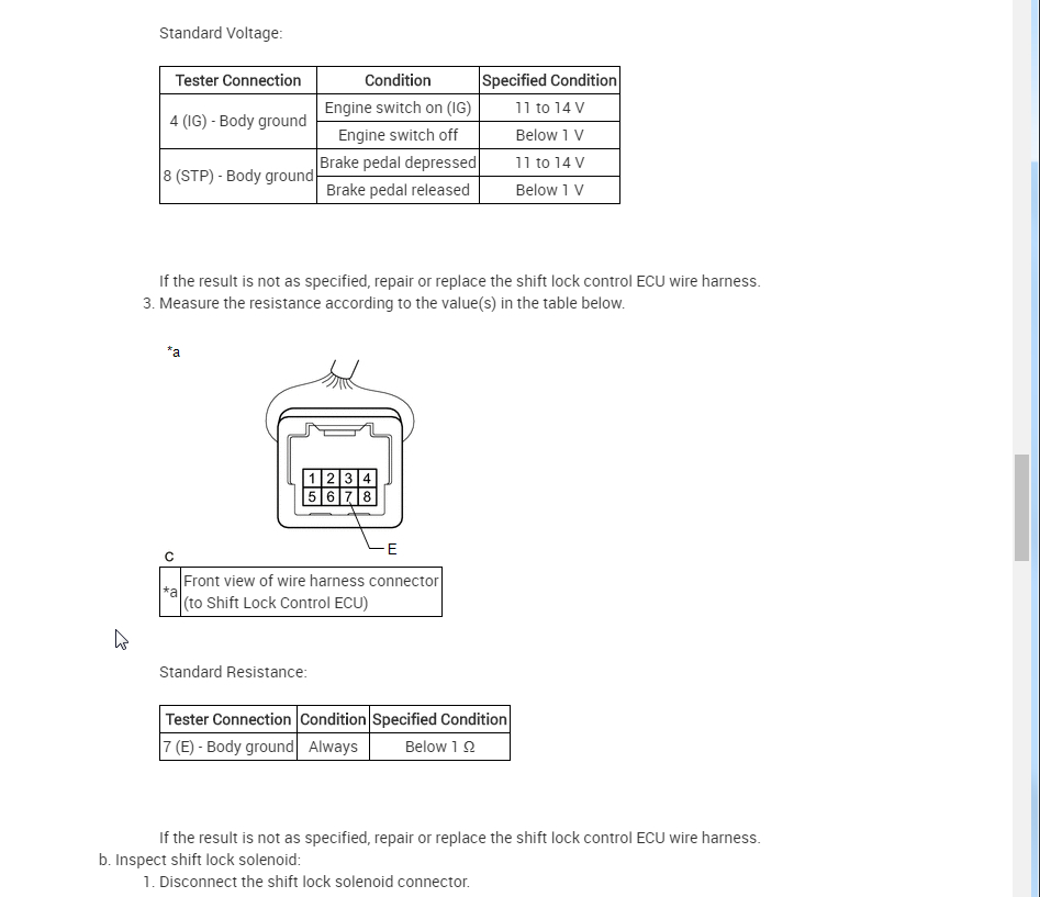

If not, then it will need to be replaced. I attached the testing for this if you want to run through the testing but it is rare that the issue is not the solenoid contacts itself.
Let me know if you have more questions. Thanks
