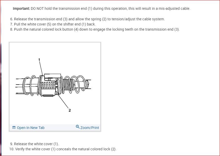

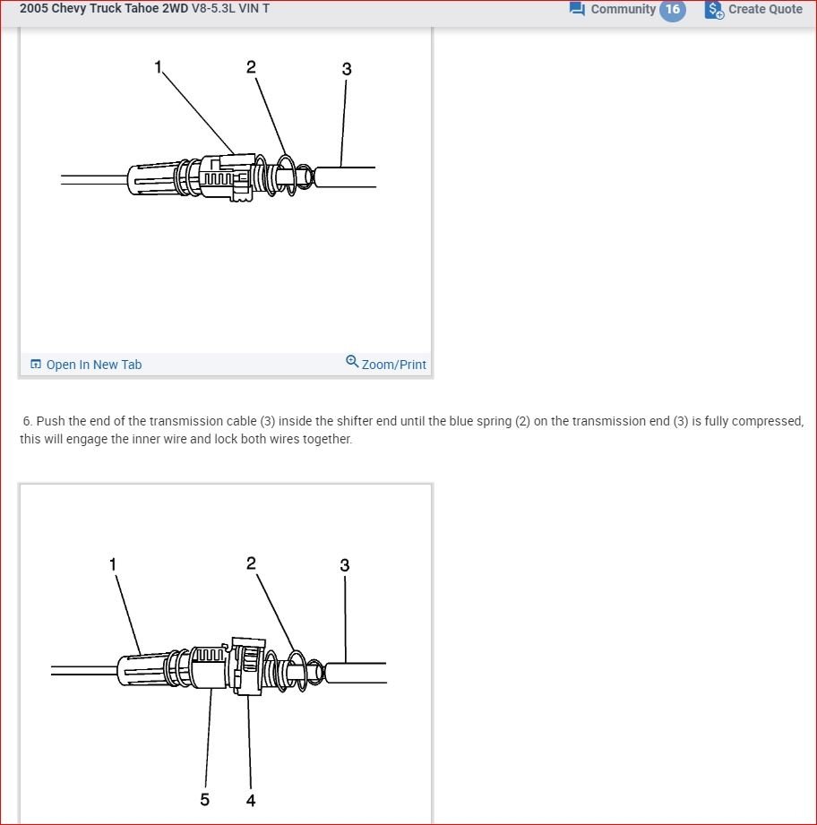

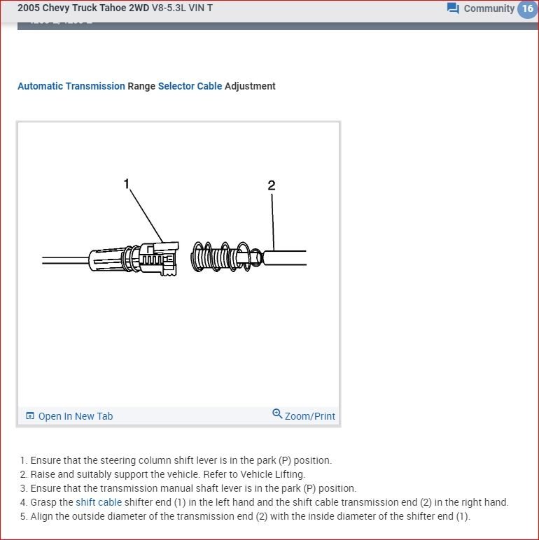

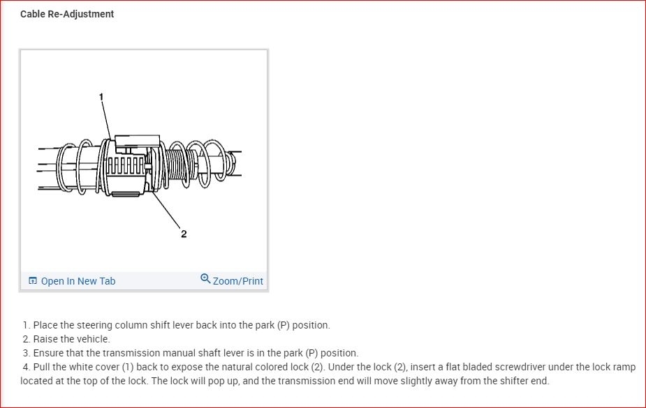

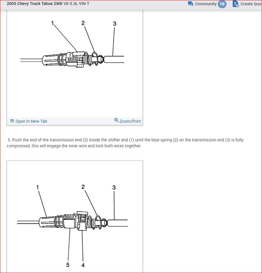

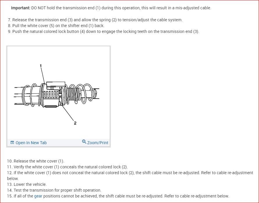

Hi John,
More than likely the shifter just needs to be adjusted. Here is the procedure. Run through this and let me know the results and if it doesn't resolve the concern then we can go from there. However, I think you will see a great improvement as long as there is no damage. Let me know and we can go from there. Thanks
