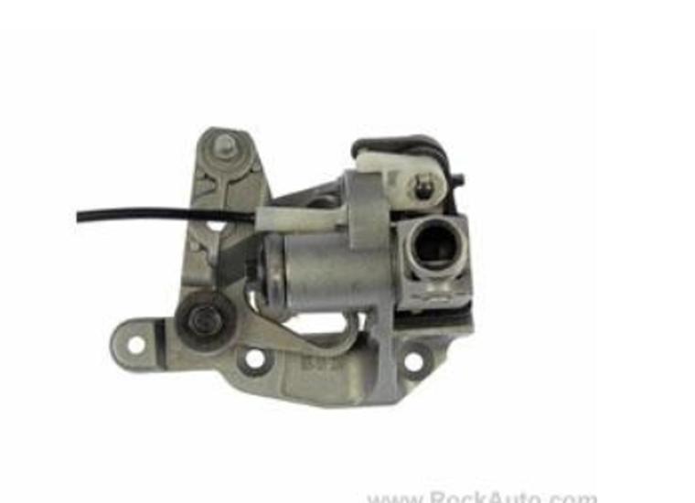

it may be the dorman assy that is not allowing you to shift correctly.or it was installed wrong but I kind of doubt that did you match it up with the one you replaced ? i'm sending a pic of the dorman part I looked up.
May 8, 2013 at 8:02 AM
MADMOOSE
  • 18 POSTS
Yes, that's the one. It does match up with the old one.
I suppose its possible I installed it wrong, but it's pretty straight forward - 3 torx screws to the column, shift cable and switch control snaps in the lever, and the ignition switch lock cable snaps into the ignition.
Anything I should look for on the Dorman that would be a problem?
May 8, 2013 at 3:13 PM
