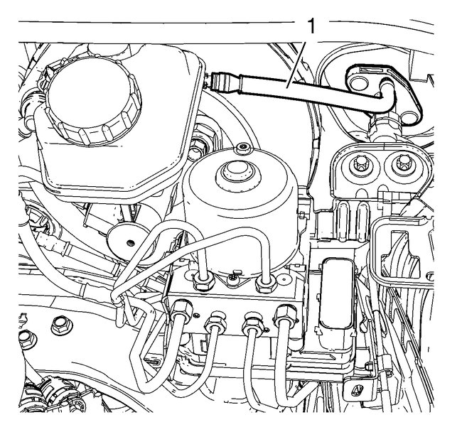

That tells me the clutch isn't releasing. Have you checked to make sure the clutch master cylinder is full of fluid? I believe this one uses brake fluid from the brake master cylinder.
See pic 1. Let me know if it is low. Also, let me know if the clutch pedal feels normal.

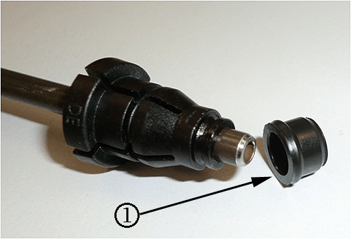

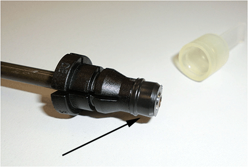

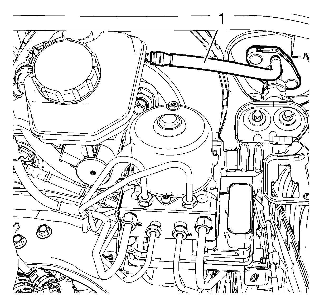

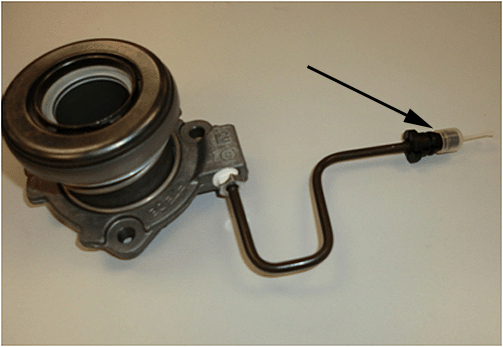

I came across a service bulletin related to a leak in the line to the actuator (slave). If you look at the attached pics, you will see the seal that is the issue. It could be a pressure loss in this case. Did you notice any leaks? Also, If you start the vehicle while holding the clutch and in gear, does it release normally?
I have to be honest, I don't think it is a bad clutch (it could be). Since it's not allowing you to shift only when the engine is running, I suspect it is related to either the clutch MC or the clutch actuator (slave cylinder).
Take a look at the attached pics. Check the seal shown to make sure there is nothing leaking.
