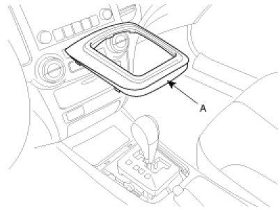

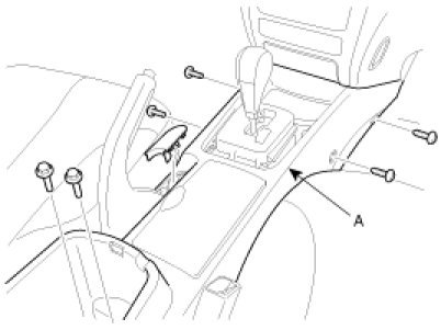

1. Remove the center console cover(A).
pic 1

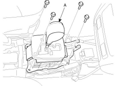

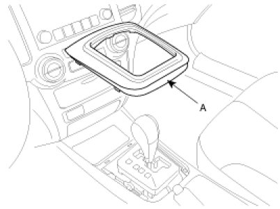

2. Remove the center console(A).
pic 2

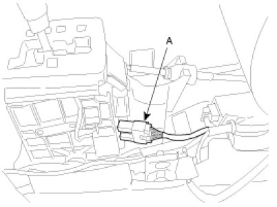

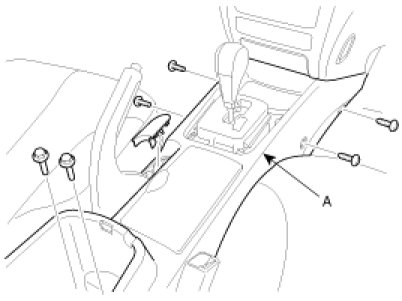

3. Disconnect the sports mode connector(A).
pic 3

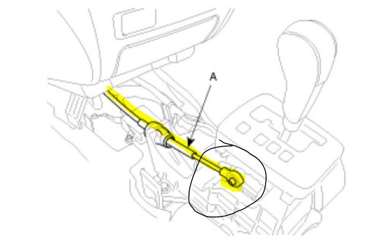

4. Disconnect the control cable(A).
pic 4

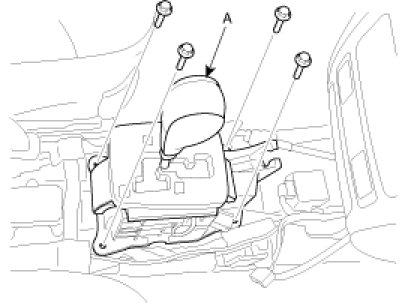

5. Remove the shift lever assembly(A) (Bolt : 4EA)
pic 5

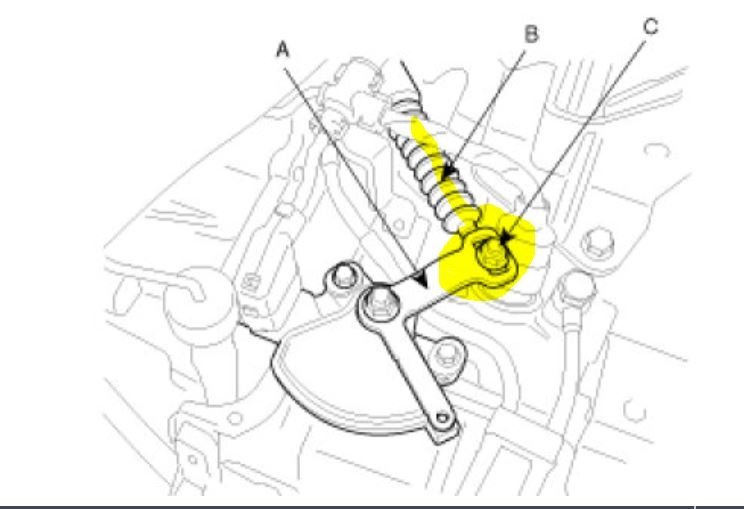

Now, if the cable is properly attached and in good condition, we need to check the other end which is mounted on the transmission. If you can, get a helper to move the shifter while you watch to see if it is actually moving on the transmission.
The last picture is of the cable on the transmission. The cable is located right next to the transmission dip stick (a little to the left of it).
