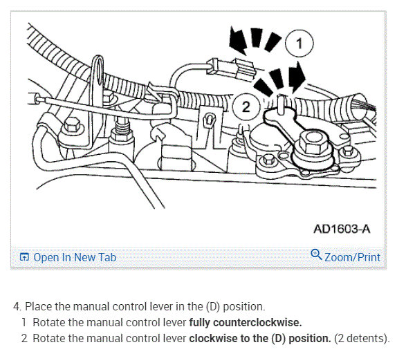

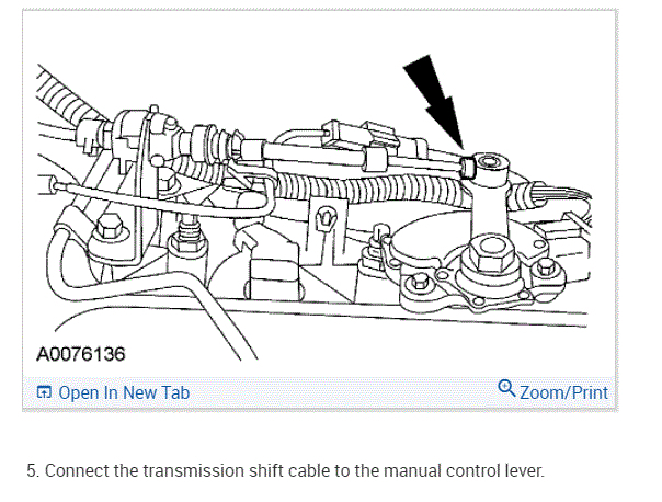

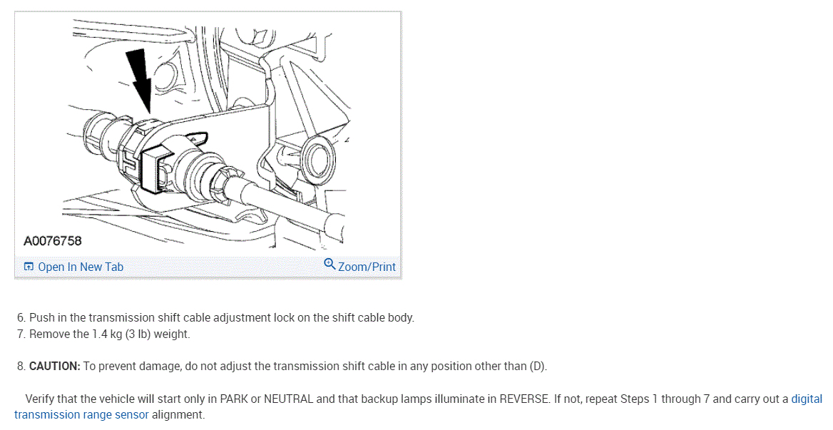

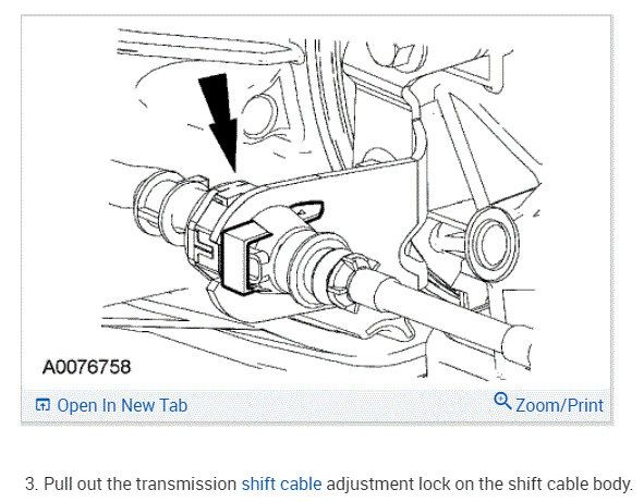

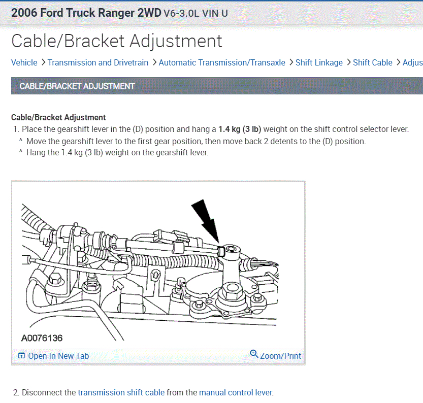

Is there a way to adjust the shift cable or a certain gear you should have it in when you hook it up? I recently swapped out my transmission and can't put it in park or first unless I manually do it on the transmission. I've already tightened up the shifter torx bolts so it's not a loose shifter.
