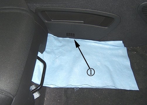

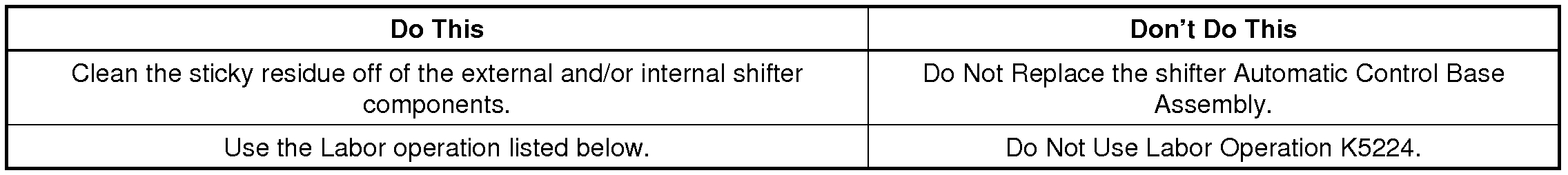

Correction
pic 1
Important
Do not use any solvent-based cleaning products as they may attack and compromise the integrity of the composite materials used in the control assembly.
1. Clean the external shifter control components including the shifter handle, bezel and the moving closeout panel using the cleaner listed below. Verify that the condition has been corrected. If the condition is not corrected, use the following steps.

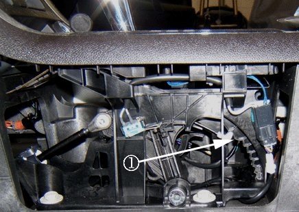

pic 2
2. Remove the left side console extension panel to access the automatic transmission control. Refer to Front Floor Console Extension Panel Replacement - Left Side in SI (1).

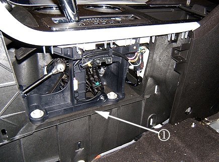

pic 3
3. Protect the floor carpet panels on both sides of the console base with absorbent towels to prevent staining from the liquid cleaner used in the following steps (1).

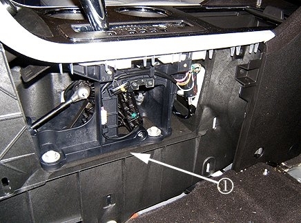

pic 4
4. Locate the stepped selector section and detent spring on the shifter assembly (Acadia, Enclave and OUTLOOK automatic transmission control shown (1)).
5. Clean the sticky residue from the surfaces of the stepped selector section and detent spring on the shifter assembly using the cleaner listed below. Keep the direct spray away from electrical components. Using a small brush, go over all of the working surfaces of the stepped selector and detent spring to loosen and remove all residue.
6. After thoroughly cleaning the components, wipe off the liquid with an absorbent towel.
7. A small amount of compressed air may be helpful to assist in drying the components and surrounding area. Use care not to spread the liquid on to adjacent interior components.
8. Verify the performance of the mechanical and electrical components after the cleaning procedures.
