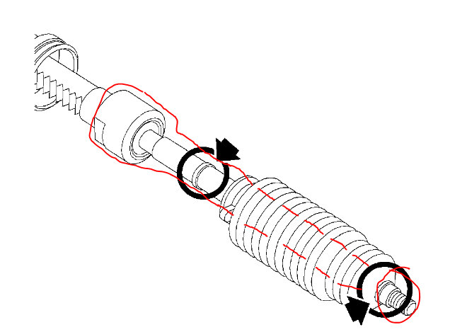

Also, when I first got the car about 6 months ago, I had to replace the front passenger side tie rod. Someone was telling me that some front wheel drive cars have 2 tie rods, an inner one and an outer one. I'm not sure if that's true but I know I only replaced one so could it be the other one if there is 2?
Jul 3, 2023 at 3:59 PM
Actually, there are two on each side of the vehicle. Both sides have an inner and outer tie rod. The inner is connected directly to the rack and pinion. The outer one goes to the steering knuckle.
If you question a tie rod, safely lift one side of the vehicle's front end. Place your hands at 3 and 9 o'clock. Wiggle the wheel back and forth to check for play.
I attached a pic below so you can get a better understanding of an inner tie rod. The outer tie rod connects to it. Then the inner goes through the boot at the end of the rack and pinion and attaches inside the boot.
Let me know if this helps.
See pic below.
