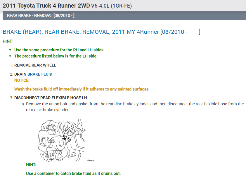

when driving over 40 mph and braking the 4runner grinds from the rear. Its terrifying to me and especially more so when my wife is driving. This cannot be safe can you show me how to do brakes on the back please? thanks
May 6, 2013 at 12:25 PM
DANNY L
  • 5,648 POSTS

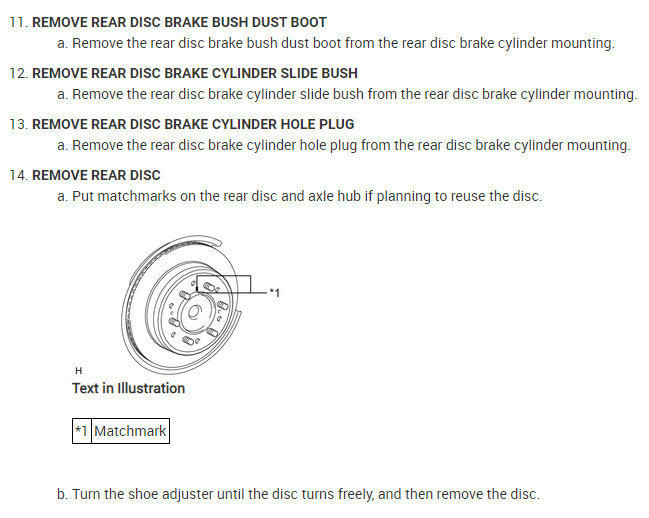

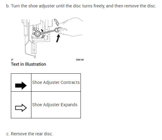

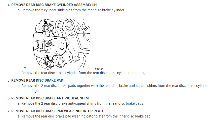

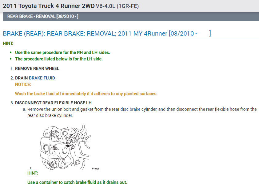

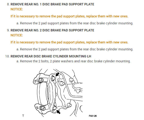

Here is a video to help you step by step with instructions in the diagrams below to show you how on your car.
https://youtu.be/r82BLijWuNQ
Here is a YouTube video from our site on how to compress the rear caliper piston when performing a rear brake job:
https://youtu.be/j8YwfSKEzZo

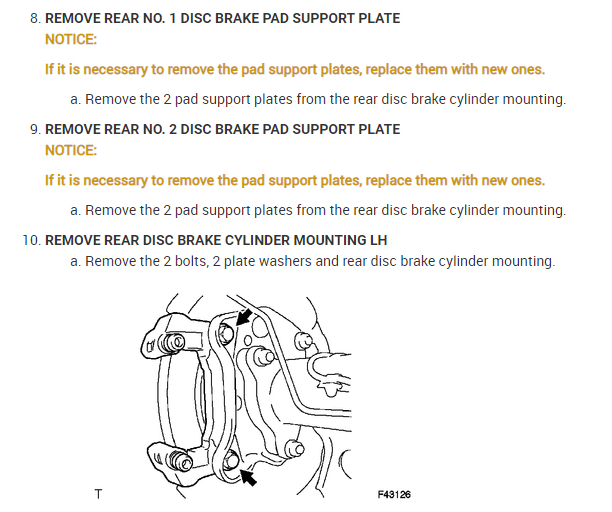

I've attached picture steps below on how to replace the brake pads on your truck. Hope this helps and thanks for using 2CarPros.
