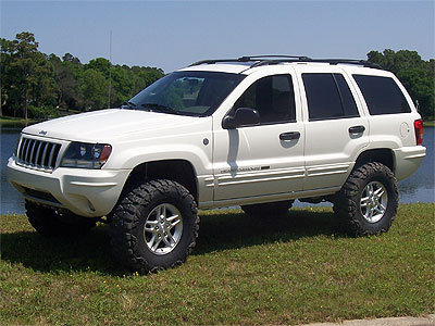

Sounds like the typical issue with 4WD, they don't get used regularly so the transfer case parts are still tight and bind up when used. To check the front shaft isn't hard, get the front of the Jeep on ramps or block it up so you can slide under it. Then just grab the shaft and see if it moves in any direction. Does your Jeep look like the one in the first picture? I forget that the Liberty in the US was called the Cherokee everywhere else. I ask because you show a 3.7 which was used in the smaller Jeep but the 4.7 was the common engine for the larger Grand Cherokee. Just want to be sure of the vehicle.

It's the 4.0 - 6 Cylinder.
Picture enclosed is what it looked like in it's better days. I plan on getting the vehicle in the garage today after work and will switch out the tires and check on those things you touched on.

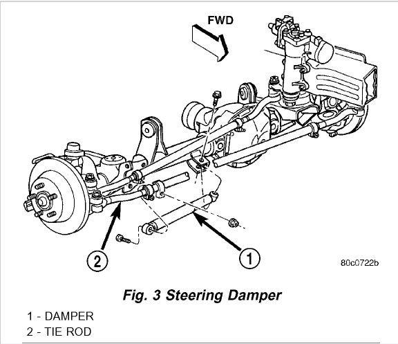

It could be an out of round tire, or one that has something in it but that should have changed with the rotation. You mentioned a LCA boot? Did you mean the bushing itself is damaged, Is it the front one or the one at the body? What shape is the steering dampener in? To test it you can unbolt the shaft end, then try stretching it and pushing it together. It should be stiff in both directions and have no play between directions, even as little as 1/4 inch can cause unwanted problems. I've seen those fail in a month if the roads are real rough. I normally upgrade them if there is even a doubt, the MOOG SSD107 is a larger unit than stock and seems to last a bit longer if you'rs fails testing.
