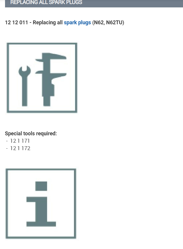

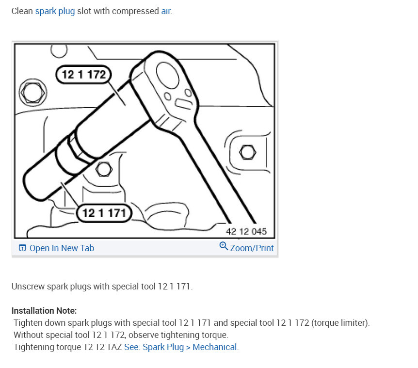

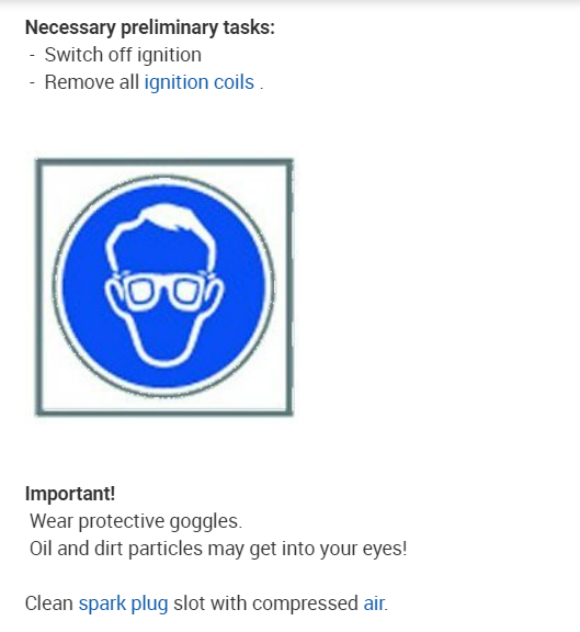

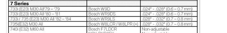

I would start by checking the spark plugs and the engine compression. Here are the spark plugs you should use and a guide to help you do the compression test. This generic guide will help walk you through the steps for the spark plug change with instructions below for your car.
https://www.2carpros.com/articles/how-to-change-spark-plugs

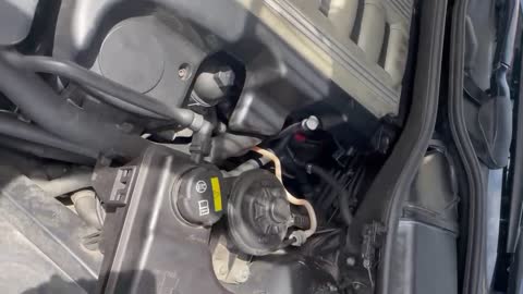

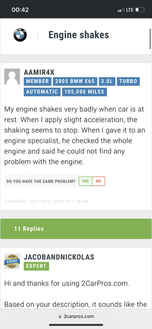

I once uploaded a video. It's a 2006 diesel 730D and a user here had the same problem. Error code in error memory is: 4BD2 Ars Torque Limitation.
Oct 28, 2022 at 3:42 PM

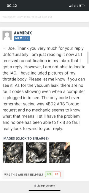

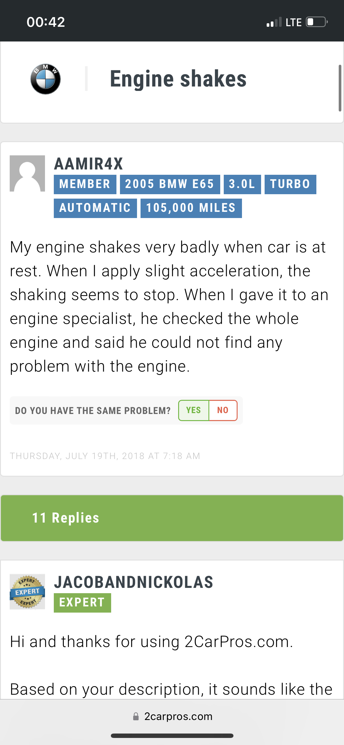

HT35
Here are screenshots of the user I mean.
Oct 28, 2022 at 3:47 PM
Yep, that is not running correctly. I would test the engine for vacuum leaks when it is cold only.
Here is a guide to help:
Please go over this guide and report back.
