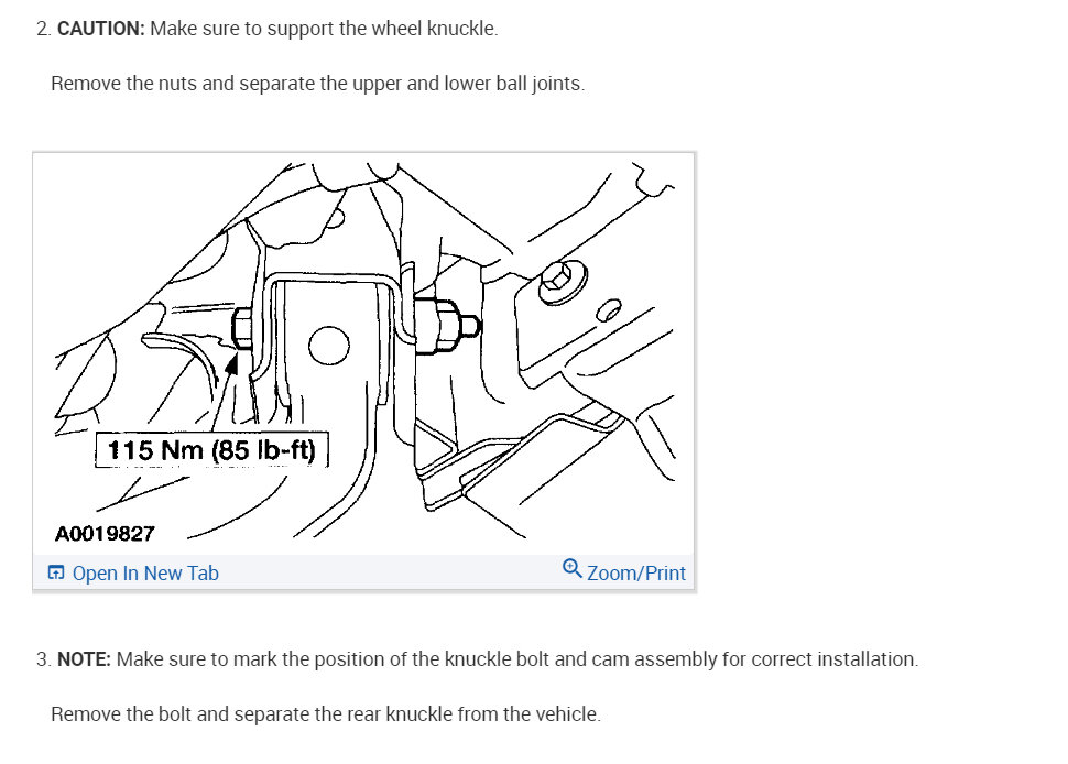

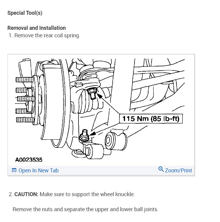

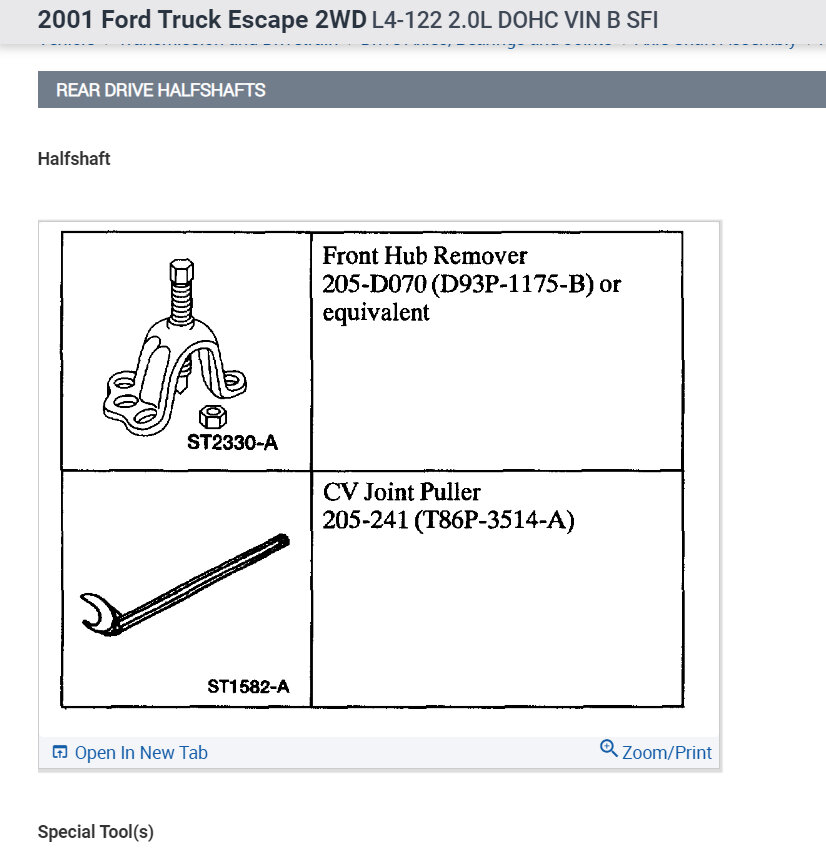

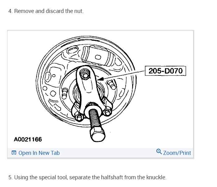

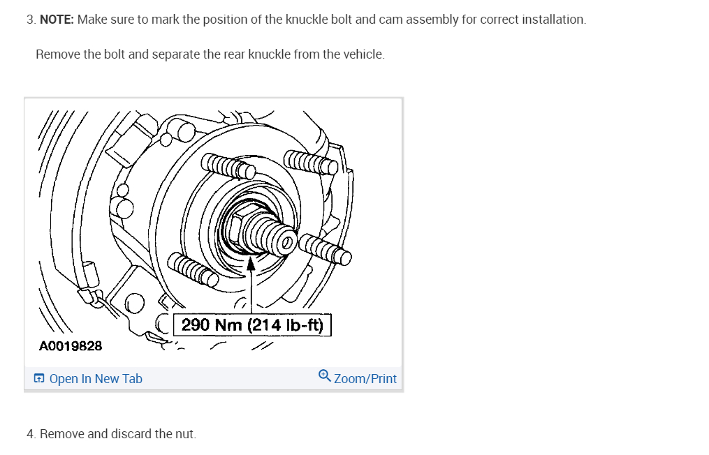

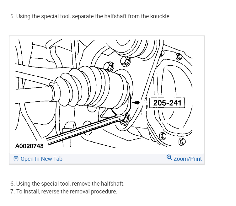

I have seen the CV axles cause these issues. When the CV joint wears out it will not transfer the torque of the engine smoothly. Here is a guide so you can see how the parts work and I have included the replacement instructions in the images below in case you need them.
