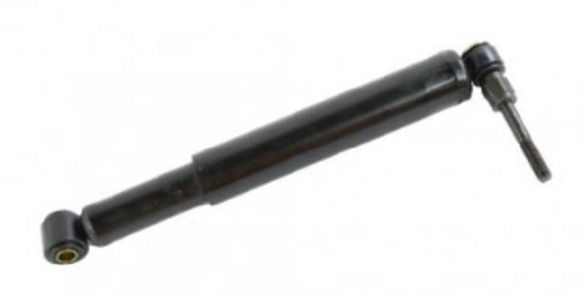

In your case, unless the vehicle has just been aligned, caster did not change on its own. Something else had to change when this problem started occurring. The most likely suspect for that is the steering damper. That looks like a regular shock absorber, except unlike a shock absorber, steering dampers extend and retract with equal force in both directions. (Shock absorbers need a lot of force to pull apart. That helps prevent tires from dropping into potholes, and they retract very easily so tires going over bumps don't shove the body up and cause an uncomfortable ride).
The steering damper is shown in this photo. It is connected on one end to the steering linkage, and on the other end to the frame or cross member. You can usually see it if you lay on the ground under the front bumper. Diagnosis mainly consists of inspecting it for signs the oil has leaked out. It will be wet, or the oil will have dried off after the assembly became caked with mud and road dirt. Once that oil has leaked out, it can't perform its damping function. It is also possible for them to be punctured when driving off-road, although that damage is also usually accompanied by dents to the assembly that prevents smooth and free movement. You'll feel that as binding in the steering system.
