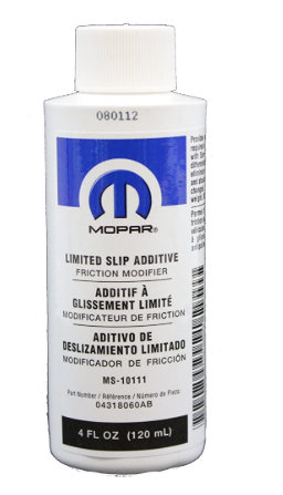

If we just changed tires then we need to change the other two to match and retest or we may have to change all four. Please let me know and we can go from there. We can try adding some friction modifier to the T-case but that is only after we fix the tires.
