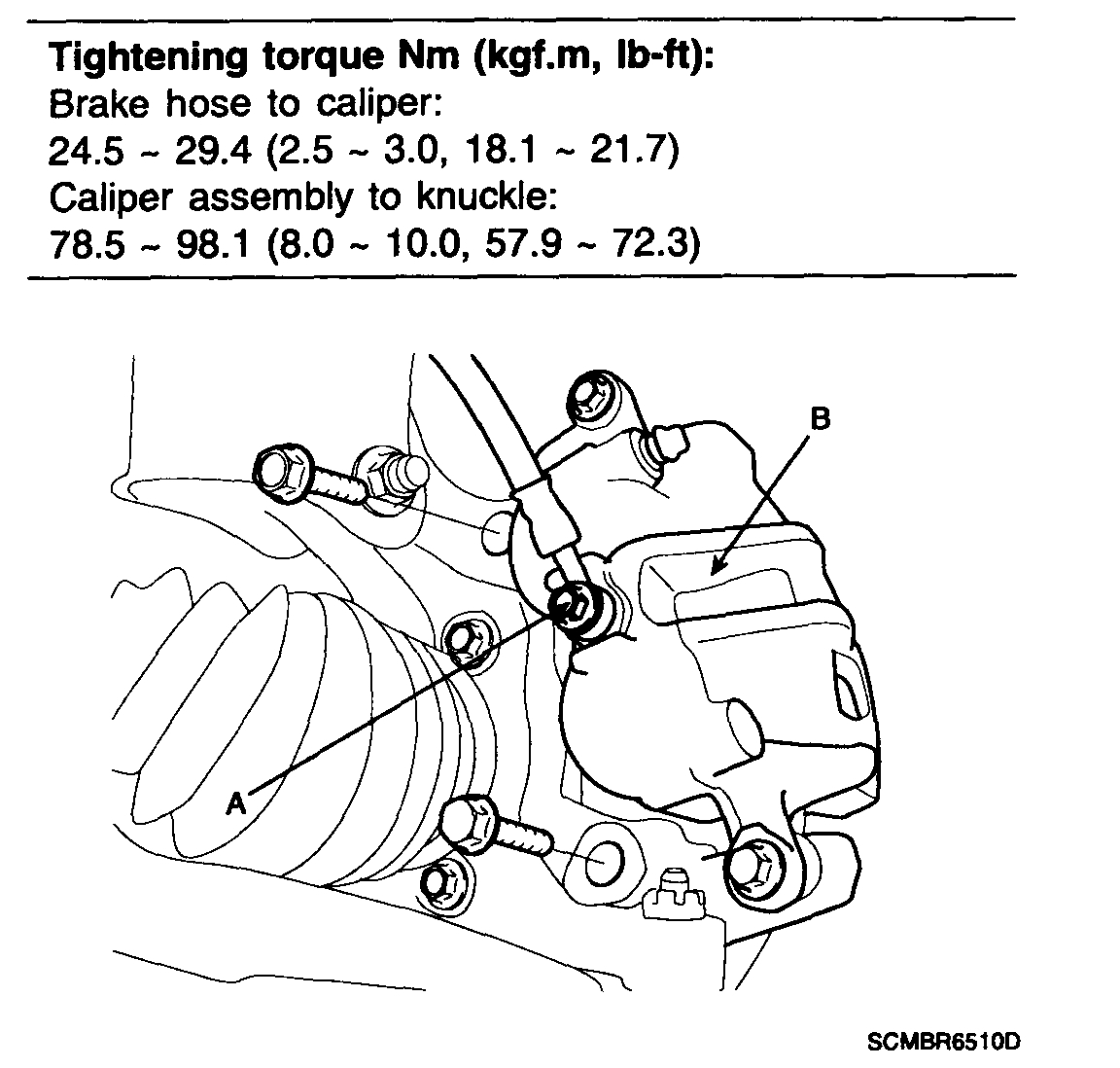

Replacing front brake pads and rotors isn't too hard to do. Since they usually last around 25,000 miles, you can get lifetime parts and never have to pay for parts again.
Let's get started. First, here is a link that shows in general how it's done. You can use this as a guide when working on your vehicle:

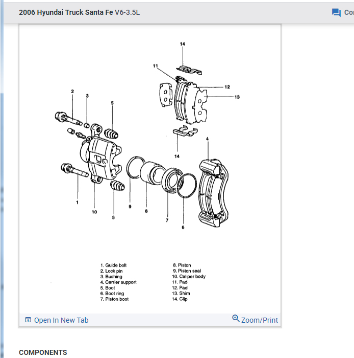

Here are the directions specific to your vehicle. The pics below correlate with the directions.

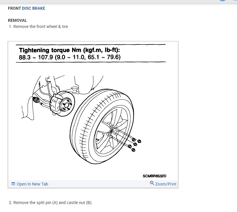

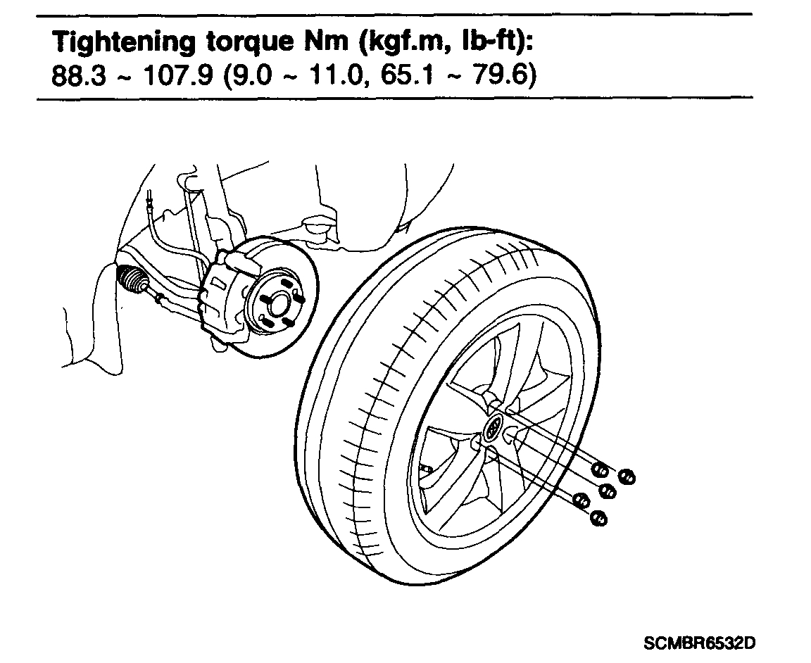

FRONT DISC BRAKE

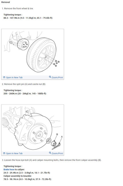

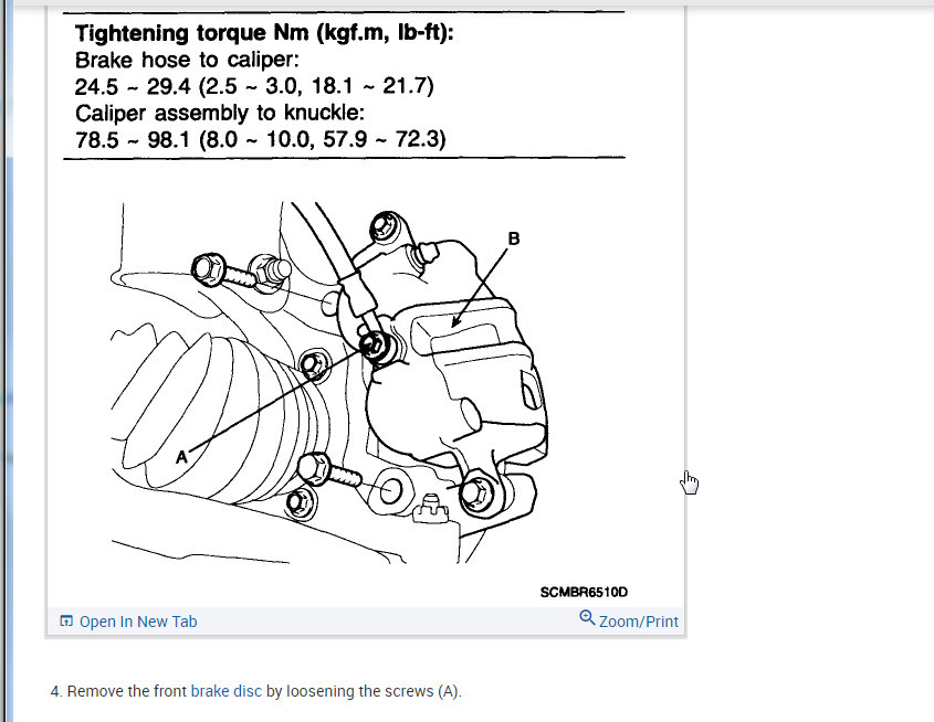

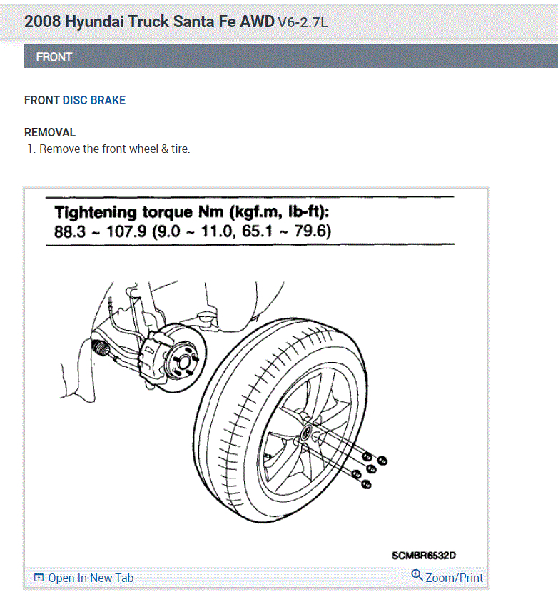

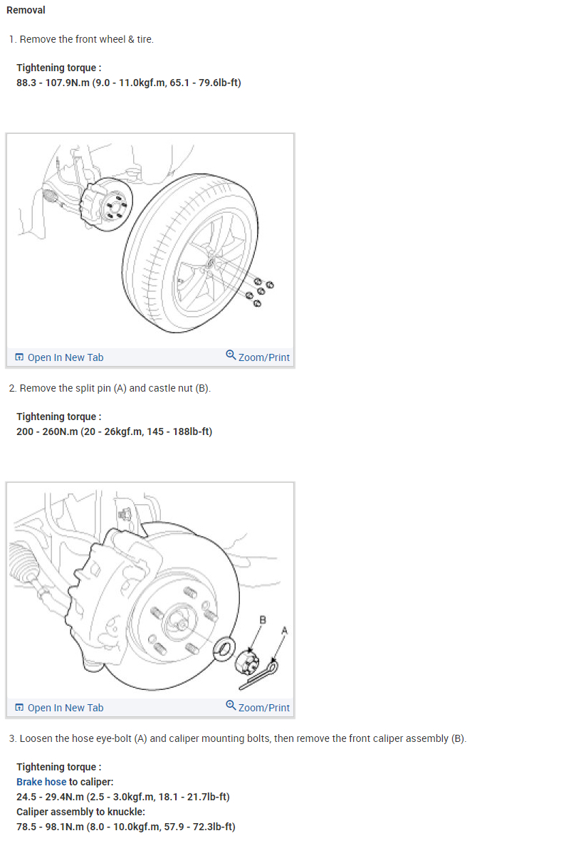

REMOVAL

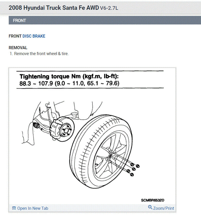

1. Remove the front wheel & tire.

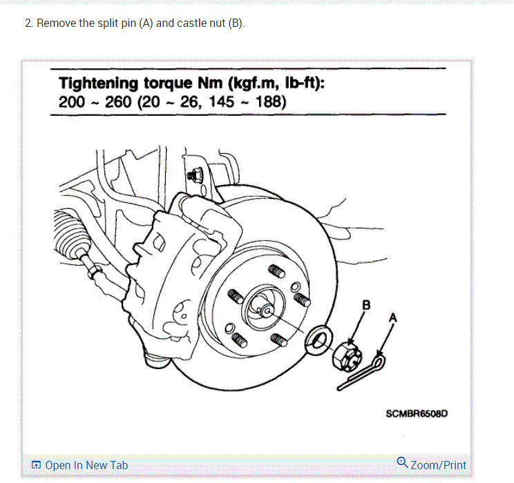

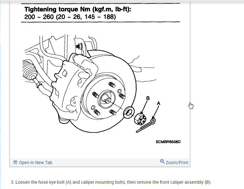

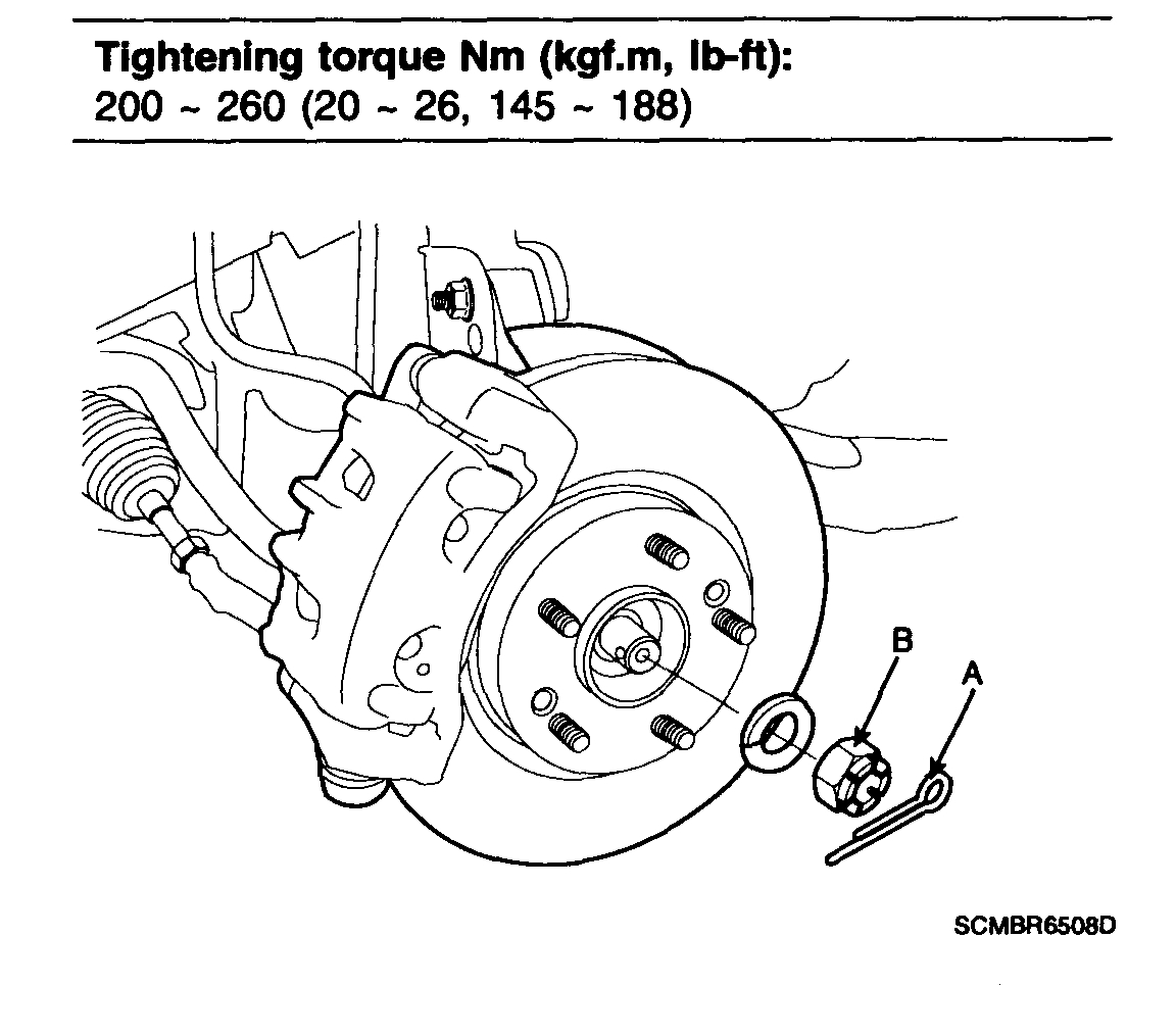

2. Remove the split pin (A) and castle nut (B).

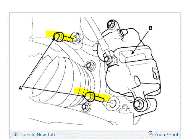

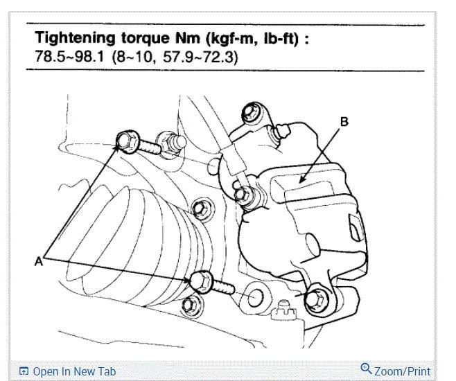

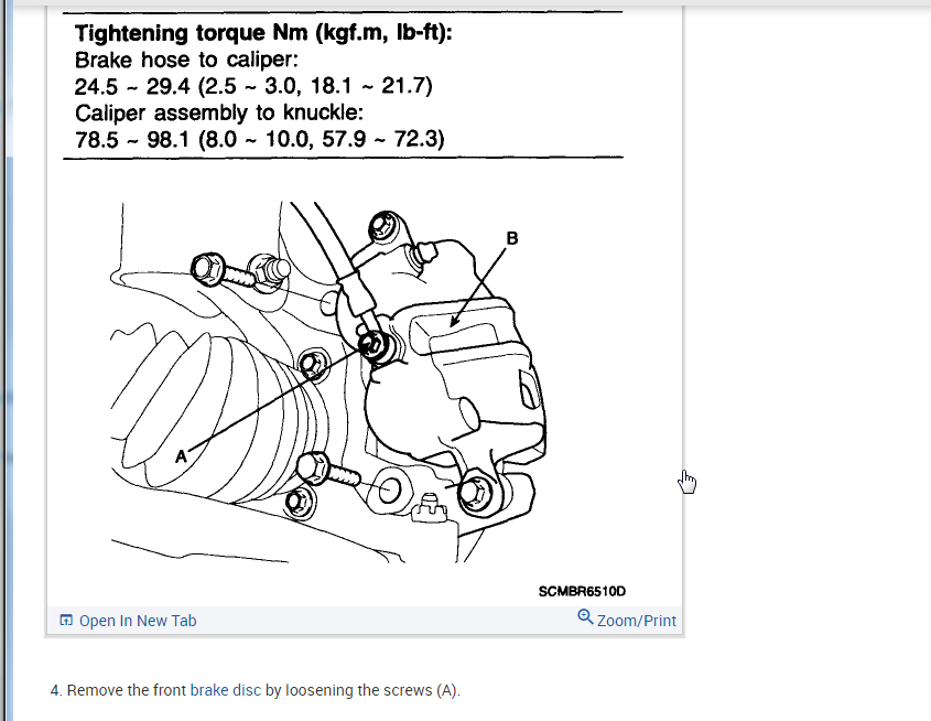

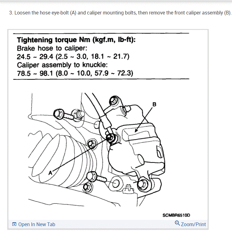

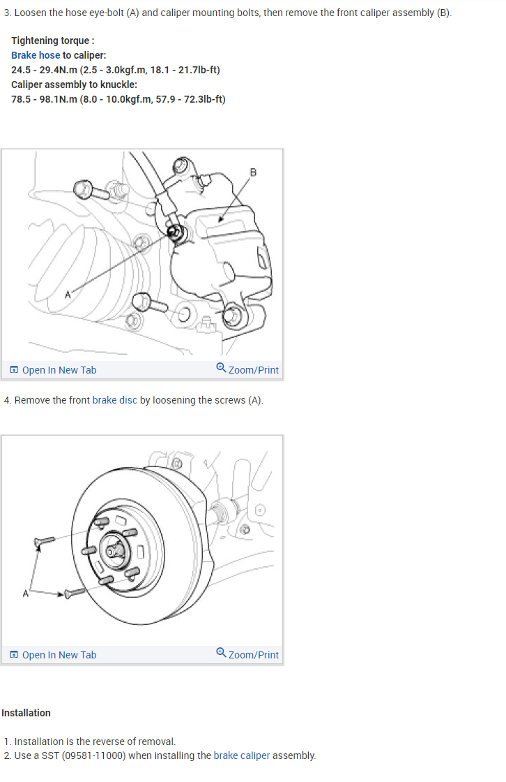

3. Loosen the hose eye-bolt (A) and caliper mounting bolts, then remove the front caliper assembly (B).

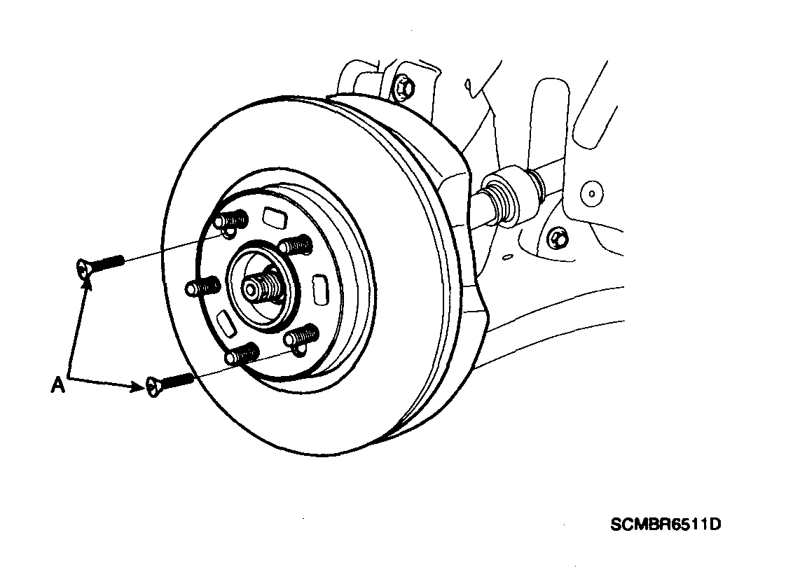

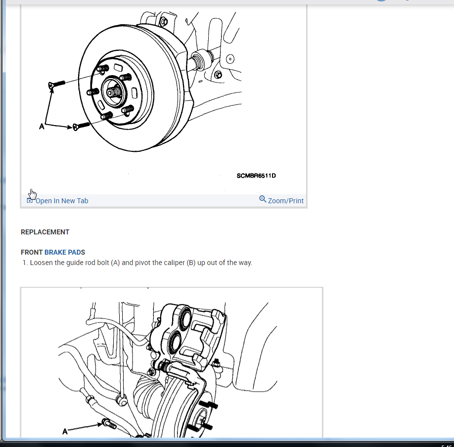

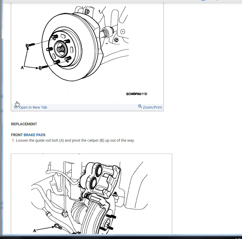

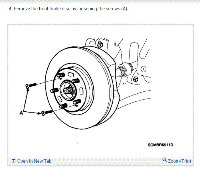

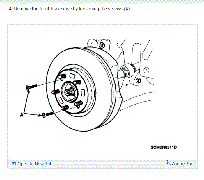

4. Remove the front brake disc by loosening the screws (A).

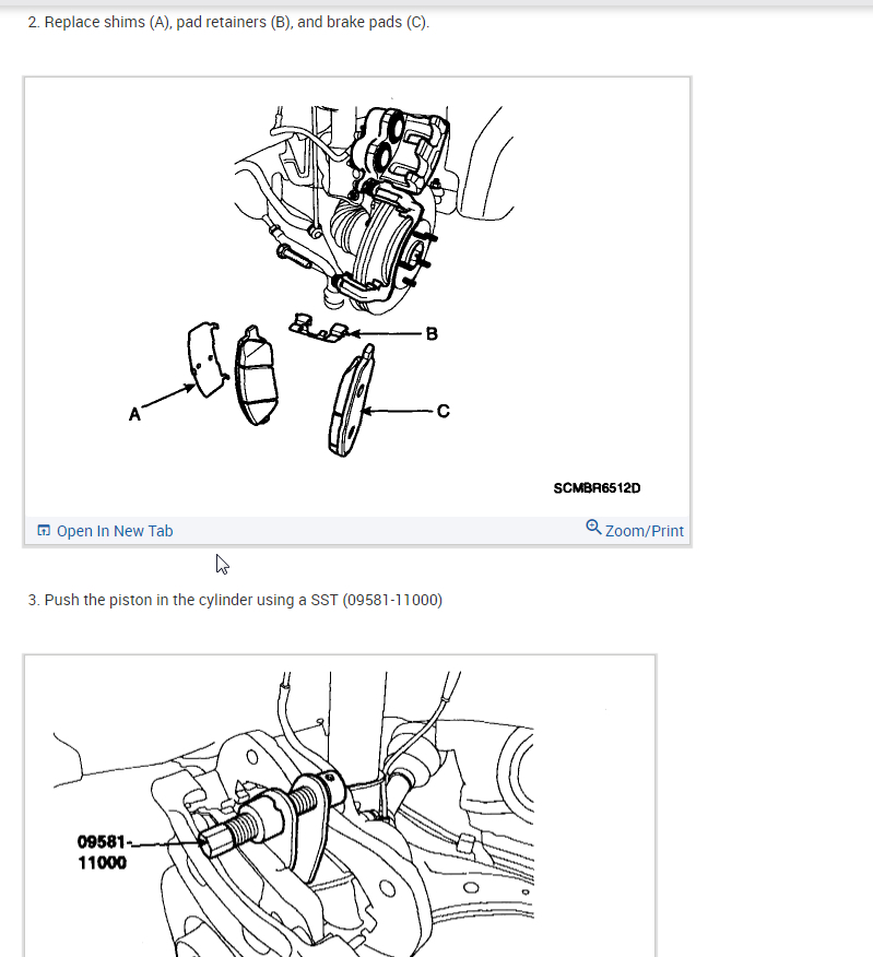

REPLACEMENT

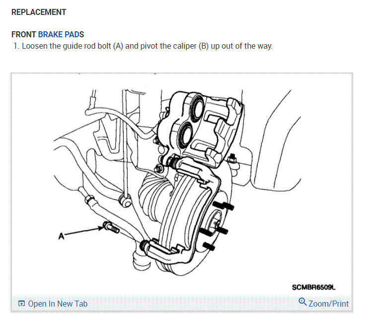

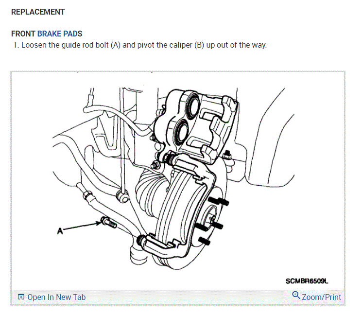

FRONT BRAKE PADS

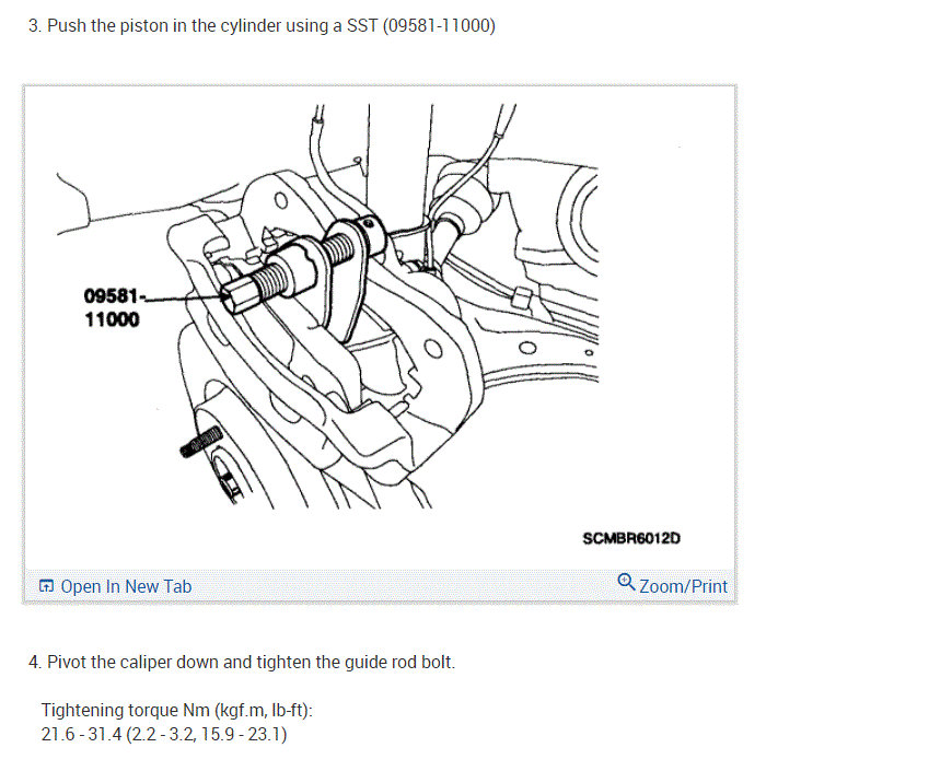

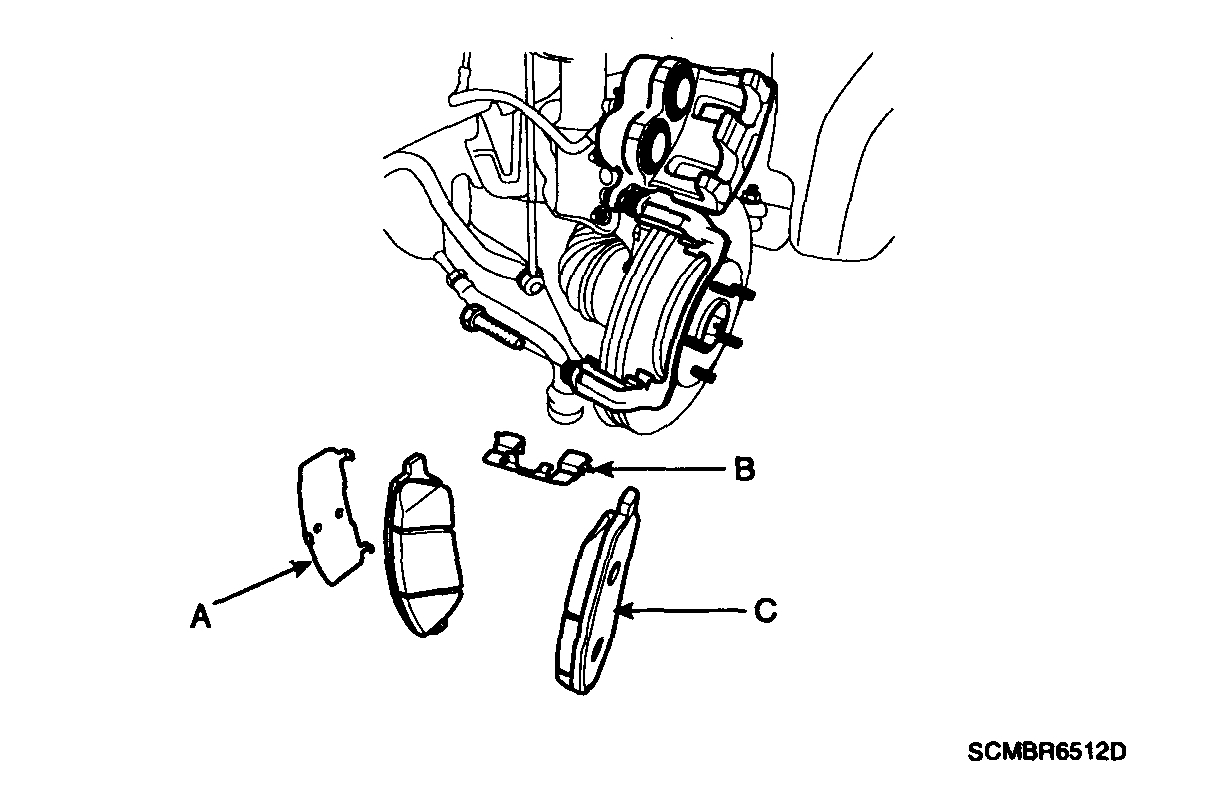

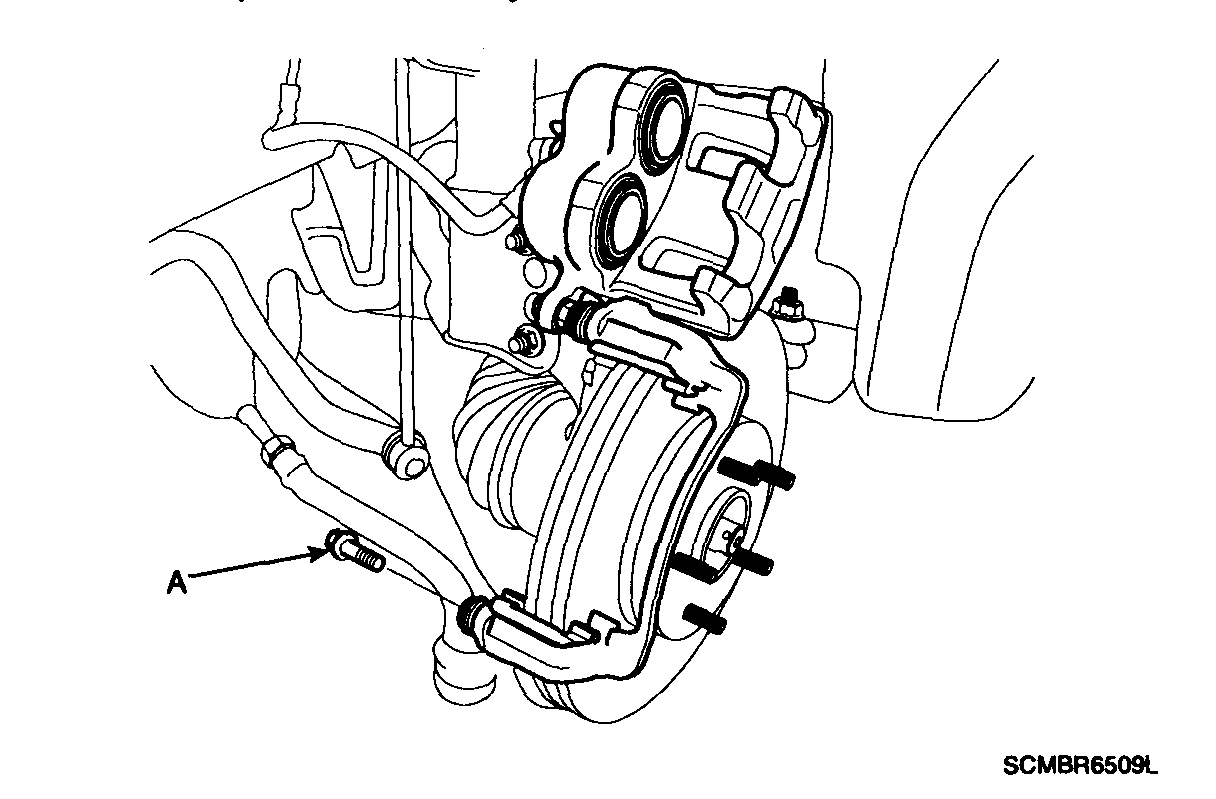

1. Loosen the guide rod bolt (A) and pivot the caliper (B) up out of the way.

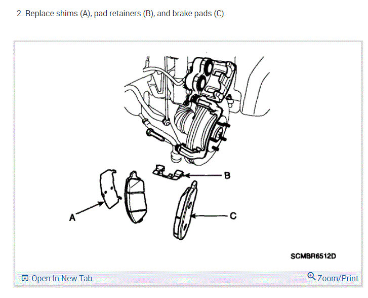

2. Replace shims (A), pad retainers (B), and brake pads (C).

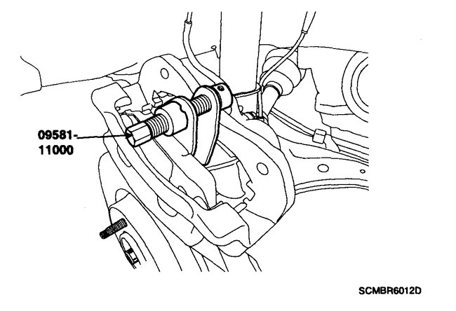

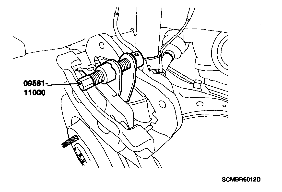

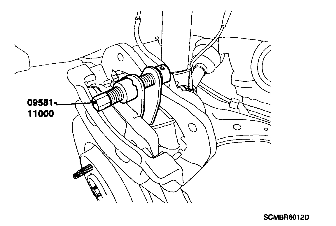

3. Push the piston in the cylinder using a SST (09581-11000)
4. Pivot the caliper down and tighten the guide rod bolt.
Tightening torque Nm (kgf.m, lb-ft):
21.6 - 31.4 (2.2 - 3.2, 15.9 - 23.1)

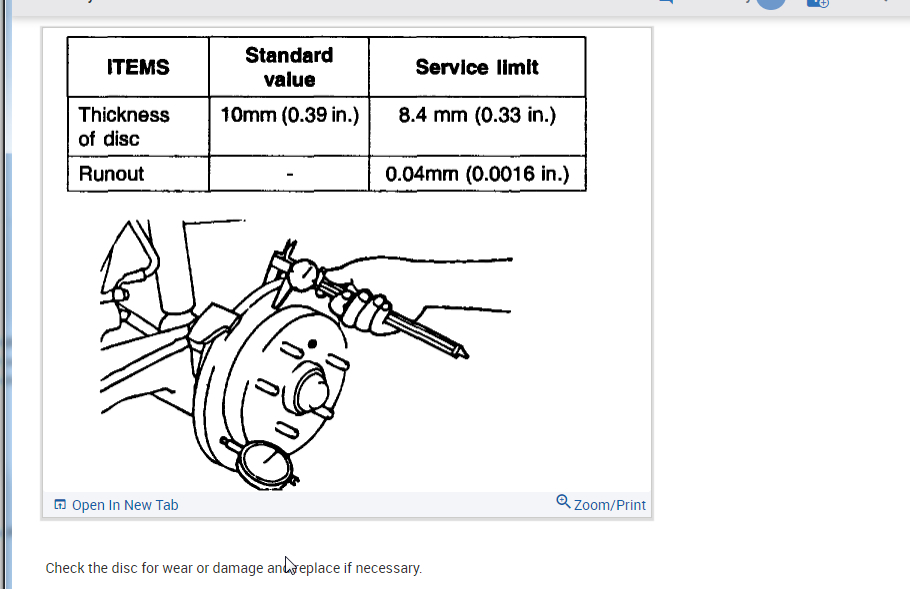

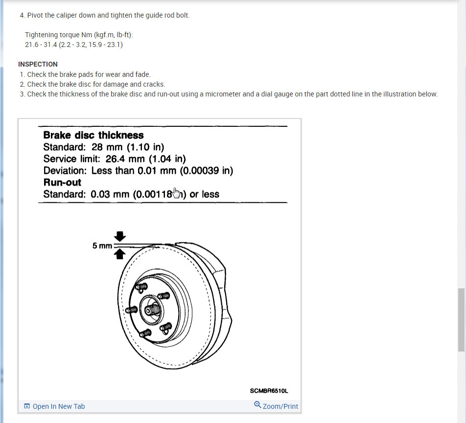

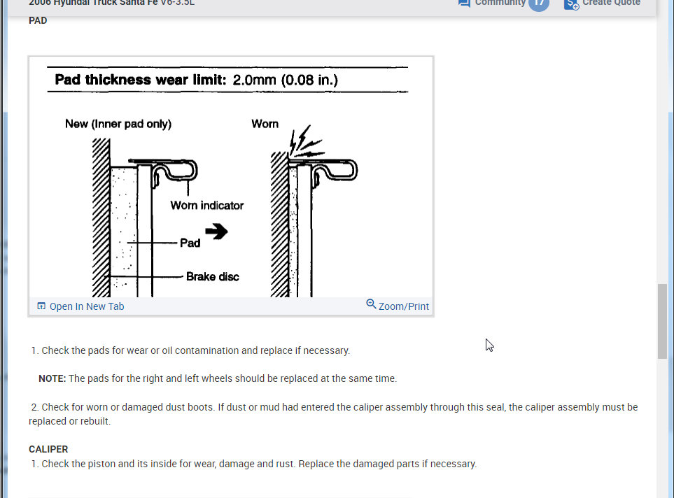

INSPECTION

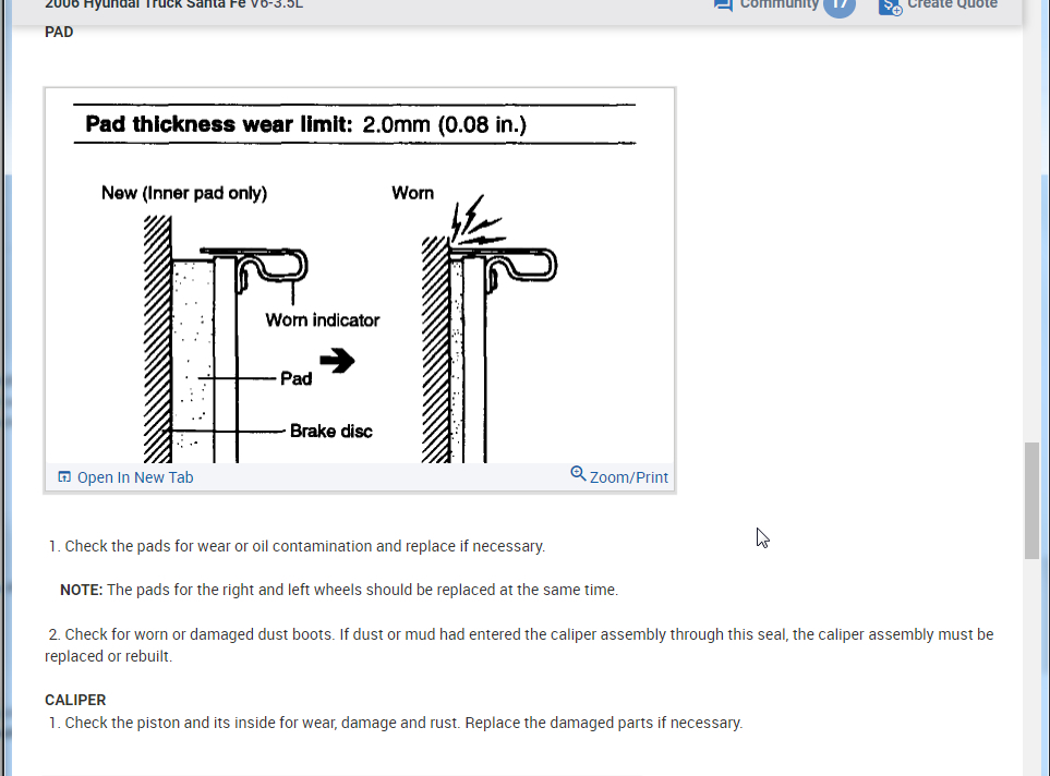

1. Check the brake pads for wear and fade.
2. Check the brake disc for damage and cracks.

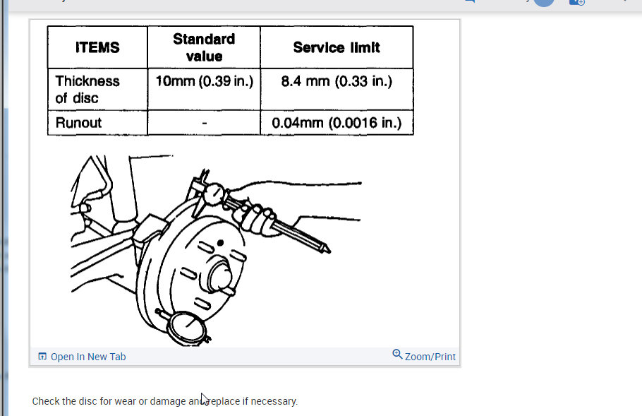

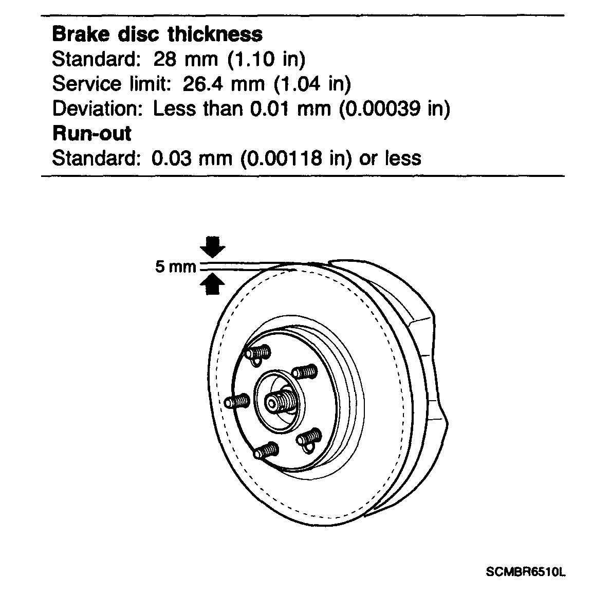

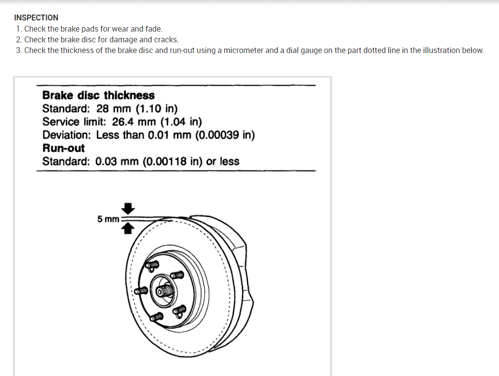

3. Check the thickness of the brake disc and run-out using a micrometer and a dial gauge on the part dotted line in the illustration below.

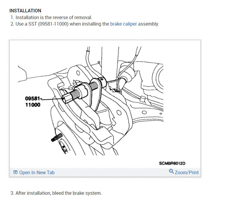

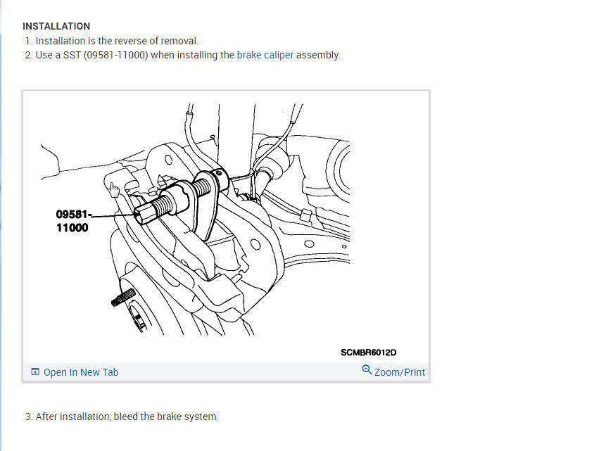

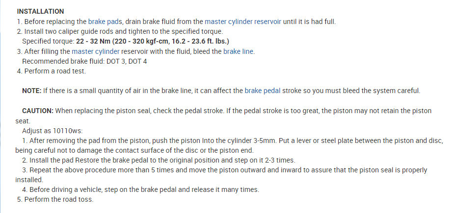

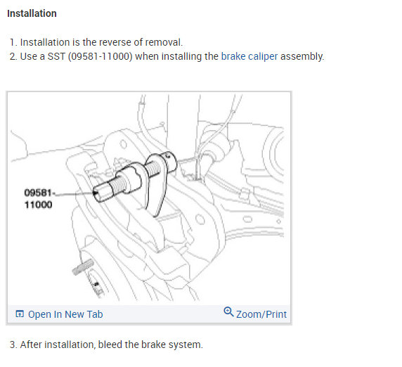

INSTALLATION

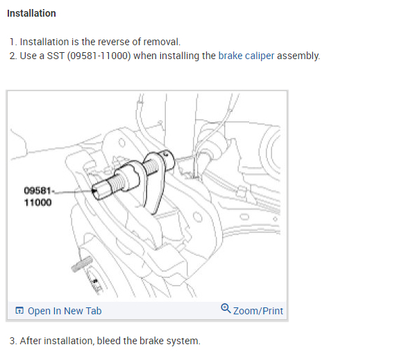

1. Installation is the reverse of removal.

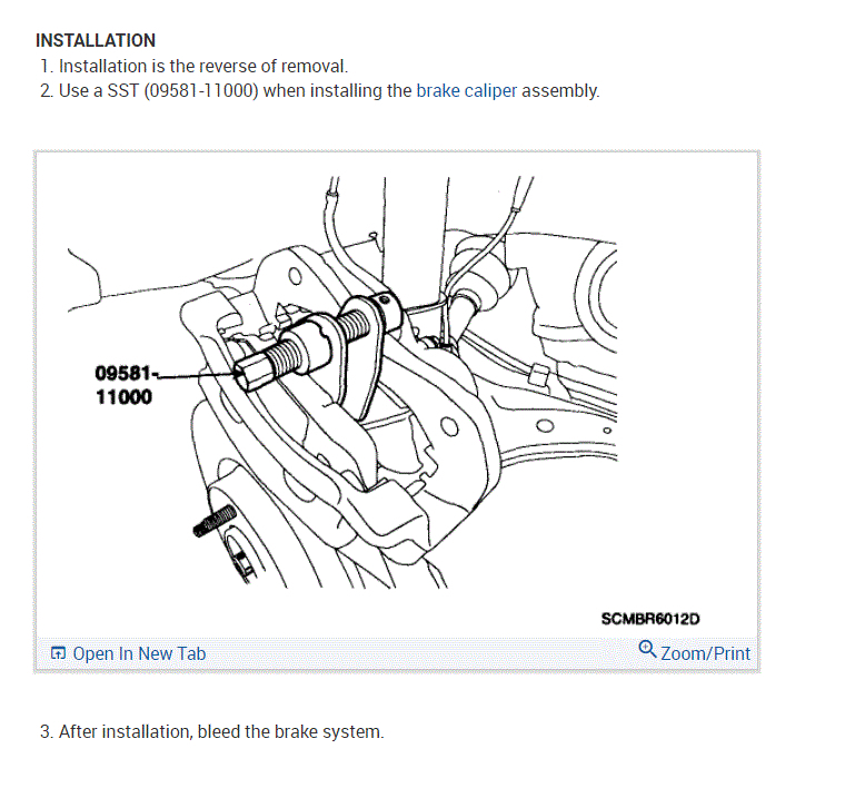

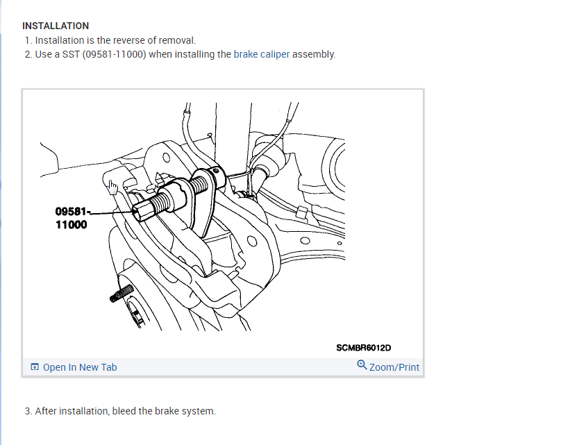

2. Use a SST (09581-11000) when installing the brake caliper assembly.
3. After installation, bleed the brake system.
Check out the diagrams (Below). Let us know what happens and please upload pictures or videos of the problem.
Mar 29, 2021 at 1:33 PM (Merged)

If you look at the pics below, they include the directions and pictures specific to your vehicle for this job.

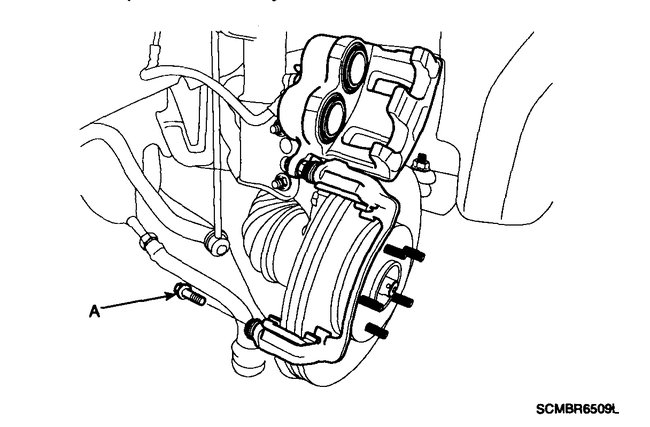

To remove the brake rotors, you will need to remove the caliper mounting bracket while the caliper is off. See the last two pics for the bolts to be removed and torque specs.
PS: See pics below for directions.

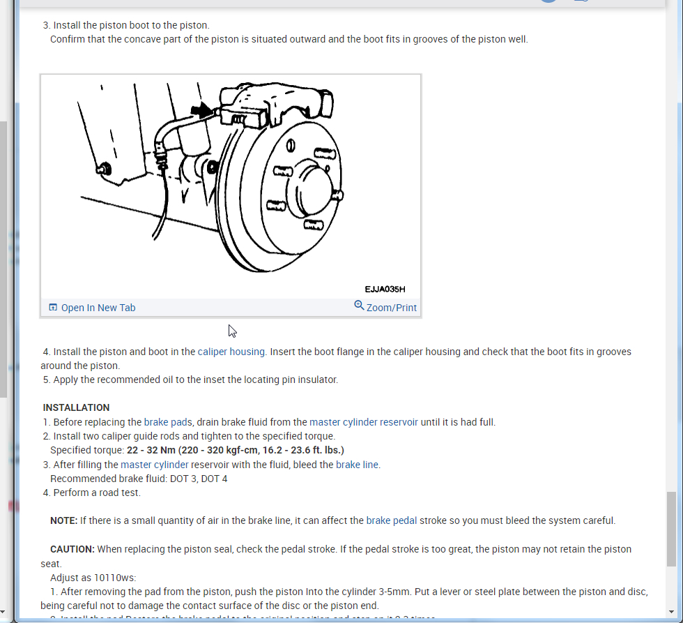

If you are just replacing the brakes and rotors, there is no need to bleed the system. As far as the rotors, if you feel the shaking in the steering wheel, chances are only the front rotors are warped.
Mar 29, 2021 at 1:34 PM (Merged)
