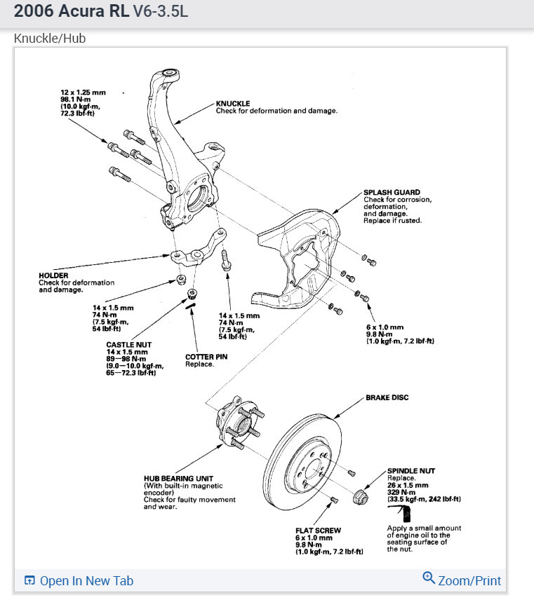

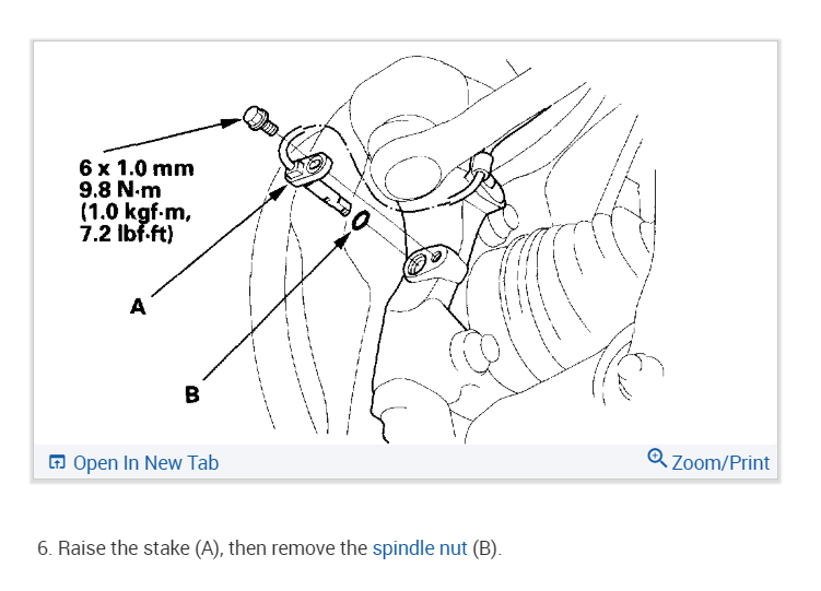

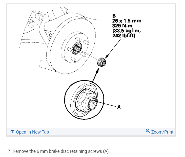

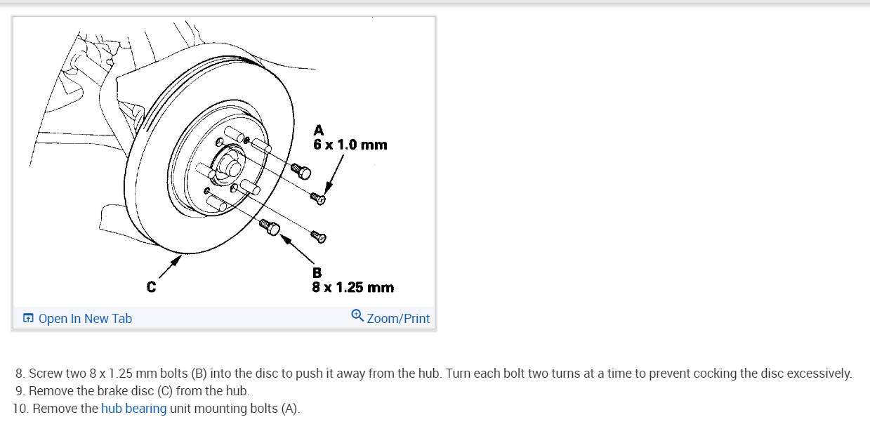

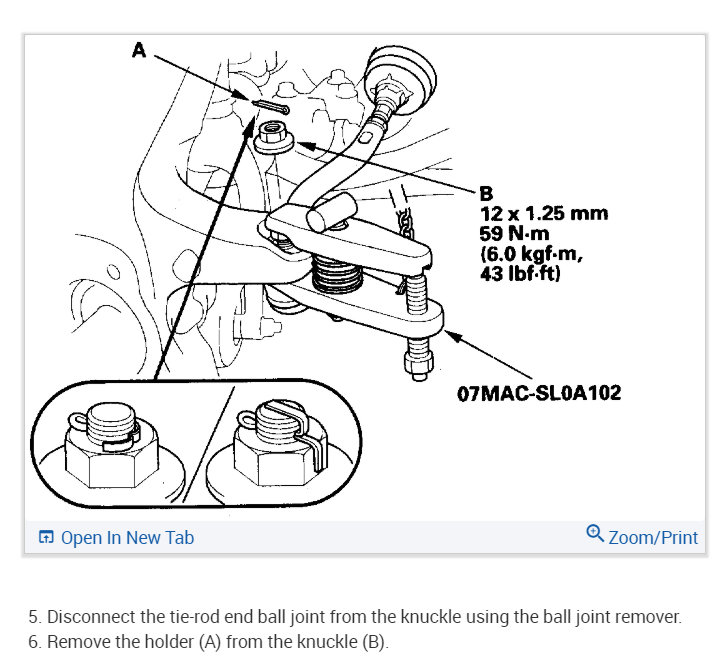

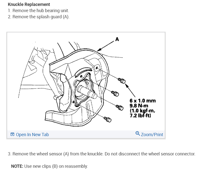

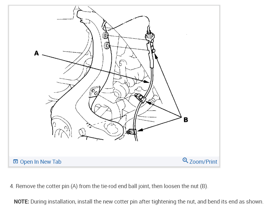

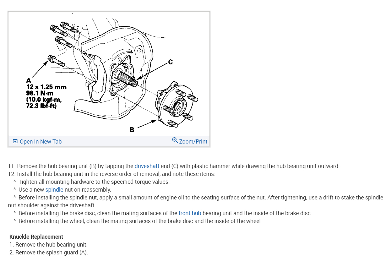

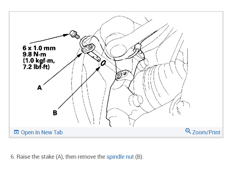

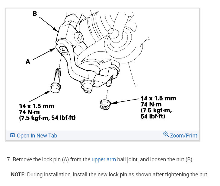

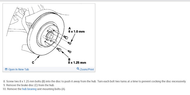

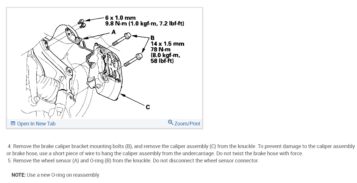

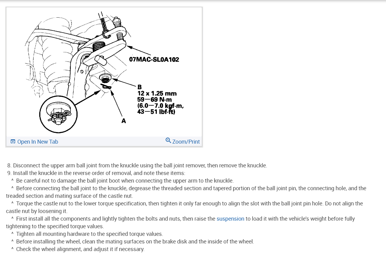

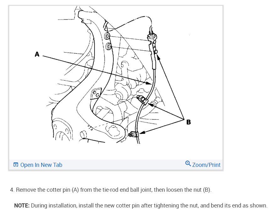

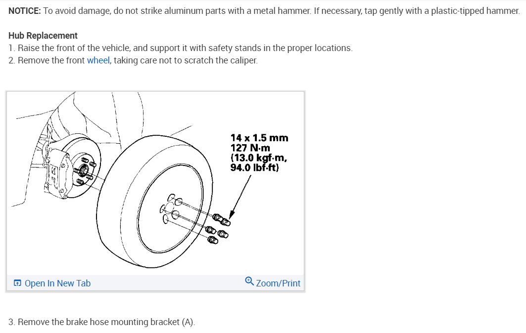

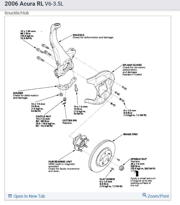

If so here is the step by step on how to change it out with diagrams below to show you on your car:
https://www.2carpros.com/articles/bearing-hub-replacement
