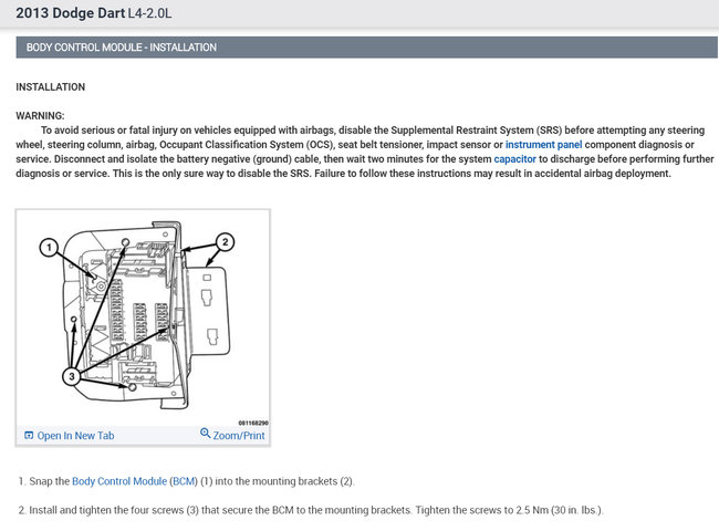

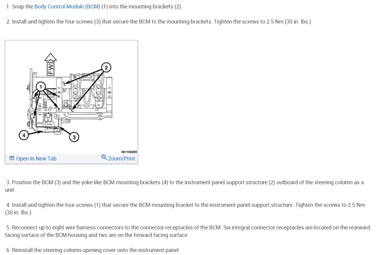

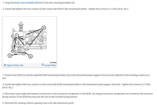

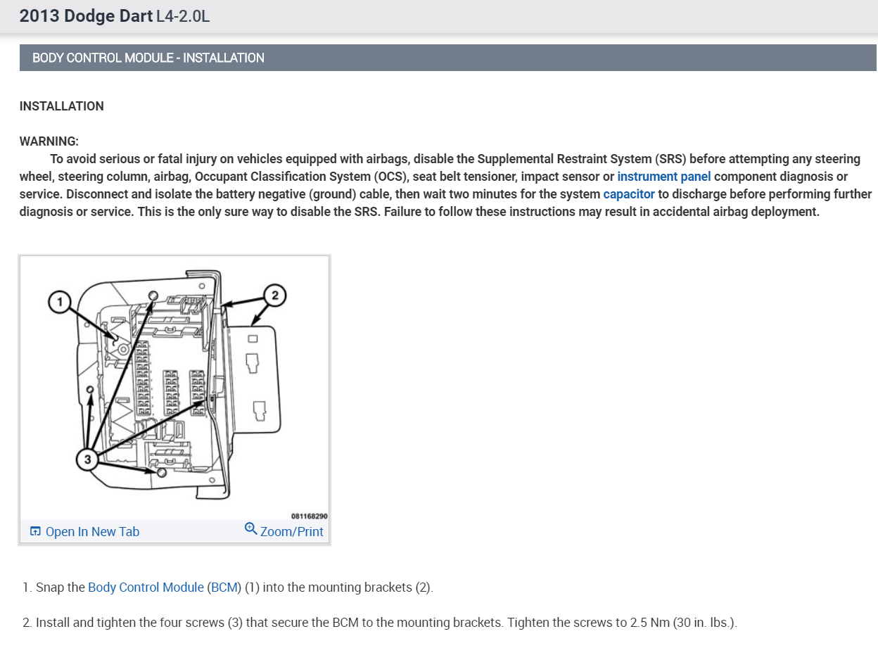

Thank you for the detailed question. this is common when the BCM goes out. To be sure we should do a CAN scan. here is a video that shows how it is done then check out the diagrams below:
https://youtu.be/InIlnsjOVFA
