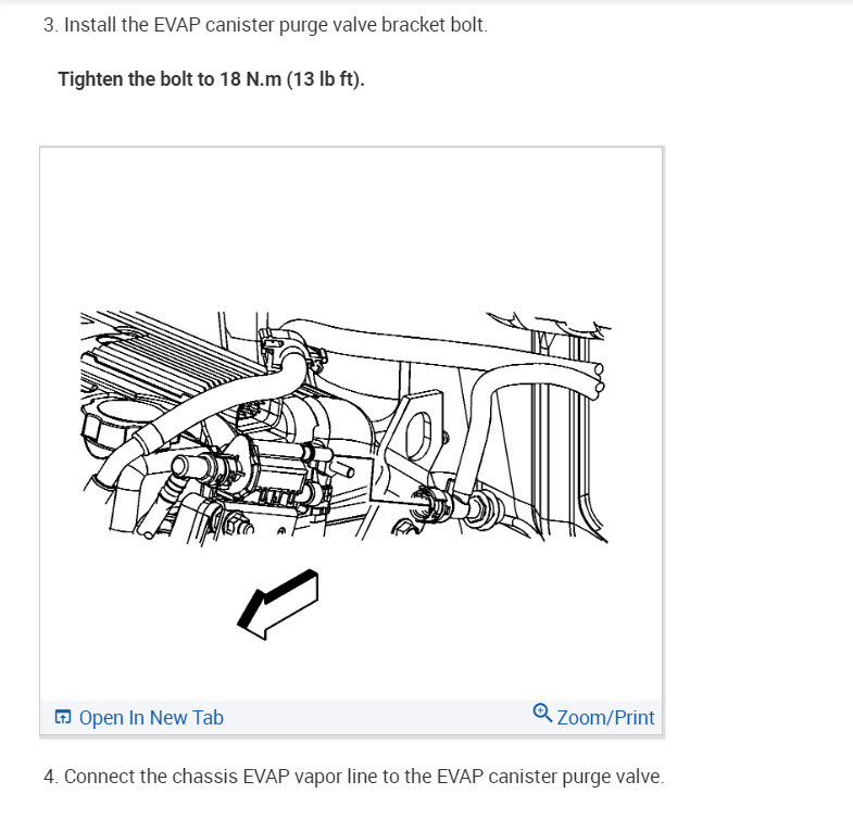

First, please clear the codes and then turn the car on to see if there are any codes, if not start the engine and then shut it off and run the codes again.
This guide can help:

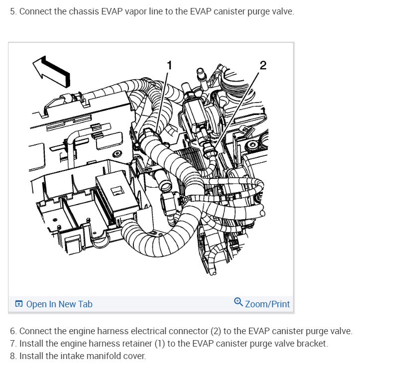

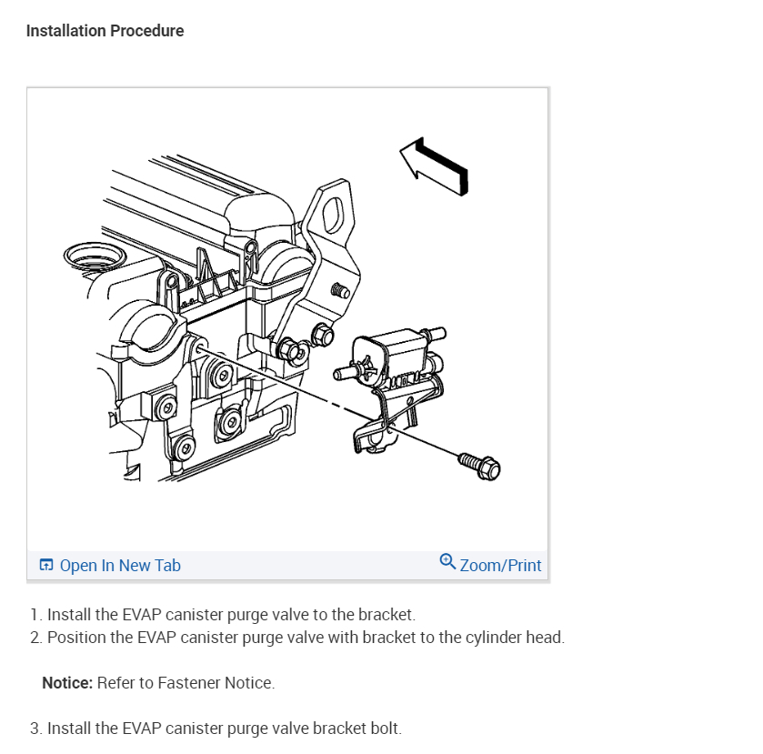

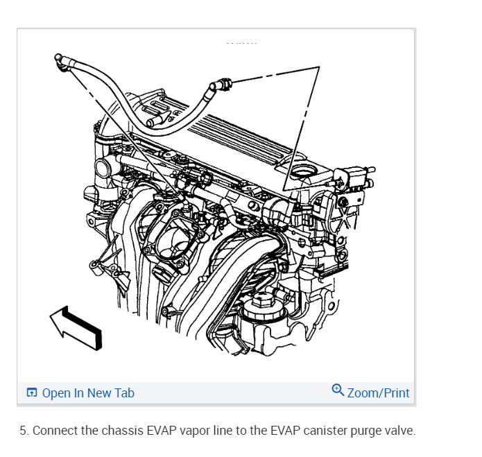

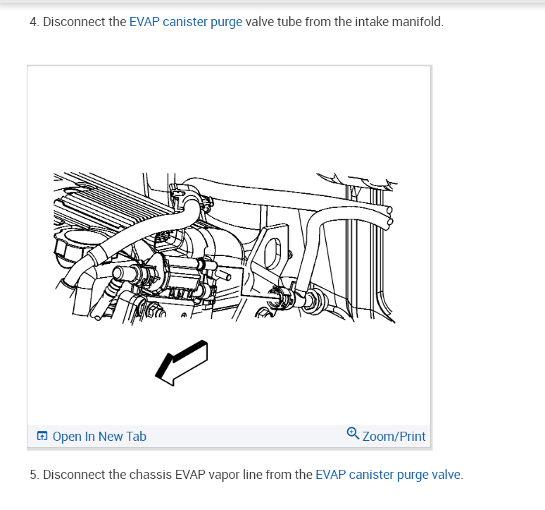

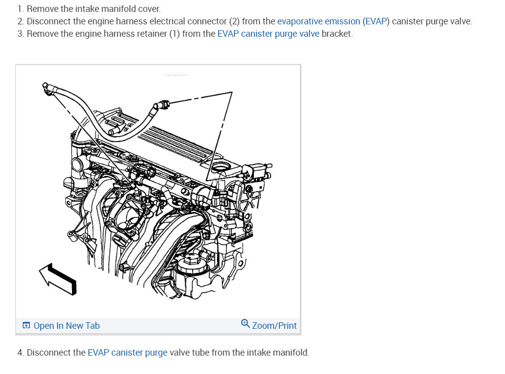

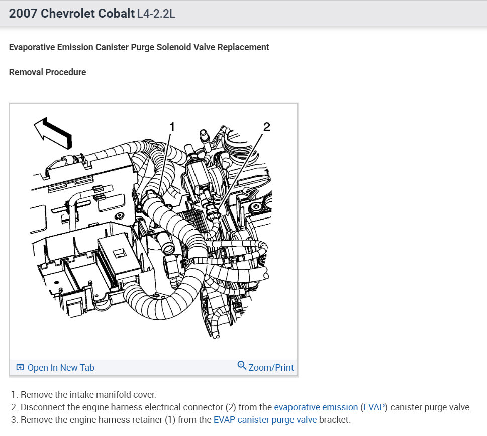

I have seen the EVAP purge solenoid stick open causing the codes and problems you have described. Here is the location so you can see if it is open, (blow through) if so, the valve is bad, and it needs to be replaced. Check out the images (below). Please let us know what happens.
