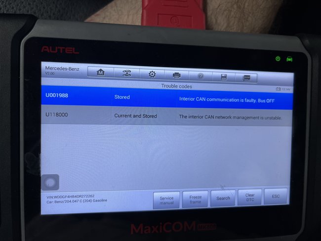

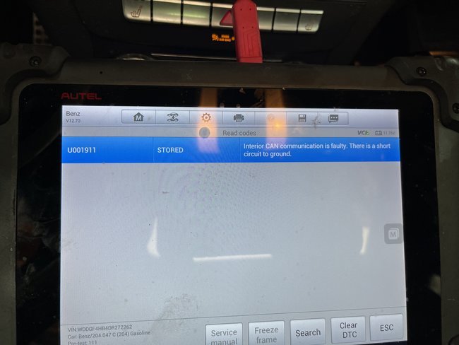

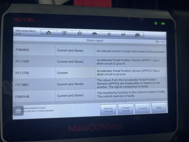

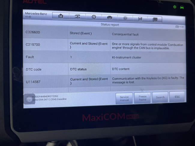

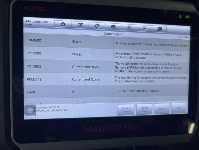

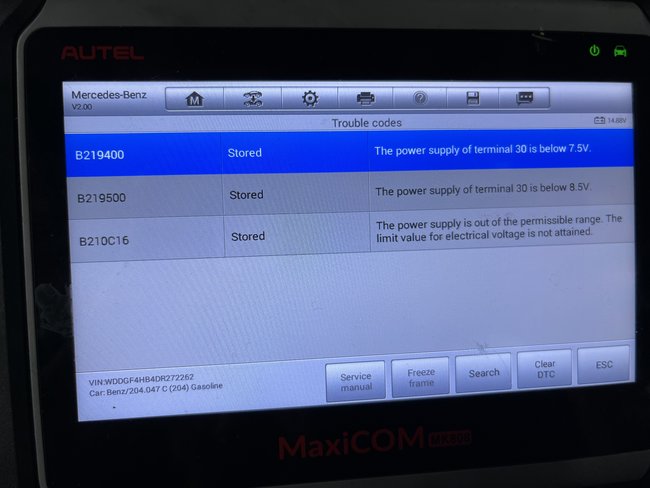

Sunroof inoperable, same for driver side set, traction light on, no throttle response
2013 MERCEDES BENZ C250
64,000 MILES • 4 CYL • TURBO • 2WD • AUTOMATIC
DIVIDES
  • 903 POSTS

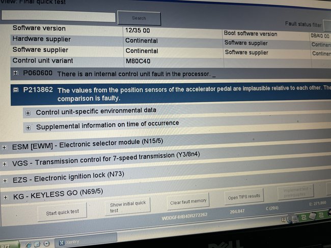

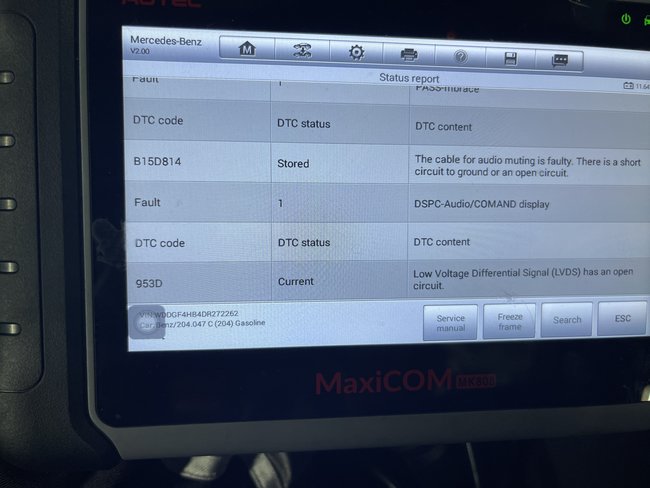

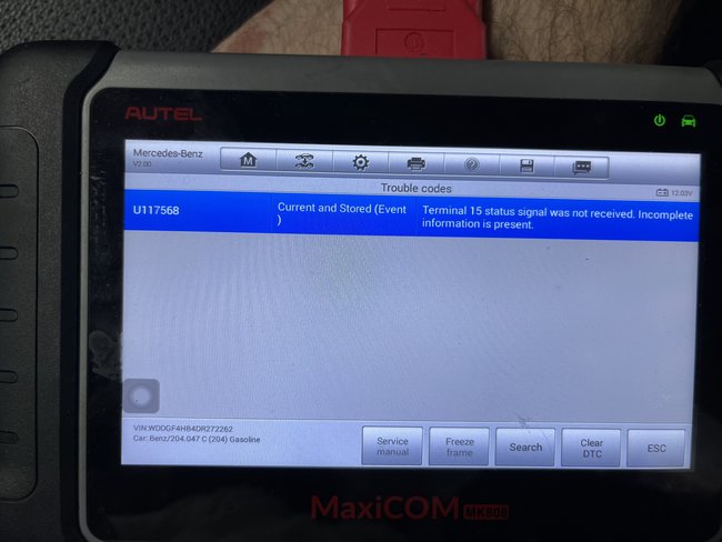

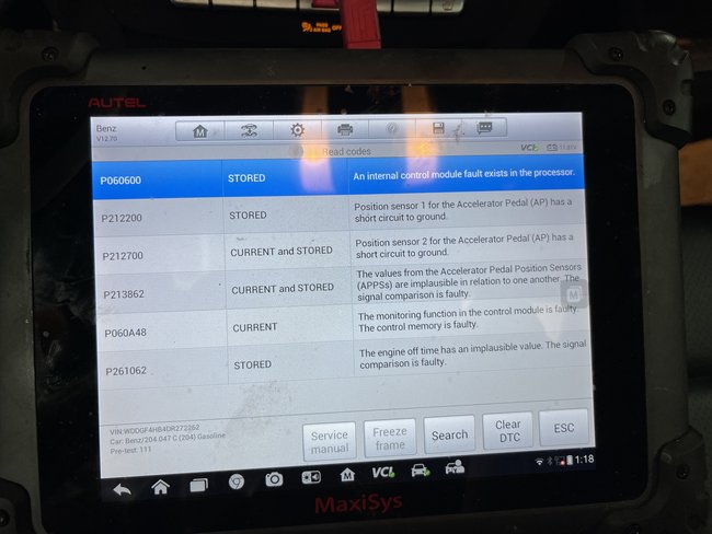

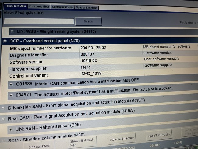

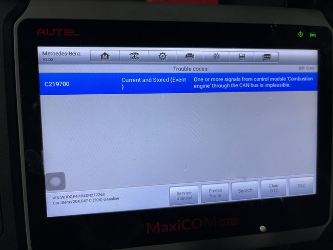

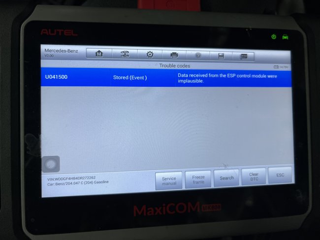

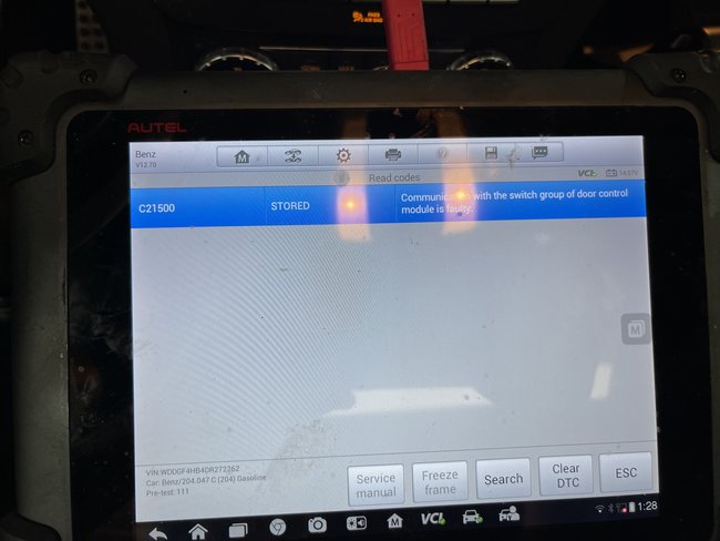

Sunroof inoperable, same for driver side set, traction light on, no throttle response, starts and can drive it around the block, when parked no response. Sometimes the engine revs on its own when in park. Some water on floors from sunroof issue. Tried to activate the roof but i only heard a click from the motor. No clicks heard from the seat.

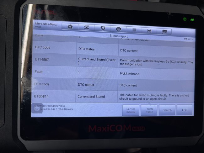

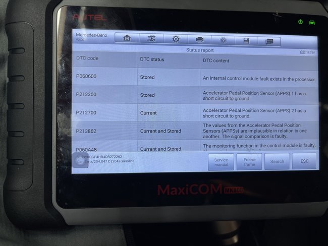

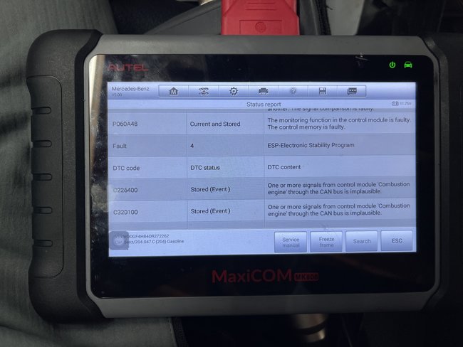

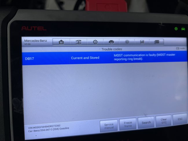

The first scan is in the first picture, the second motor scan in second picture and the third one left me with one code. I have a feeling it's the pedal sensor.
Voltage and battery Re where they should be. Also scanned seats and other things i can scan. Also, the radio works but no sound.

I am just afraid they all related cause if the water that yot in. Maybe the sunroof stopped working and then when water came in messed up the seat and the gas pedal sensor. Can you just tell me where the ecu is? I'll send it for repair, if they find nothing, they won't charge me anything.
May 3, 2022 at 6:30 PM

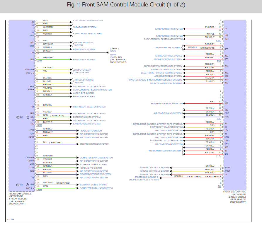

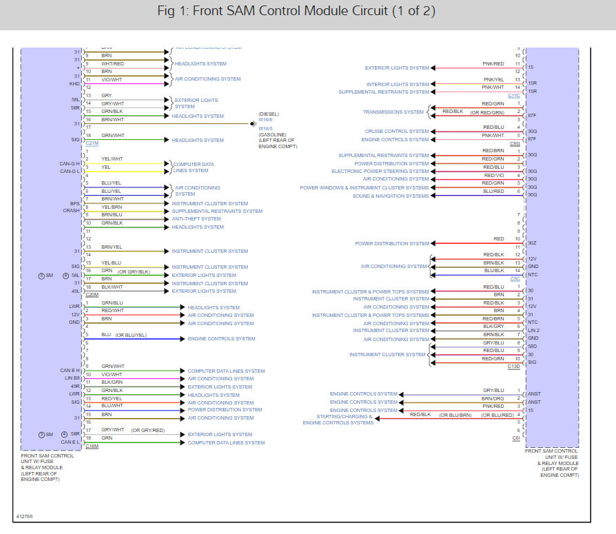

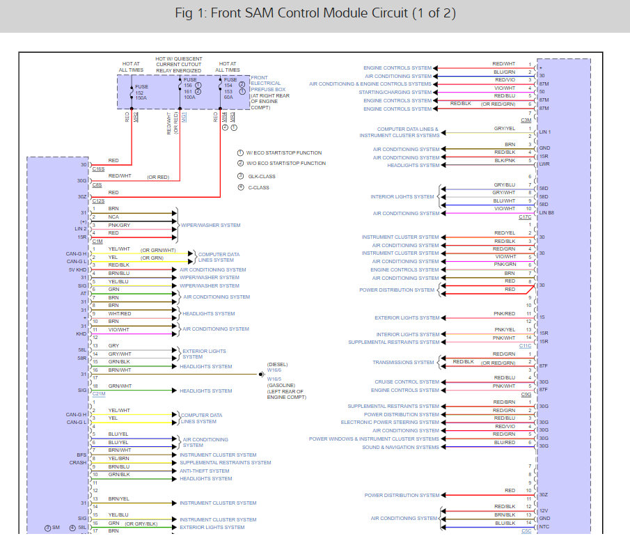

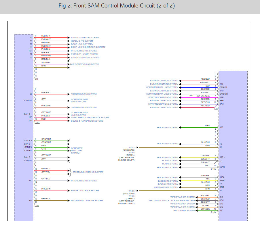

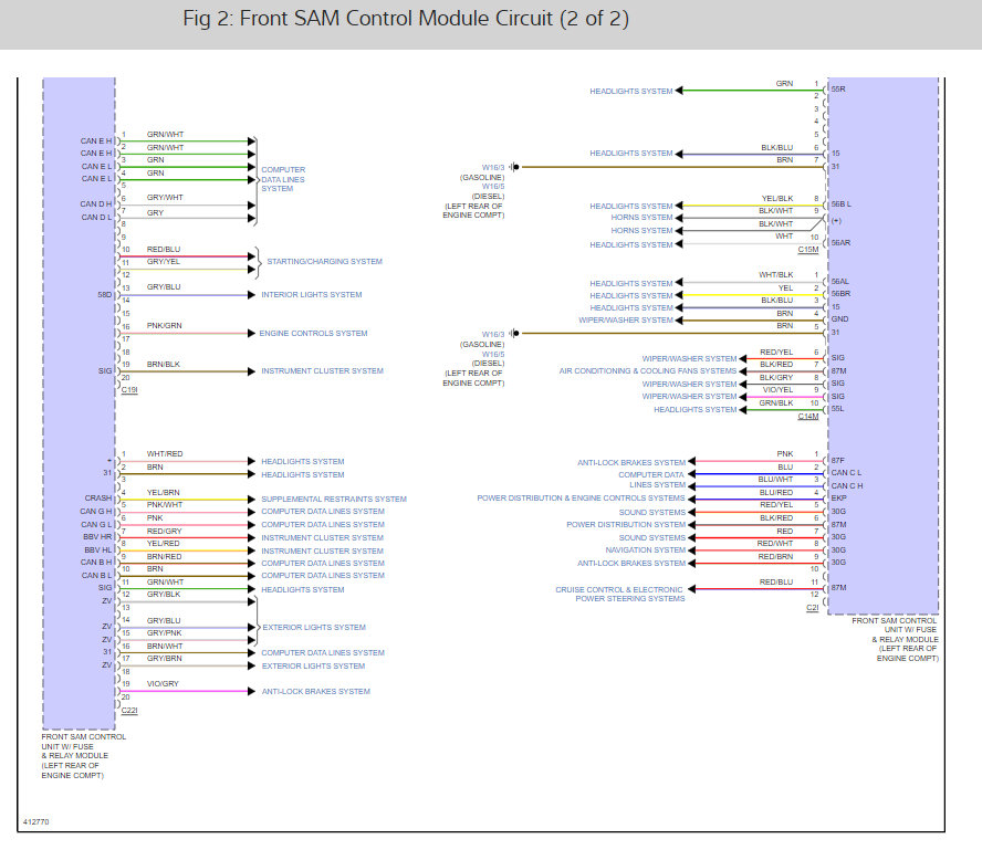

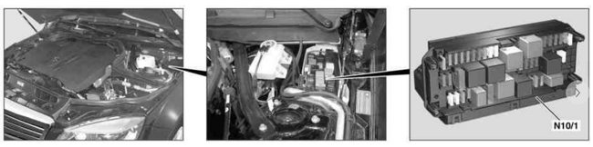

This sounds like the front SAM control module is out which is common, here is the location so you can get it checked out. I have also included the ECM location as well. Check out the diagrams (below). Please let us know if you need anything else to get the problem fixed.
May 4, 2022 at 4:44 PM
DIVIDES
  • 903 POSTS

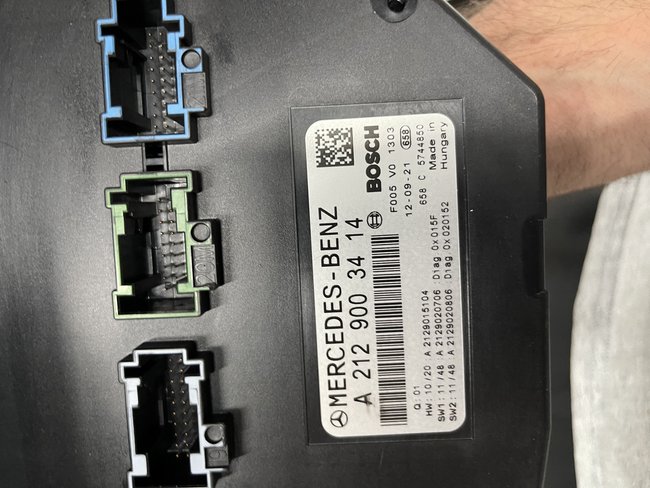

Which if these is the SAM module? How do i test it? And does it need programming? I don't see any diagrams.
May 4, 2022 at 4:54 PM
DIVIDES
  • 903 POSTS

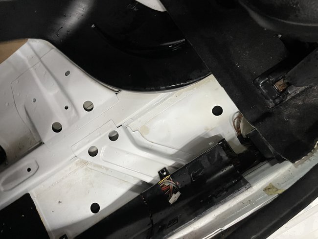

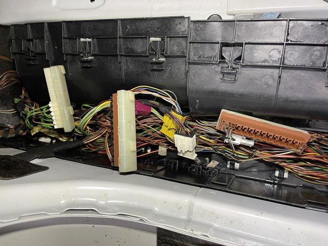

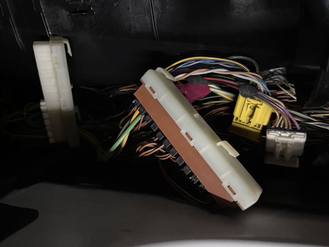

I found it, very tight space, any instructions on how to remove it? I think i see 4 torx bolts that hold it down, just want to make sure.
May 5, 2022 at 6:50 AM
DIVIDES
  • 903 POSTS
Removed it based on videos. Some guy also said SAM for the other one that is by the battery, not sure why. First picture is mine.
May 5, 2022 at 8:19 AM
Yep that's it, here is the text on how to replace it it what it does,
N10/1 Front SAM control unit with fuse and relay module
Location
The front SAM control unit with fuse and relay module is located at the left in the engine compartment.
Task
Two microprocessors are installed in the front SAM control unit, one for control of basic functions such as, e.g. the exterior lights (ABL), and the second for control of the central gateway functions. Both processors communicate internally with each other over the interior CAN (CAN B) and they can undergo separate diagnosis. The front SAM control unit also has a 3D acceleration sensor integrated into it which is used to detect any crash events.
For model 204.9 a speedy journey over uneven roads can cause significant vibrations which in turn may induce the 3D- acceleration sensor to be actuated. These are entered into an event memory. When mounting, make sure that the front SAM control unit is securely seated.
The processor is responsible for the following tasks for controlling the central gateway functions:
- Central gateway (CAN interface)
- Data container
- System diagnosis
- Global variant coding
- Monitoring CAN bus idle
The processor is responsible for the following tasks for controlling the basic functions:
- Interior CAN and LIN interface
- Reading in of sensors, pickups and signals
- Evaluation of input factors
- Controlling functions
- Actuation of components
The fuse and relay module of the front SAM control unit supplies various systems and control units with power through limit switches to match the function sequence.
The following tasks are the responsibility of the fuse and relay module:
- Voltage supply to components
- Power supply and relay switching
- Switching consumers using relays
Detailed information is available in the "Fuse and relay box, asbuilt configuration" function description.

All of that is controlled by this box. Geez... what does it have in it other than fuses? This is amazing. I ordered one with same part number.
May 7, 2022 at 9:40 AM
I know, right? They have an integrated circuit board inside. Let me know how it goes.
May 7, 2022 at 9:55 AM

Replaced SAM, same issues if not more.
May 12, 2022 at 10:51 AM
DIVIDES
  • 903 POSTS

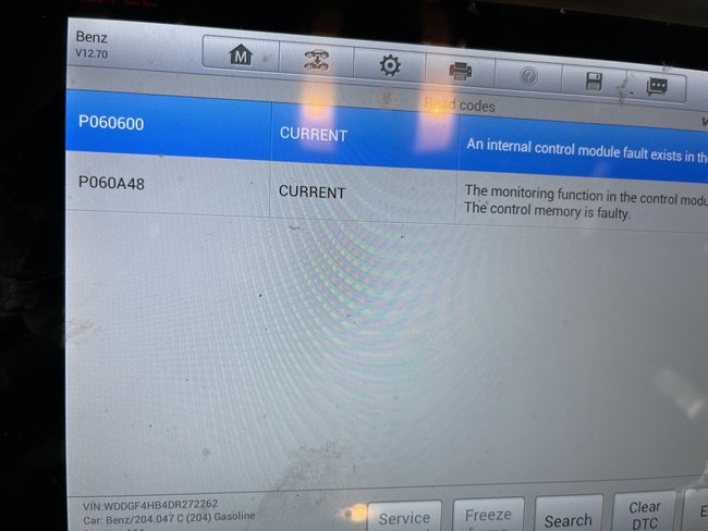

Also, even though it has the sane exact numbers, sometimes it will start others not, and when turning radio on it says anti-theft. Had lots of codes, reset it, disconnected battery and connected sane thing. Ugh, i may put the old one back and recheck fuses. The large red wire on bottom of this SAM u it is pain to remove and out back.

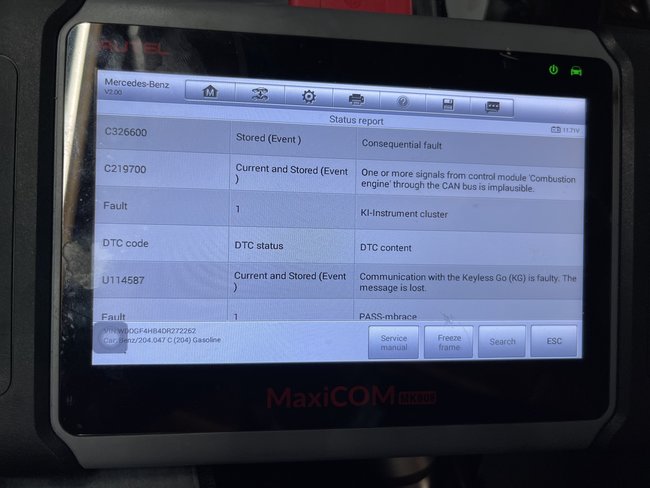

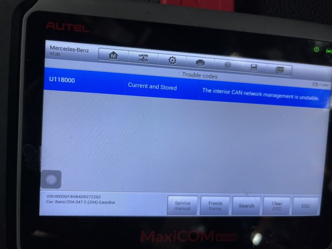

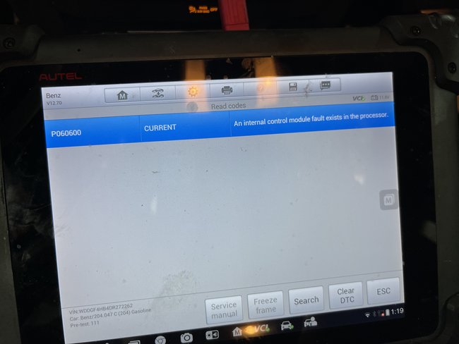

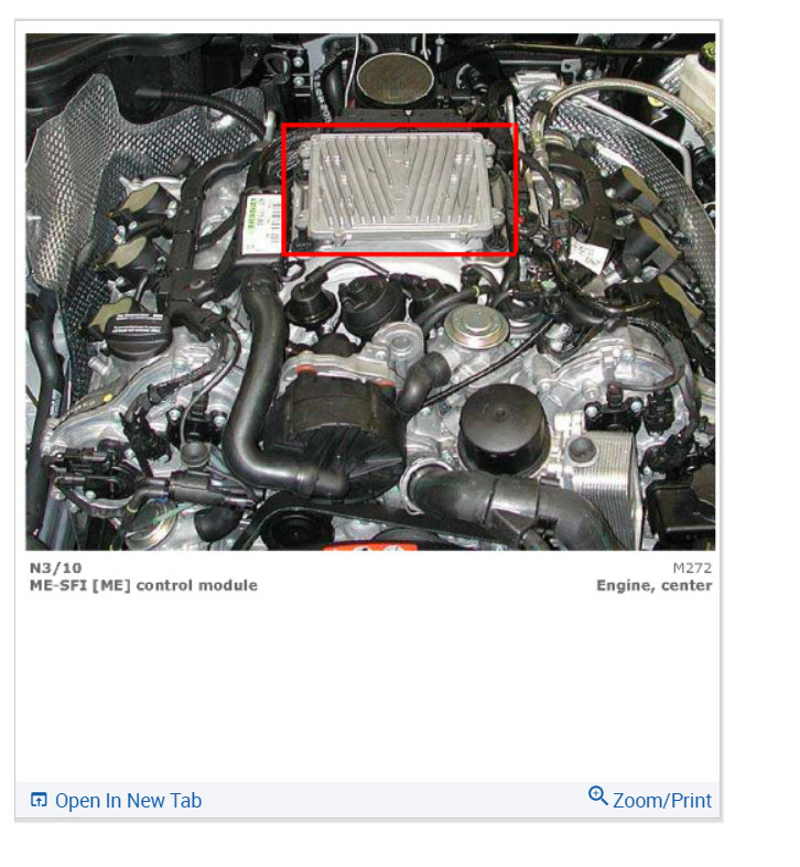

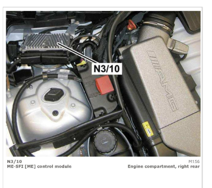

I reinstalled the first one and got it to start again, no throttle response and some codes. I think when i crossed the battery i blew something off. All fuses are good in the SAM module. Are there fusible links anywhere else? Based on the code terminal 15 is faulty that is why most of the time it won't start now.
May 13, 2022 at 8:37 AM
DIVIDES
  • 903 POSTS
Also, can you tell me what function does the solid red thick wire at the corner has?
May 13, 2022 at 8:56 AM
DIVIDES
  • 903 POSTS
Found out there us a pool of water underneath the driver side carpet. I cleaned it all and unplugged each connector, some had water other corrosion, cleaned with brake cleaner and blew it with air for now since i don't have electric spray. Still no throttle but it started, windows worked, radio screen works but no audio, lights work, tilt doesn't, sunroof doesn't. Throttle only works if i floor it and rom would start to got it higher. Is there a way to find out which of these little boards here have to do with throttle, sound, tilt and sunroof?

Traction has been on from before and still is but i never saw this code. While parked engine revs on its own. Also, it's strange that the throttle just flies on its own without touching the pedal all the way up and i have to turn it off. The sunroof may have been the main issue. It stopped working maybe due to a bad motor or all these electrical issues started, and the sunroof was stuck open, and water got in. Common on these junk cars.

DIVIDES
  • 903 POSTS
No not under water, this is a common issue with these cars always leak there for some reason, everywhere else is dry. I will do a complete scan.
May 16, 2022 at 10:09 AM
DIVIDES
  • 903 POSTS
Attached.
May 16, 2022 at 1:38 PM
way too many codes, either major wiring or control module issue. Can you clear the codes and then just turn the key on without trying to start the engine and recheck the codes?
May 16, 2022 at 2:33 PM
DIVIDES
  • 903 POSTS
This is after deletion. Most have to do with pedal sensor i guess except the first. I am just trying to narrow it down. As soon as i started the motor after deleting them all the engine started revving on its own real high and i turned it off.
May 16, 2022 at 3:47 PM
DIVIDES
  • 903 POSTS
This is after i started it and turned it off.
May 16, 2022 at 3:51 PM
Yep, this shows a bunch of electrical problems. It looks like the wiring harness could be bad or one of the SAM modules is still having an issue. You might want to try and leave the battery disconnected overnight to see if that does anything.
May 17, 2022 at 9:50 AM

Okay. All the wires look good, none are torn or showing corrosion, but I will get an electrical cleaner and spray them all and see.
May 17, 2022 at 9:51 AM
DIVIDES
  • 903 POSTS
Replaced the gas pedal and sprayed all wire connectors and breakers under the carpet with electric cleaner. Started with no check engine light or traction. Throttle now solved. Most codes are gone. Deleted most and most were gone. Seat, sunroof, power tilt and radio sound still inoperable. First pic was from SAM module, deleted them and they gone. I think the battery was low.
May 19, 2022 at 8:40 AM

Can you send me the wiring diagram to the front SAM module? I need to find a way to connect this big red wire where it doesn't come loose as the connector was so difficult to remove it broke the plastic connector around it, so i can now connect it but an sure at any point it will come loose. I can't find the plastic connector sold alone so i will need to find a way or replace that wire, just need to know where it goes
May 19, 2022 at 9:21 AM
DIVIDES
  • 903 POSTS
Also, where the fiber optics equipment so i can try to bypass it using the bypass tool?
May 19, 2022 at 9:32 AM
Here are the front SAM module wiring diagrams and a guide to help you do some checking:
May 19, 2022 at 10:27 AM

The roof motor replaced, and sunroof now works. Is there any way you can find out for me the location of the modules like the telephone module, radio module, amplifier so i can try to bypass them and see if one is causing the sound issue.
May 24, 2022 at 11:27 AM

DIVIDES
  • 903 POSTS
Sound fixed. Underneath the passenger floor by firewall on bottom behind the metal plate is a connector, bypassed it and all is good now. Only thing left is the power driver seat and power tilt.
May 27, 2022 at 2:39 PM
