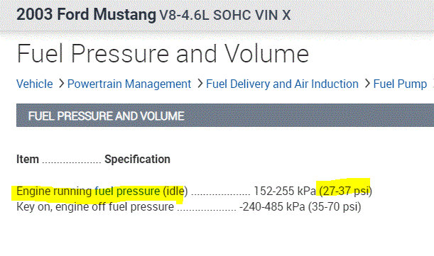

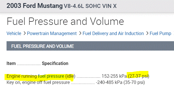

Pic 1 shows the manufacturer's fuel pressure specifications.
See pic below.
