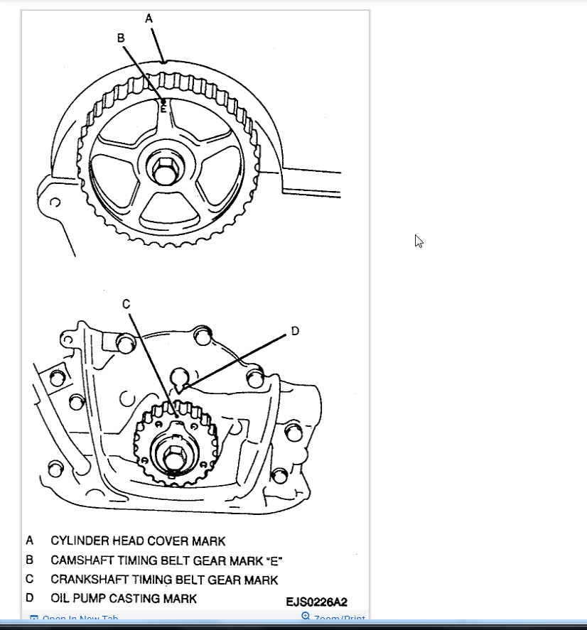

I changed the timing belt. Found the old one had skipped. I have set the cam the notch that has the E on it to the specified mark on the top of the motor and the crank is set to TDC on the number 1 cylinder. Tried to test fire it and all it does is backfire. Can you help?
