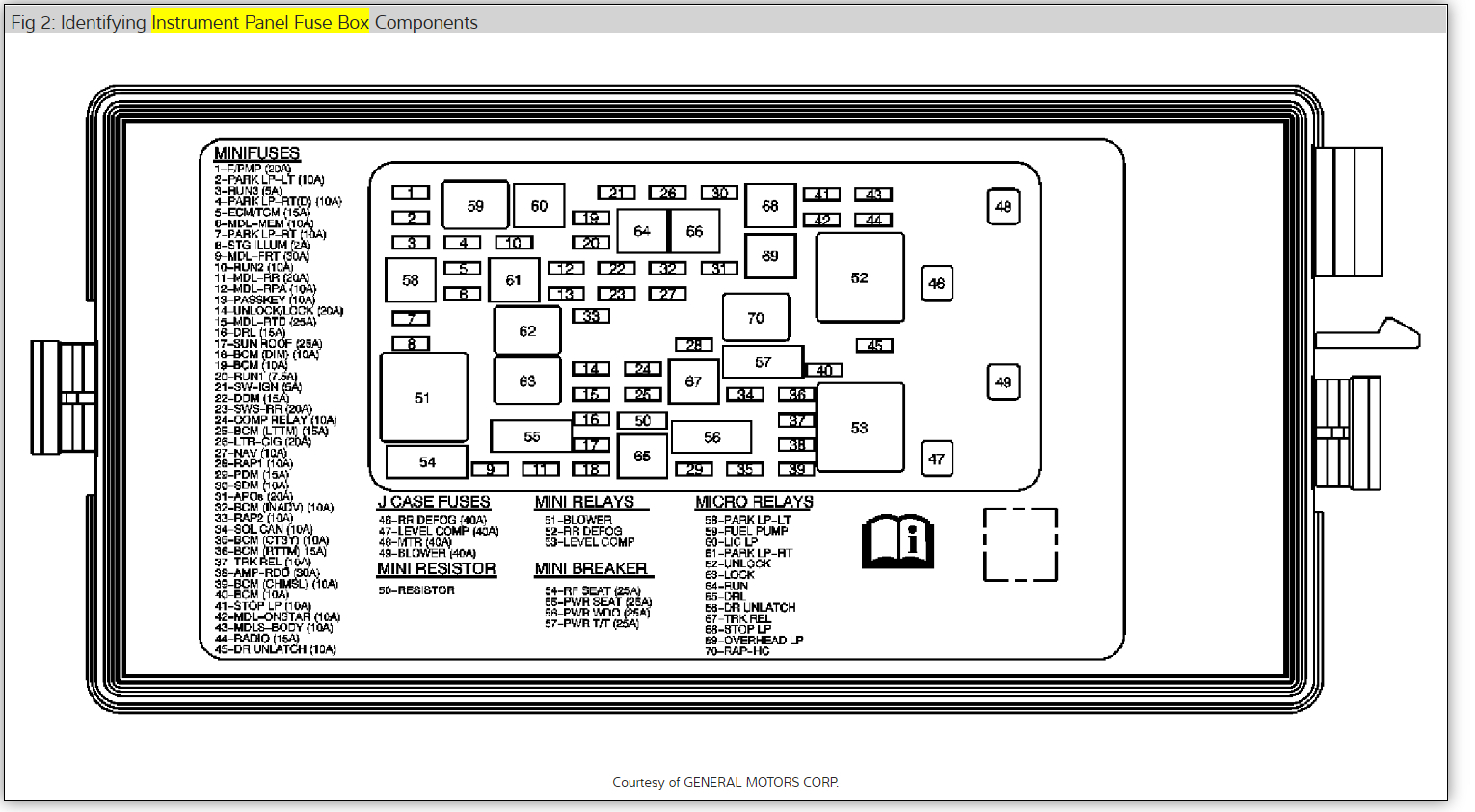

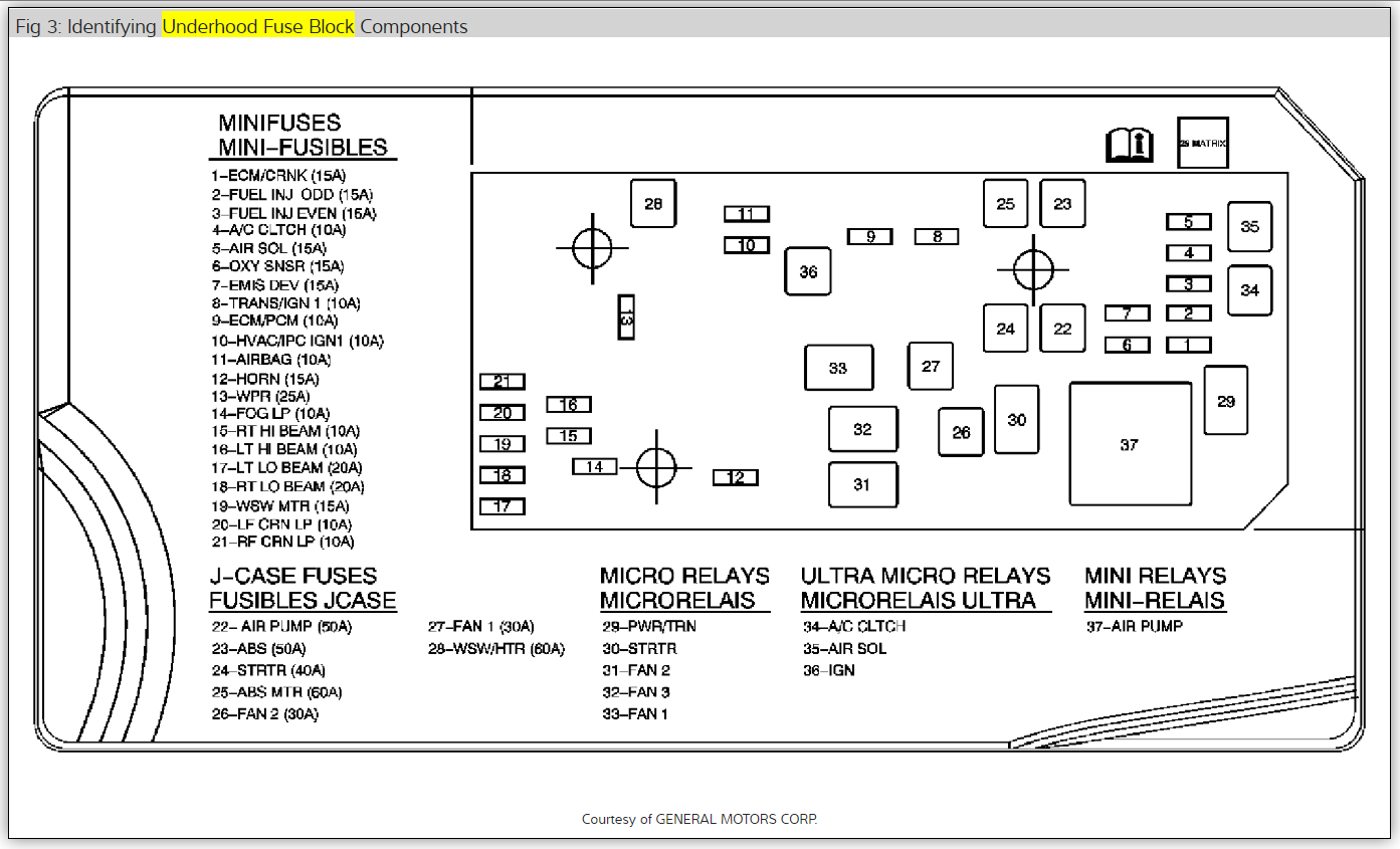

It sounds like you had a voltage surge which could have popped a fuse, so we need to check those first.
This guide will help please check the fuses with the key on:
If all fuses are okay, we need to run the codes by doing a CAN scan. You can get a CAN scanner (Controller Area Network) from Amazon.
Here is a video to show you how:
https://youtu.be/u-4syLc-ifQ
and
https://www.2carpros.com/articles/can-scan-controller-area-network-easy
Here are the fuse locations. Check out the images (below). Please let us know what happens.
