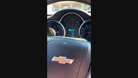

While driving the brake light, traction light and ABS light also power steering light sometimes flashes on then off. also sometimes the radio cuts off. The check engine light also comes on and off.

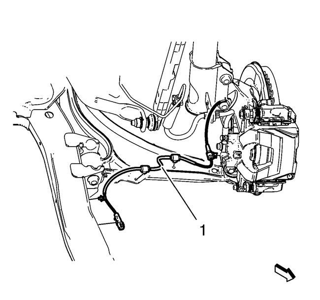

1. Raise and support the vehicle. Refer to Lifting and Jacking the Vehicle See: Vehicle Lifting > Procedures > Lifting and Jacking the Vehicle.
2. Remove the tire and wheel assembly. Refer to Tire and Wheel Removal and Installation See: Wheels and Tires > Removal and Replacement > Tire and Wheel Removal and Installation.

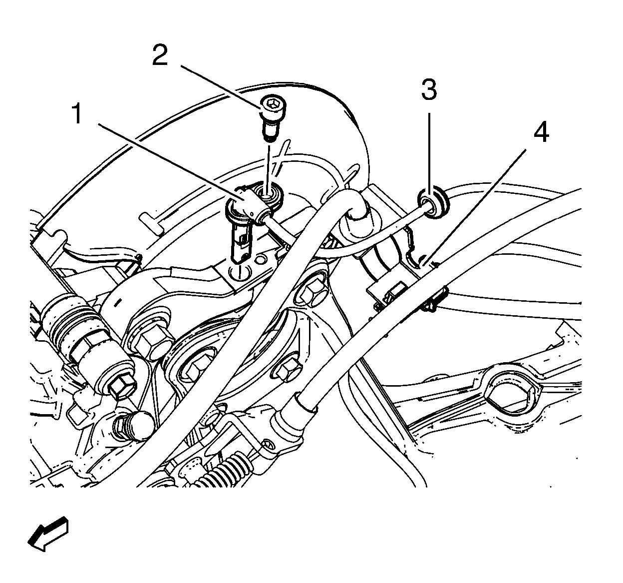

pic 1
3. Remove the wheel speed sensor screw (2) from the steering knuckle.
4. Remove the wheel speed sensor (1).

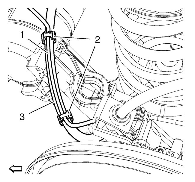

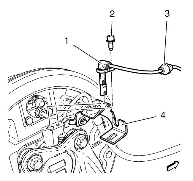

pic 2
5. Remove the wiring harness retainers from the frame.
6. Disconnect the electrical connector.
7. Remove wheel speed sensor (1) from the vehicle.

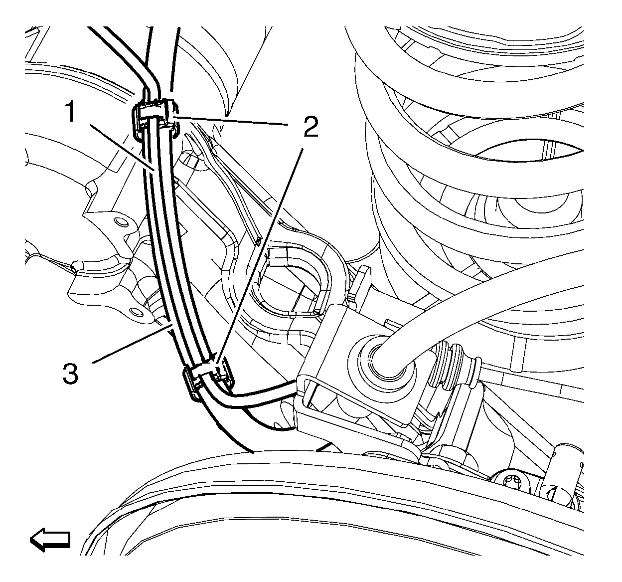

pic 3
1. Install the wheel speed sensor (1) to the vehicle.
2. Connect the electrical connector.
3. Install the wiring harness retainers to the frame.

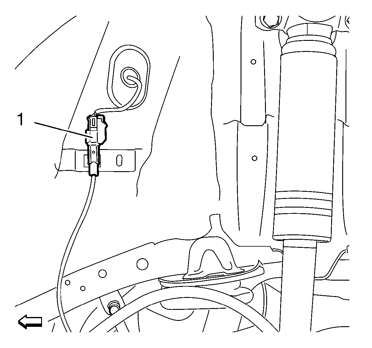

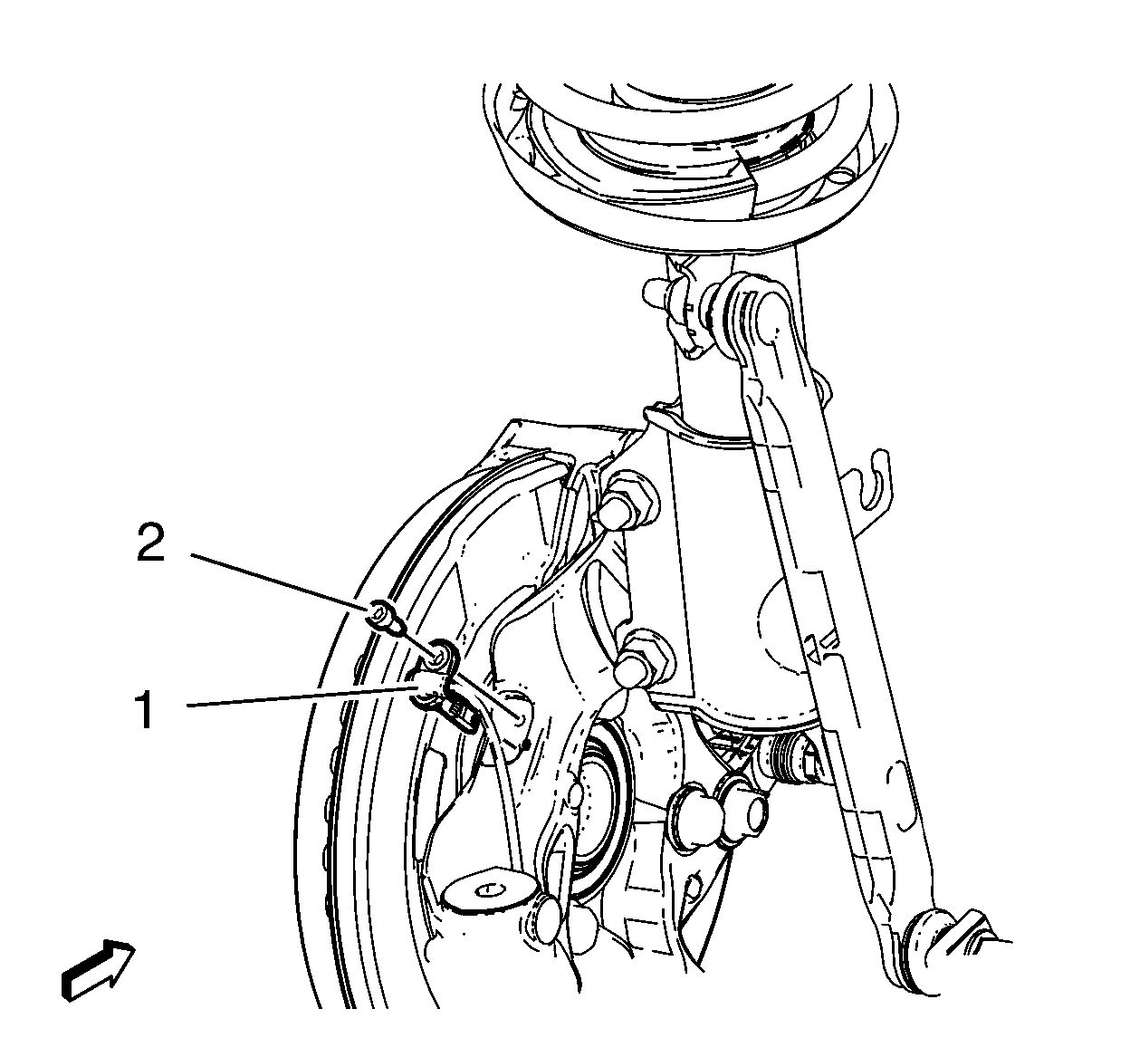

pic 4
4. Install the wheel speed sensor (1) to the steering knuckle.
Caution: Refer to Fastener Caution See: Vehicle > Technician Safety Information > Fastener Caution.
5. Install the wheel speed sensor screw (2) and tighten to 6 Nm (53 lb in).

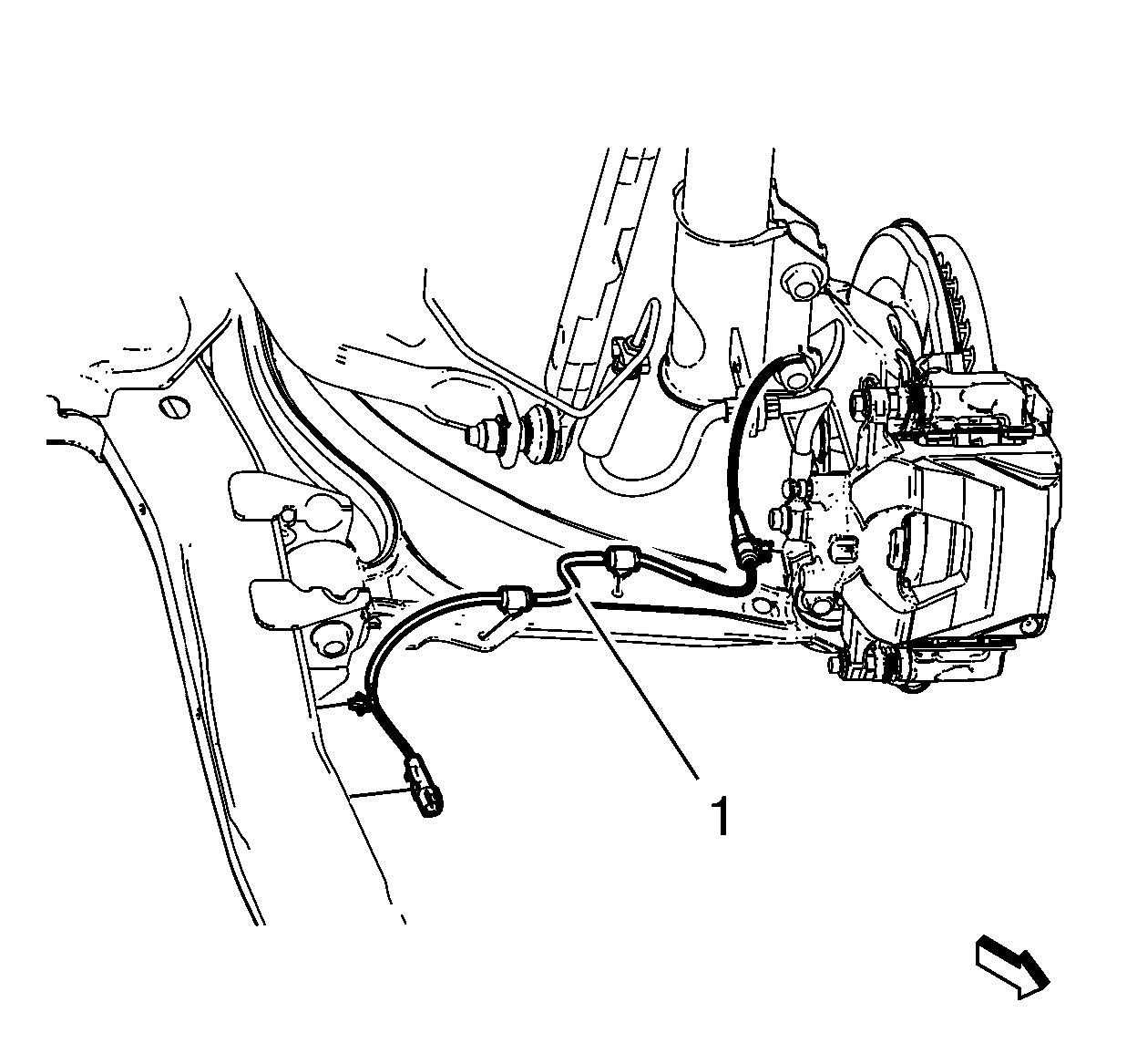

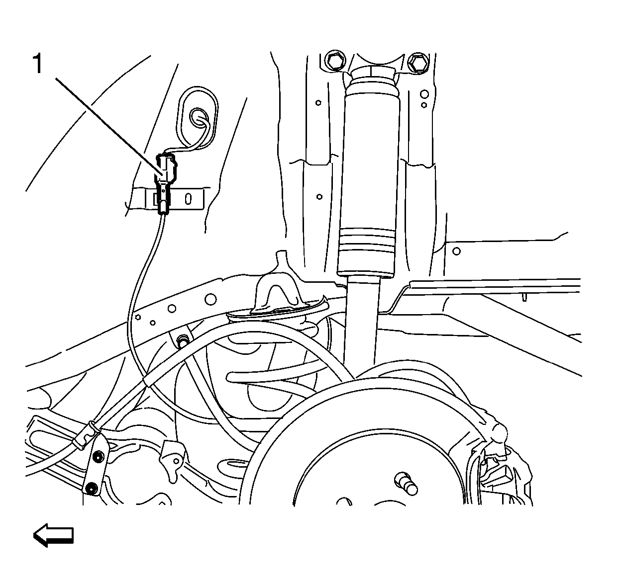

pic 5
4. Remove wheel speed sensor (1).
5. Remove wiring harness (3) from bracket (4).

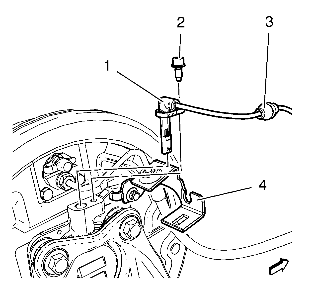

pic 6
6. Disconnect the electrical connector (1).
7. Remove wheel speed sensor from vehicle.

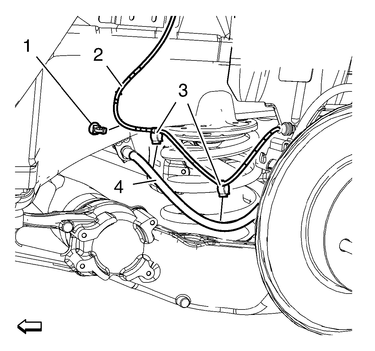

pic 10
5. Remove the wiring harness (2) retainers (3) from the brake hose (4).
6. Remove the wiring harness (2) from the body retainer (1).
7. Replace the body retainer (1).

pic 13
3. Install the wiring harness (2) retainers (3) to the TOP SIDE of brake hose (4), using the marking points of old wiring harness.
4. Install the wiring harness (2) to the NEW body retainer (1).

pic 15
8. Check the correct installation position of the wiring harness (1). The wiring harness MUST be routed on top of the brake hose. If necessary adjust retainers (2) to the marking positions on the brake hose.
9. Apply tension to the wiring harness (1) between the retainers (2) for the correct routing.
10. Push down the brake hose by hand, to assure the correct installation position.
