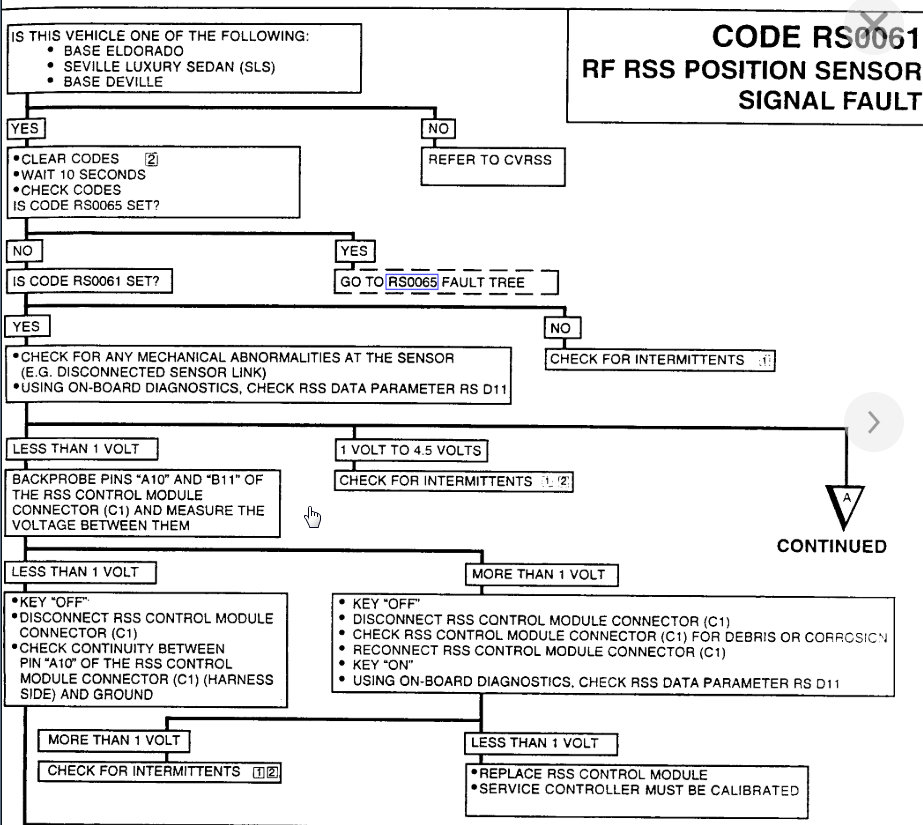

The service ride control is on and the code (RS0061 current) appears. From what I've read so far this is the right front suspension height sensor. Does this mean the sensor is automatically bad ? What is the first step in correcting this problem? Thanks for any information!
