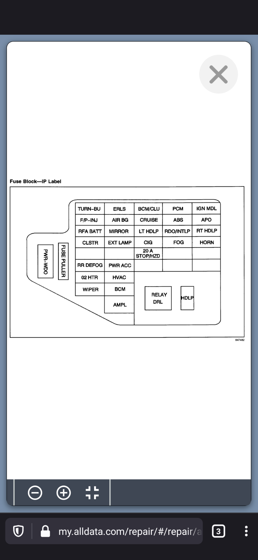

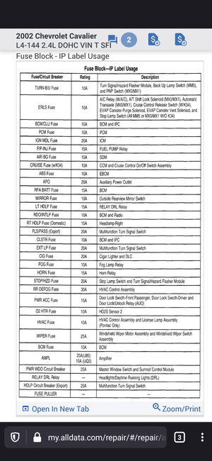

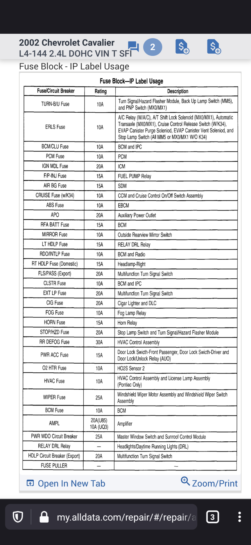

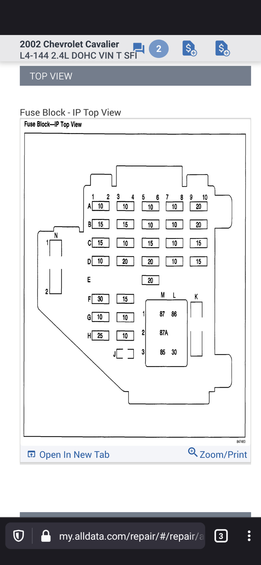

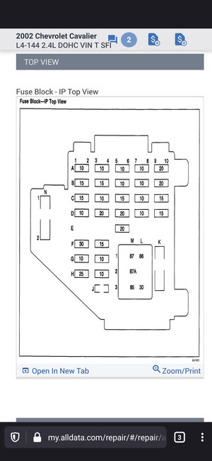

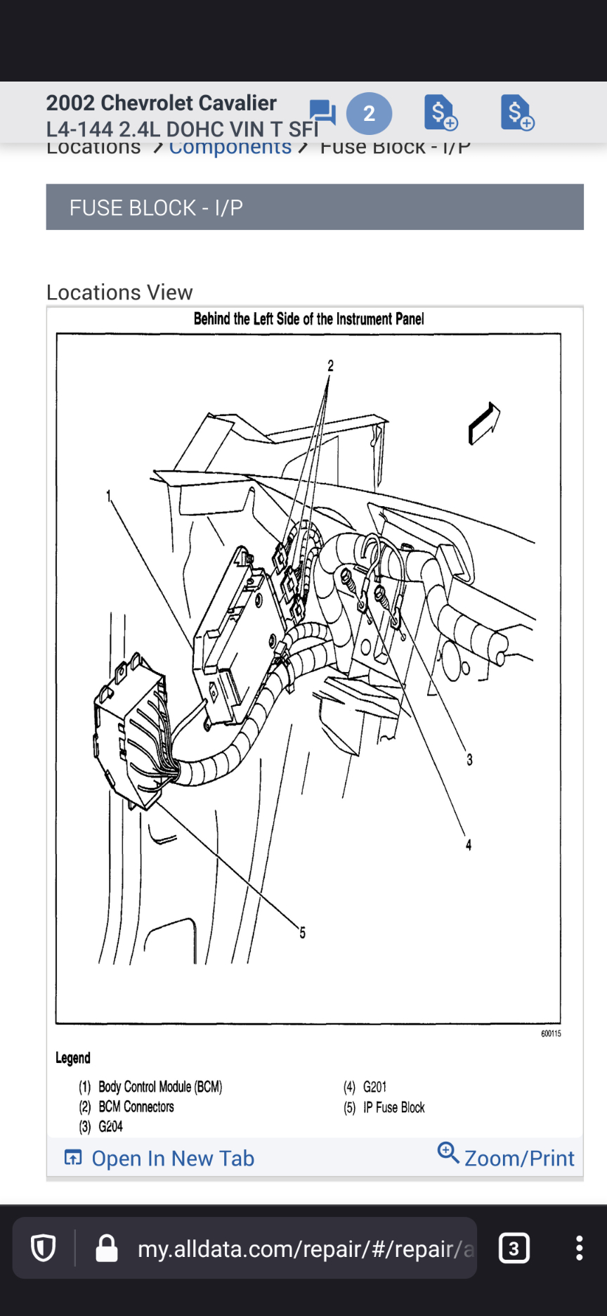

Hi there. To diagnose the headlight issue, the first thing to do is check the fuses. This car has separate fuses for both headlights. Also check your drl fuse. I'm including the fuse box information in the images for your reference.
For the service engine light, in most areas you can have the local parts store people scan your car for trouble codes for free. Get that done and write down the actual code numbers. Report them here and we'll go from there.
and
Here's our general guide on checking fuses:
Check out the diagrams (Below). Please let us know what you find. We are interested to see what it is.
