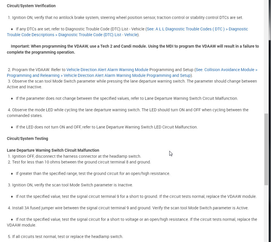

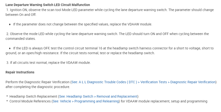

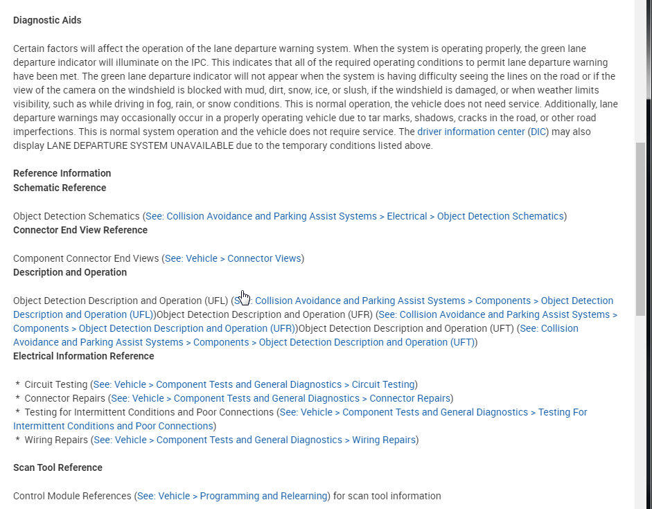

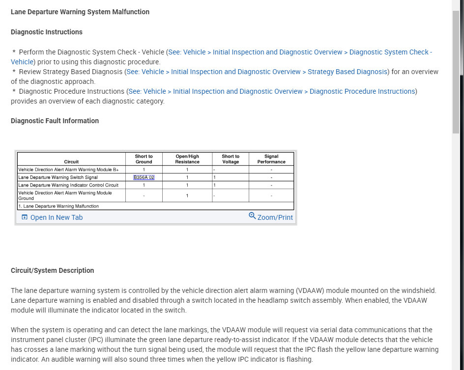

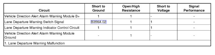

We need to start with what codes are in the system. More than likely you have codes that will point us to the correct area of concern.
Just need to ask if you have any accidents or any other damage? Chips in the windshield? This system relies on the camera in the windshield to detect the lines of the lane. Let me know if there are codes and we can go from there.. Thanks
