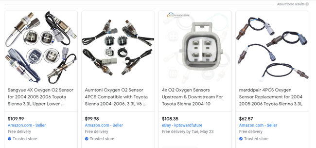

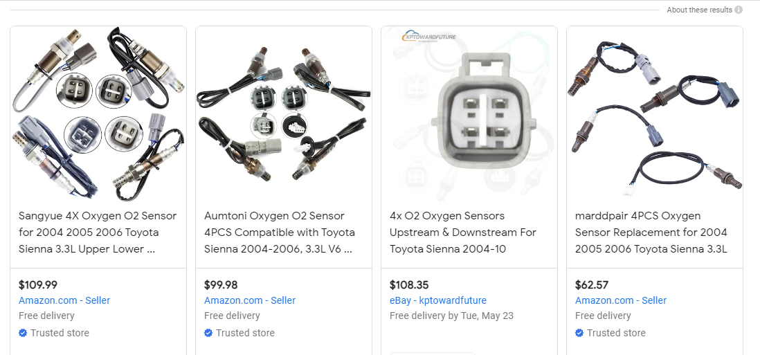

Is the vehicle still running okay? As far the price, that is crazy high. I attached a pic below showing all four sensors for under 100.00 dollars. So, that means they are charging 700 dollars to install them, which again, is crazy. I don't know what the hourly rate is, but they should be able to replace all four in around 3 hours. That would work out to over 230 dollars an hour. Ugh!!! That's a lot.
Regardless, let me know if there is anything I can do to help or if you have questions.
See pic below.
