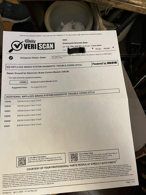

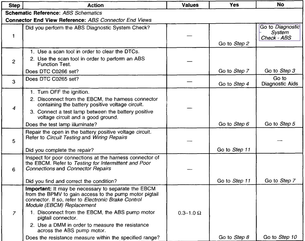

Ok, I finally got a scan tool hooked up. Took me over a week to get the error again.
C0265
Repair ground for electronic brake control module (EBCM)

STEVE W.
  • 15,113 POSTS
That code is commonly caused by corrosion in the electrical connector on the EBCM, or if the ground to the EBCM motor is faulty. I would pull the connections off, look them over for corrosion, clean and reassemble. I have seen it be an issue in the harness and people run a different ground to the EBCM as a repair, however the location of the unit under the truck can make that a bad repair as it starts corroding quick.
