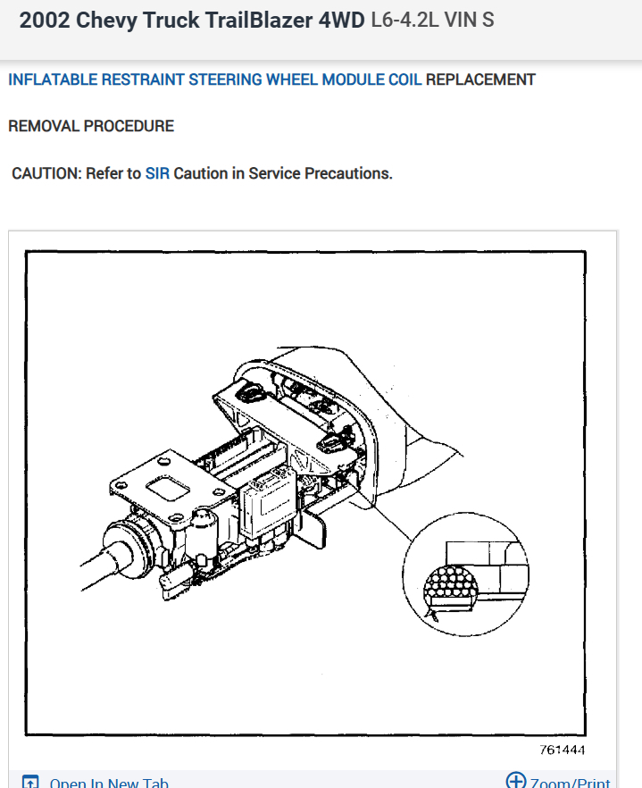

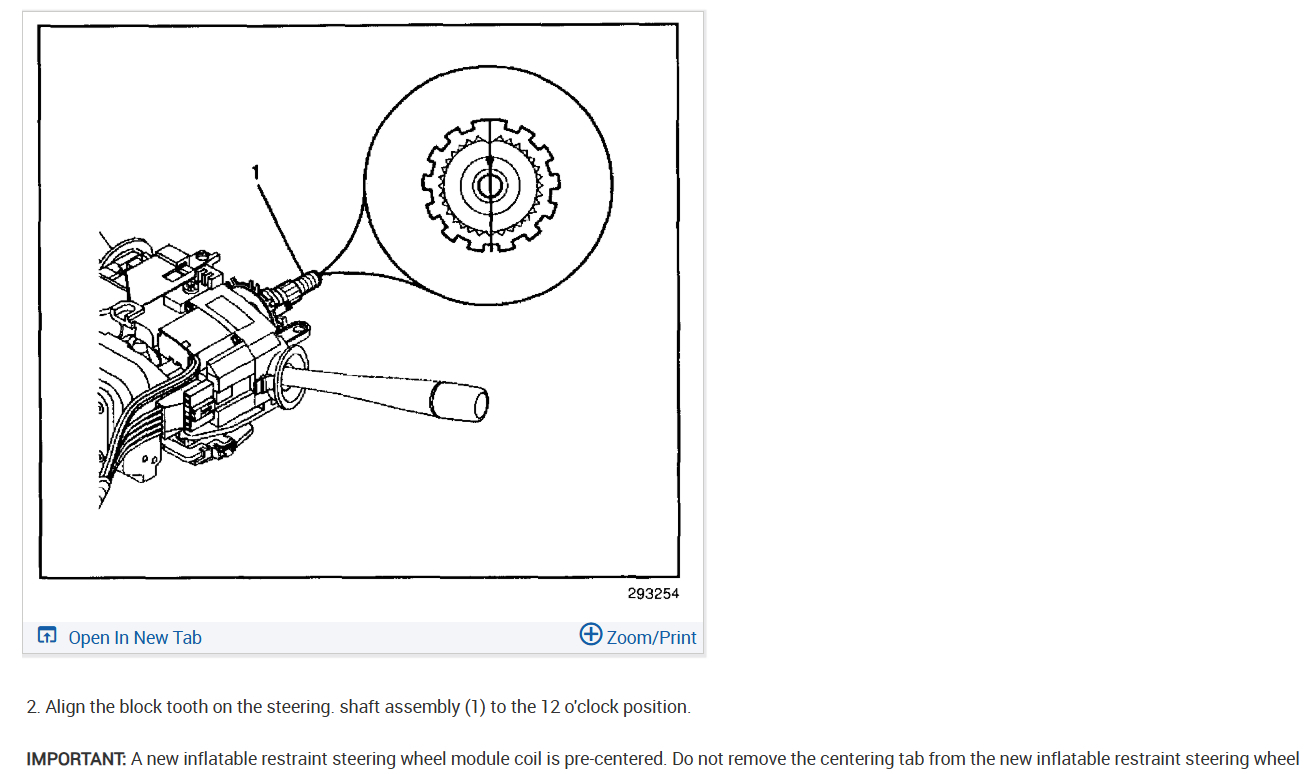

I have a service airbag light. I have a scanner but don't have any SIR codes. I did replace the ignition key cylinder and the hazard switch in which i had to remove the steering wheel. I don't know if it had the code before I replaced the switches because the vehicle did not have a key when I got it.
