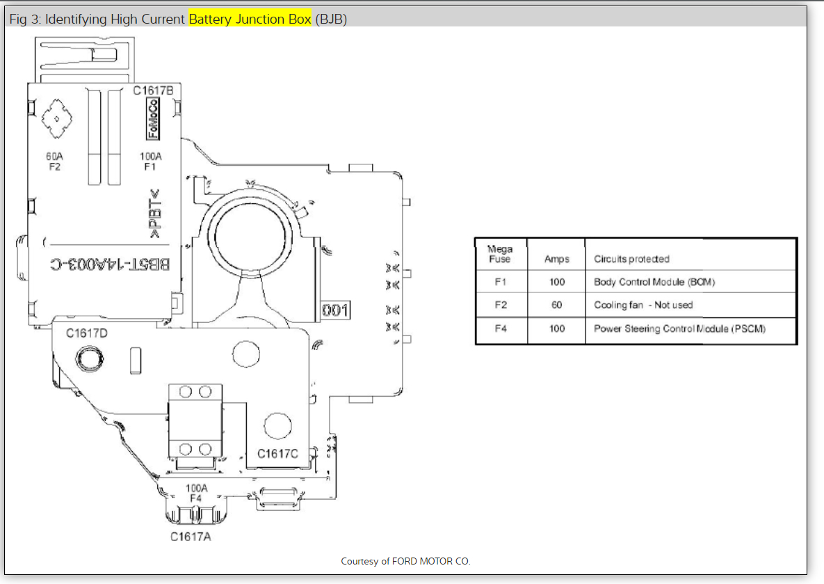

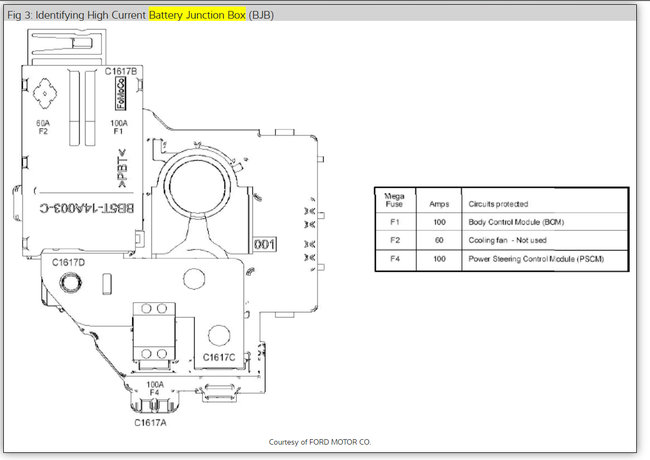

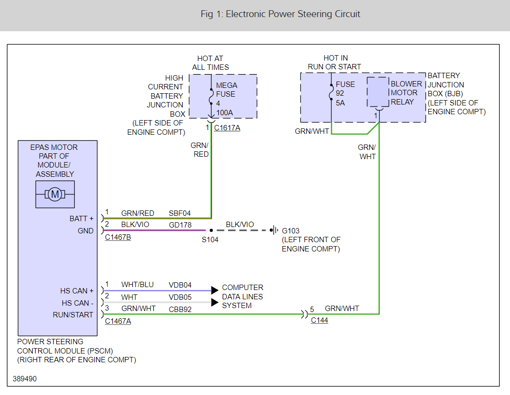

There is a mega fuse #4 100 amp that needs to be checked here is a guide to help you check it for power and the wiring diagrams so you can see how the steering works. If the steering is out it will pop the fuse causing the other issues.
Here is the fuse locations as well.
