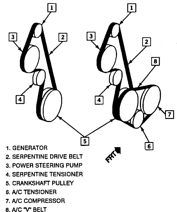

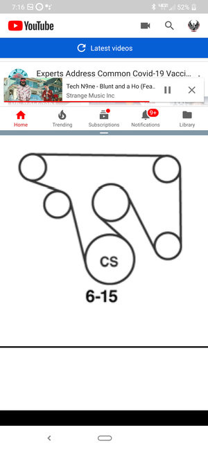

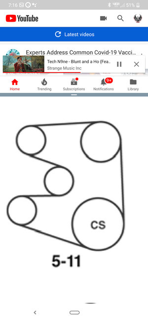

Start with the diagram on the left. The right one adds the A/C belt.
Mar 22, 2021 at 4:34 PM

Mar 22, 2021 at 4:39 PM
CHRIS DAKE
  • 27 POSTS
That route doesn't work. Belts are v belts.

Everything I can find shows two serpentine belts. Any chance the engine was transplanted from an earlier year? I looked as far back as an 1982 model, but they're all the same with serpentine belts. I did find some belt tension charts that refer to V-belts, but none of them include the routing diagrams.

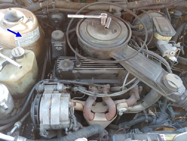

Also, please look at the emissions sticker on the right strut tower and see what they list as the engine's emissions year. That will say something to the effect of "Conforms to EPA standards for XXXX year. If this is the original engine, that will insure I'm looking for the right year.

Rock Auto indeed shows only generators with the V-belt groove like that in your photo. It occurred to me my online service manual probably doesn't show the routing diagrams because they are much simpler than those for serpentine belts. A V-belt has to make a square or triangle with rounded corners at the pulleys. Unlike serpentine belts, V-belts can't be backward to cause the wider flat backside to run on a pulley. Where serpentine belts do that, the pulley will be smooth and what it drives won't require a lot of torque. That's typical of a water pump or idler pulley. Generators and power steering pumps are very hard to turn, so they will always have ribbed pulleys and the ribbed side of the belt will match those grooves.
With V-belts, the tapered sides wedge into the sides of the pulleys to give them much higher gripping action. Those belts will never run the top or bottom around a pulley. V-belts can only bend one way; the way they go around a pulley when they fit into the groove. They'll never bend the other way.
The photos don't show the pulley for the power steering pump. Can I assume that uses a V-belt too?

Okay, thank you guys. Let me know about the salvage yard. And i have attached the emissions photo that you requested. Also there is no sticker anywhere that shows the routing.

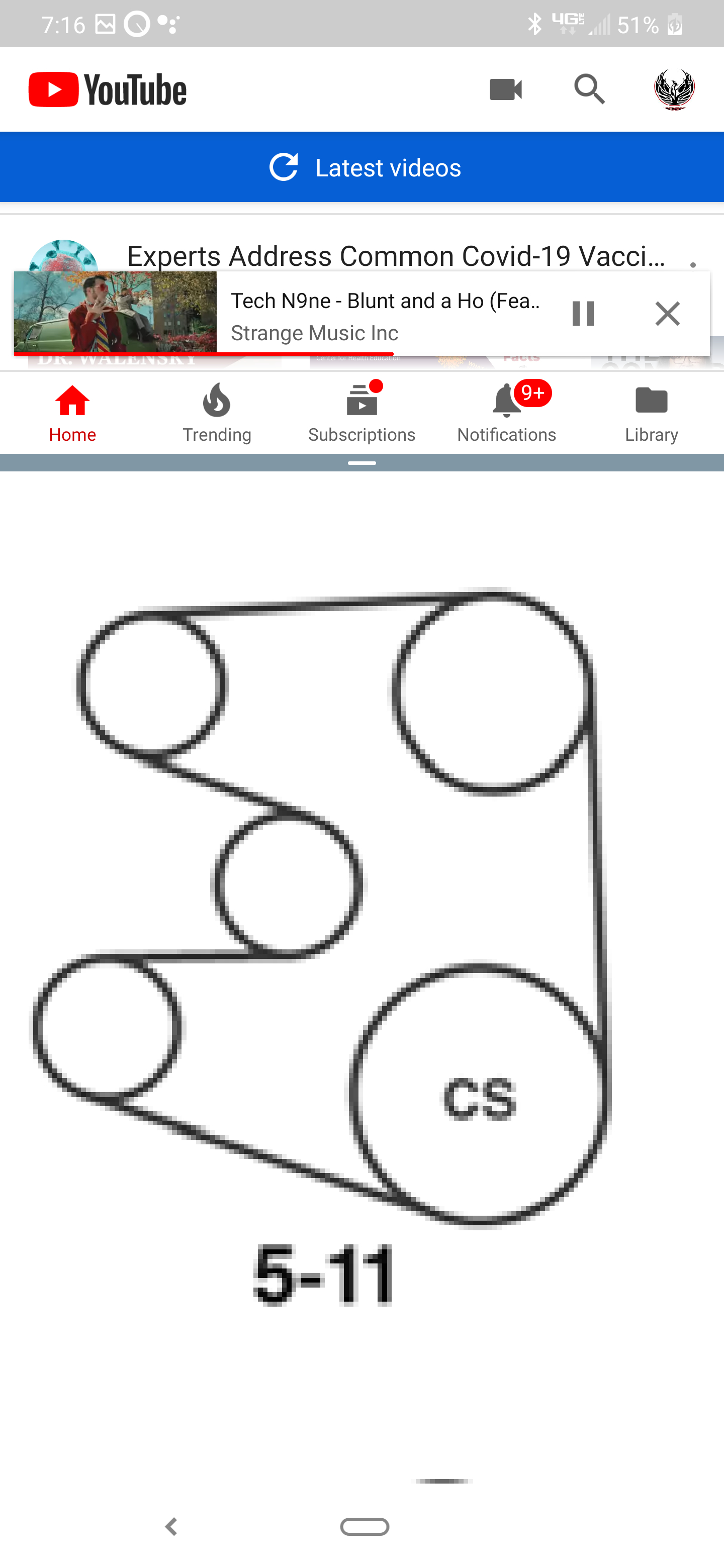

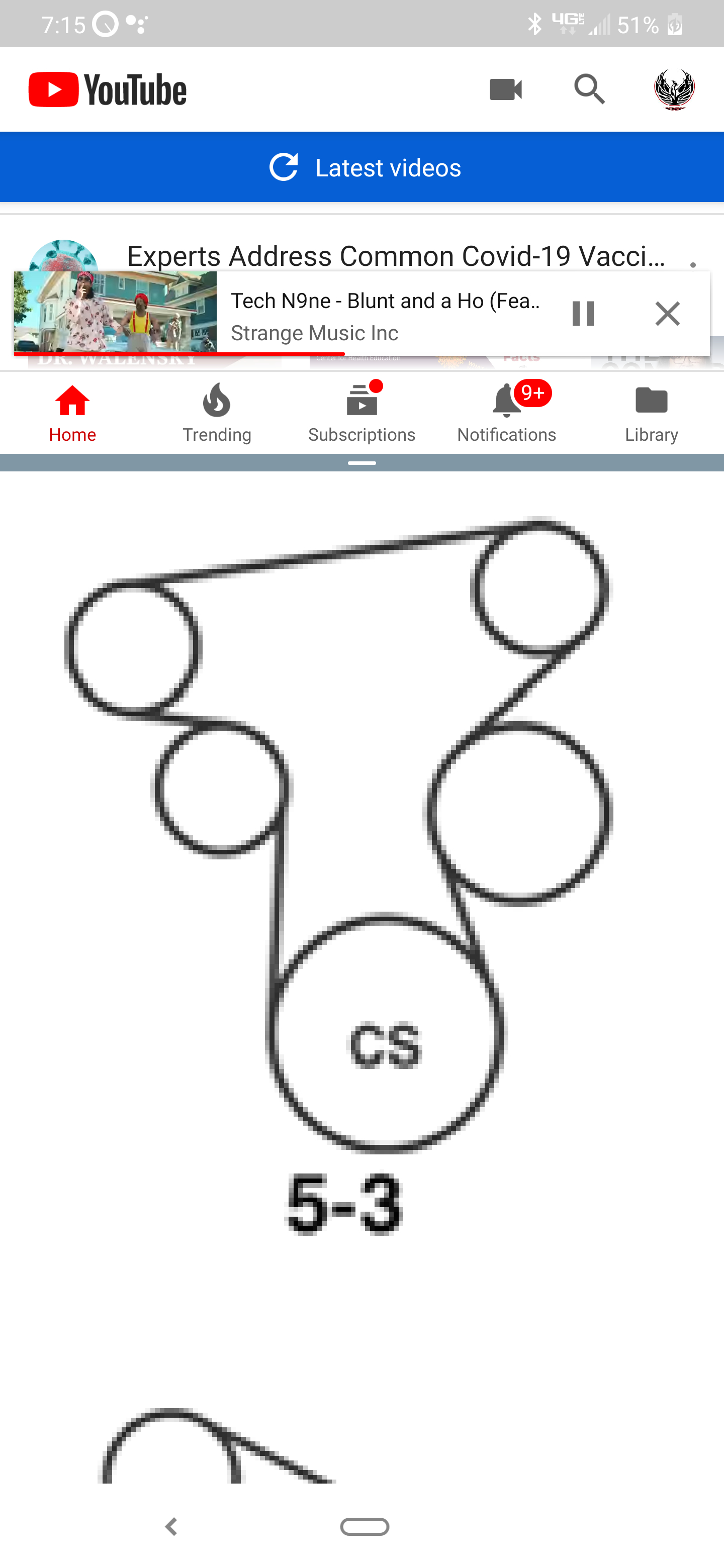

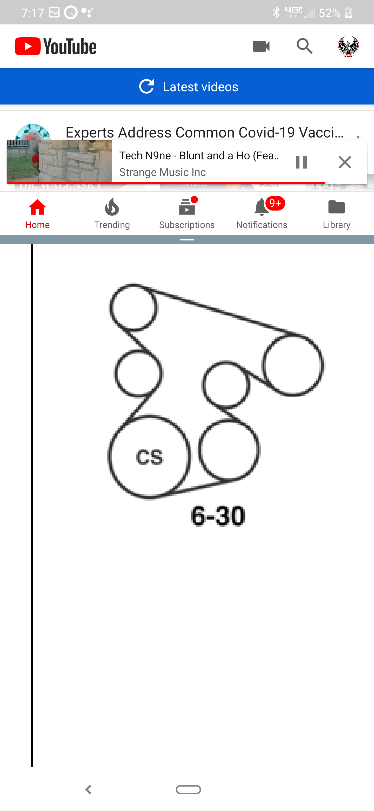

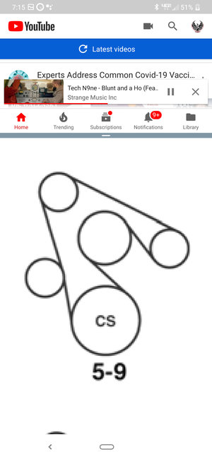

Mar 24, 2021 at 6:57 AM
CHRIS DAKE
  • 27 POSTS

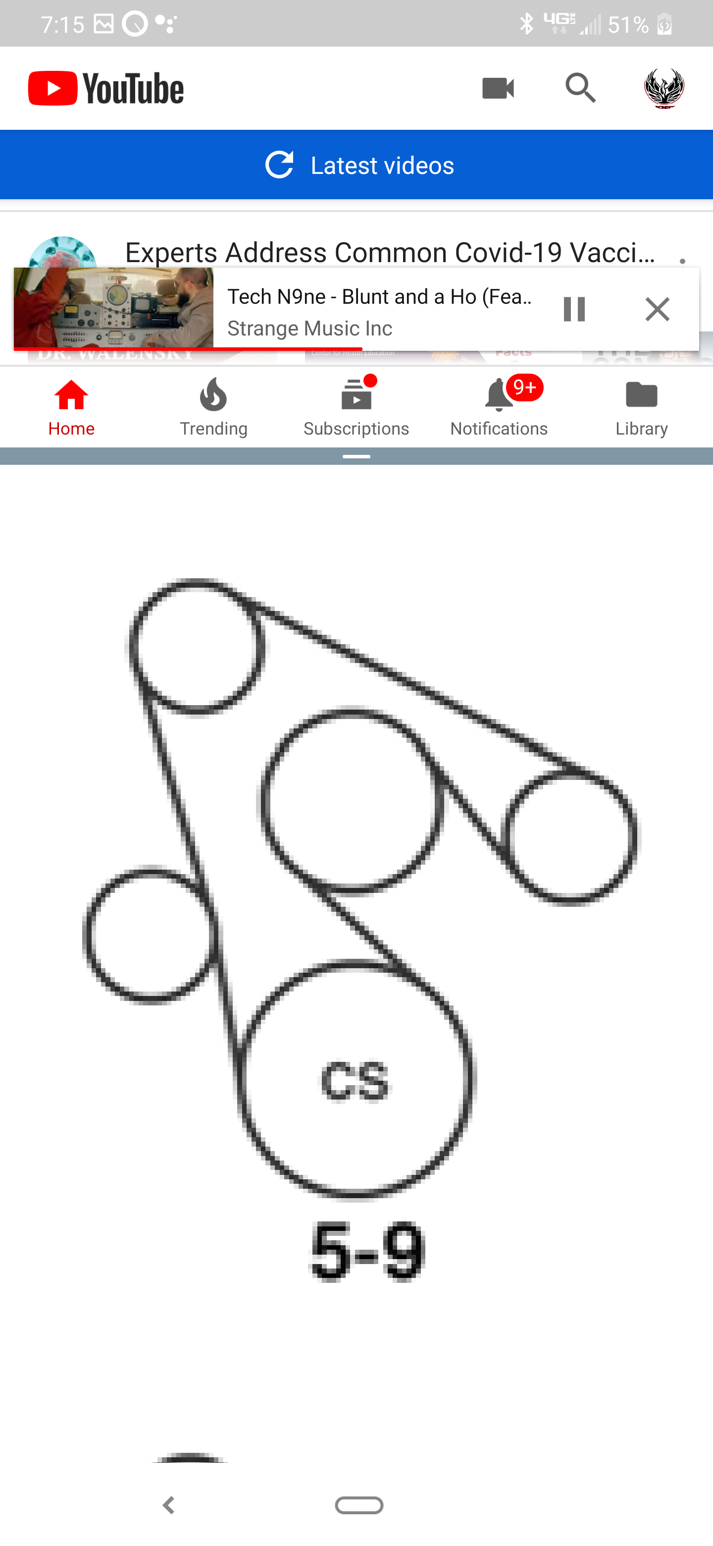

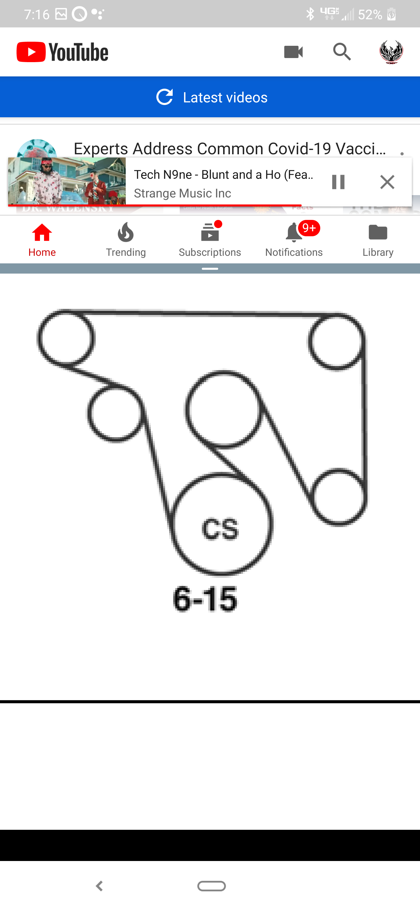

I found these possible routes but i when through every motor us made from 1970-2008 engine size 1.6-2.4.
Mar 24, 2021 at 7:24 AM

CARADIODOC
  • 34,306 POSTS
Those five diagrams you posted all have to be for serpentine belts because they run on the back side over some pulleys.

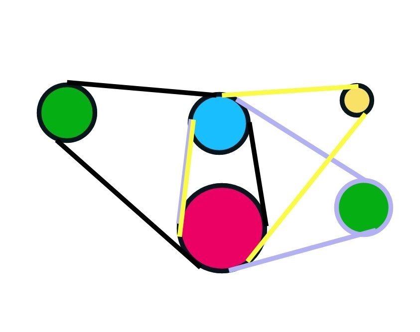

Thanks guys. I have drawn up I pic of the positions of the pulleys. Now there is no air pump just and idler. I will send one of you the VIN, engine stamp code. With the partial vin as well. I look up that the motor is an '83 2.0fi ohv in a 86 body with A/C 5 speed.

Routing should be similar to this. power steering on the upper left and alternator on upper right. The AC pump could be on either side depending on which compressor it has but I seem to recall those were in the front so that's lower right. If yours has the idler on the alternator belt, the belt goes over it. Is that any help? Been at least 20 years since I've seen one and I've slept some in that time.
