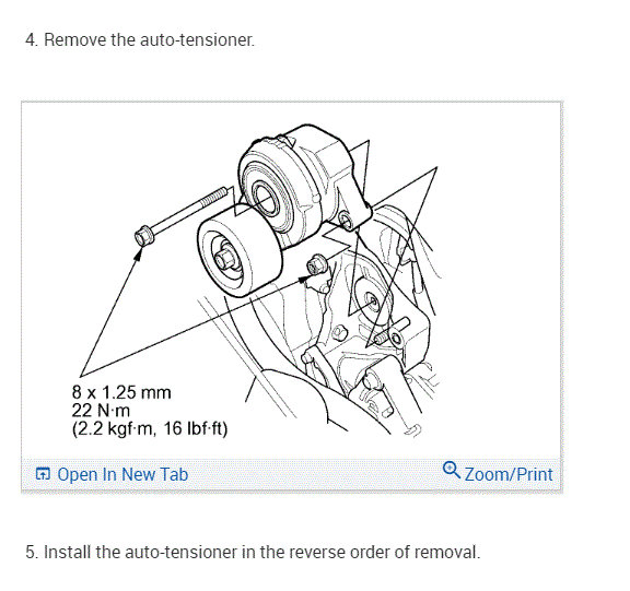

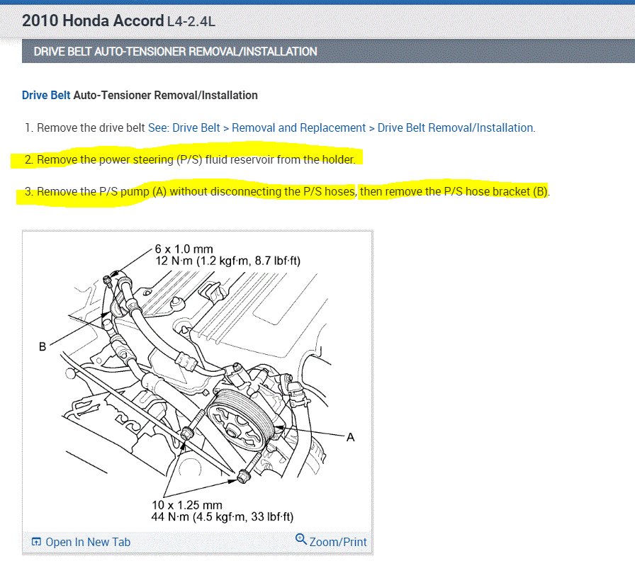

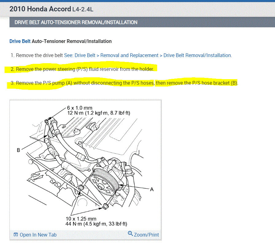

Hi can you tell me if the power steering pump needs to be removed to change the tensioner. If you have the service manual procedure print out for reference. It would be greatly appreciated. Thanks, Neil
Apr 24, 2022 at 6:41 PM
Yep, on this vehicle, the power steering pump does need to be removed in order to replace the belt tensioner.
If you look below, I provided the directions for the removal and installation of the tensioner. Take a look through them and let me know if you have questions or if there is anything I can do to help.
Take care and let me know if this helps.
See pics below.
